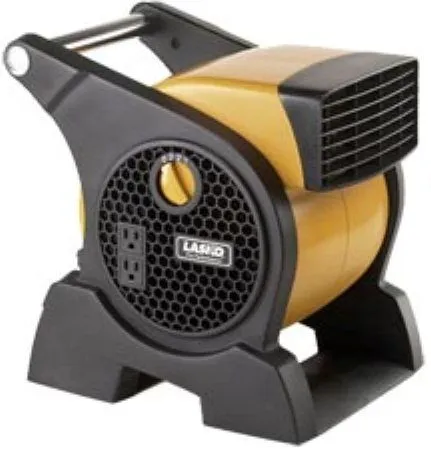

59.99 at Home Depot. If you think you really have to have something, then this is prolly the cheapest easiest route.
