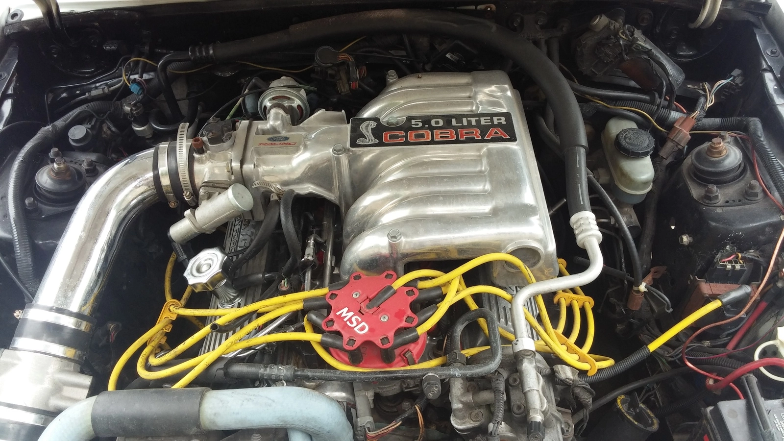

Hey fellow stang lovers I bring to you my quandary. I recently picked up a 90 mustang, it seems pretty quick(im used to driving a 03 fx4 f150) and runs well.. Several guys at work are talking trash they are chevy and mopar guys.. One has a stock 08 srt8 charger. The whole group is calling me out to race him, talking down on the Ford. I'm going to race him either way. My question is Do I Have A Chance at winning or will I just get blown out?
I have decent driving skills and the car was modified from previous owner with 10k miles on rebuild and 122xxx on the body. It has some parts that I wouldn't of necessarily put on but here is the list:
5.0l V8 rebuilt bored .030 over about 10k miles on rebuild.
Ford racing aluminum x302 heads with crane 1.7 roller rockers
E303 cam
Under drive pulleys.
Ford racing polished cobra upper lower intake
70 mm throttle body
73mm maf calibrated for the 30lb injectors.
30lb injectors. With walboro 255 high out put fuel pump adjustable fuel pressure reg.
Canton 7qt oil pan with high flow oil pump.
BBK shorty headers/BBk off road X pipe with duel flowmaster 50 series It is loud and the engine has that nice lopey idle .
Tremec T5 HD zspec 5 speed trans/with fresh stage 2 clutch. Hurst shifter.
3.55 rear gears.
Light weight aluminum drive shaft .
5 lug conversion with factory cobra 17x9 rims
cobra front brakes duel piston calipers
Full length weld sub frame connectors
BBK upper/lower rear control arms.
BBK lowering springs lowered 1.25"
Decent stock tires 17in cobra wheels, and It does have all black factory interior! (lol)
Can this set up win or will I just lose and have to deal with it? Maybe a close second even tho second is the first loser..
Let me know!

Also.. what do you all think Hp and 1/4 mile time would/should be with that set up.. Its not tuned yet.. Im going at the end of July to Lidio at Alternative(they real busy). I'm pretty sure his car is running 13.2 and thats with a professional driver.. so..
If you had a sticky tire and drove the day lights out of it you could beat him, but that's hoping he would be spinning. Most drivers cannot duplicate the times in magazine test articles without some real practice and experience.
Joe
Car And Driver did a comparo against the 08 GT 500 back in the day. Their best drivers could only manage a very low 13 out of the heavy Dodge.
http://mustangs.about.com/od/modelyearprofiles/a/gt500vschallngr_3.htm
The Challenger will have T/C, and you will have tire spin. Unless you are VERY experienced in keeping that in ck, your race will be lost in the first 60'.
(And I do so hate to lose watching the tail lights of my opponent the entire 1/4 mile.)
Now like Joe says, get it at a track and show up w/ experience, and a set of ET streets, drive the hell out of it, and you may have a prayer.
Unless you have a seriously narrow set of drag radials, i'd say you are unlikely to win.
I wouldn't worry about tuning, but i would back the injectors down to 24's and use a pro m meter. Could make a major difference.
Then with some real tires you should win. You probably have a 1000lb advantage, but you will need traction. Some nittos or BFG drag radials on your current wheels should do.
People underestimate x heads, while not the norm for everyone i did know someone with a car that went 11.98 on a stock shortblock with an E cam, gt40 tubular, x heads (valve jobbed), pro m bullet with 24's.
you are going to have to cut a great 60ft. remove all unecessary weight. only have 1/4 tank of gas. Buy a shorter belt for the track and bypass the a/c and smog pump. Ice down the intake. Bump the timing to 14 to 16. Put a splash of 106 in it. Disconnect one side of the front sway bar link. pump up the front tires to 40 and lower the rears- if street tires to 28. Get a set of DR if possible If on street tires just clean them off dont do a big burnout and don't launch at 4000 or youwill spin the first 60. You will probably go through the traps in 4th.
Last drive it like you stole it. It's all about the driver
oh.. and get rid of those crappy ignition wires and get a set ot Taylors.
Havig driven a SRT8 charger, you'r only chance is from a dead stop. They are heavy and take a few seconds to get moving, but once they do they are hauling butt.
I'd have to say that you will see SRT8 taillights....at the track of course

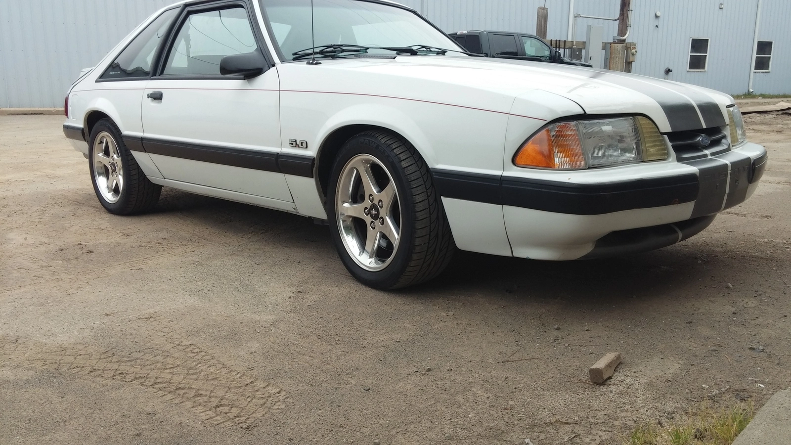

But nice car. Those rims with the pony caps came on the 03-04 GT's as an option. Same as the 01 Cobra
