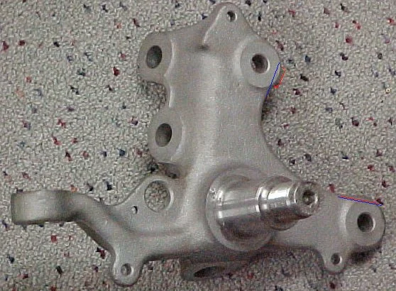

I've found pictures of the SN95 spindle. Can anyone post a picture of a Fox spindle for comparison?
I see you have "Saleen stuff" Is it possible you have the Saleen all disc setup? It is the same disc setup on the SVO and the Mark VII cars, mounted on the stock Fox spindles. And like was stated, the EASIEST way to tell for sure what setup you have is to take the front wheel off and try to wiggle the rotor. The rotor should move some on the wheel studs. The SN95 fronts have a separate hub with the studs attached, that is mounted to the spindle with a center nut, and then the rotor slips on the hub - the lug nuts are NOT part of the rotor. The Saleen/SVO/ Mark VII setup has the studs mounted in the rotor and the rotor can not be wiggled on the spindle since it is bolted directly to the spindle. Another note is the SN95 spindles have short plastic dust caps on the hubs, while all the Fox ones I've seen have taller metal dust caps.
