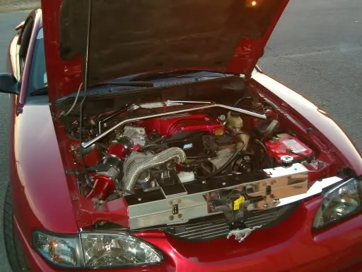

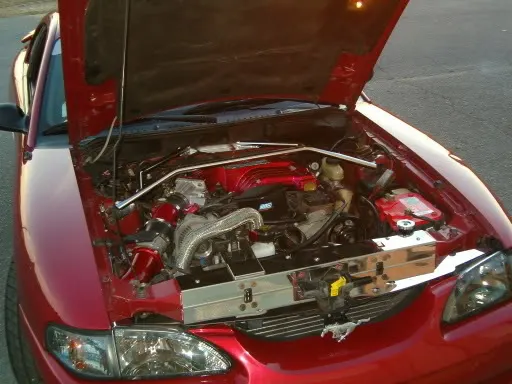

here are some pics to illustrate
Aaron's car:
My car:
See how the poles that come down to the side of the battery are in the middle on his, but on the sides on mine?
kept the same battery box, but made a little bracket that bolts in place of the factory hold down, because the Optima was not as wide as the stock battery. You can see it in the pic of my bay, little black bracket at the base of the battery.

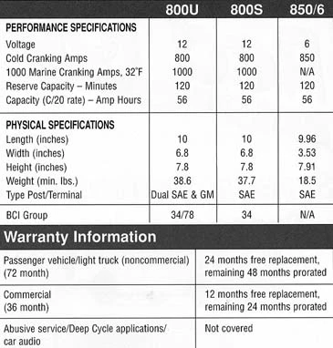

So which model has more cranking amps then, mine or Aaron's?
Oh ok cause I order a polished hold down made by GCR specifically for Optimum in stangs.
Not sure sorry
