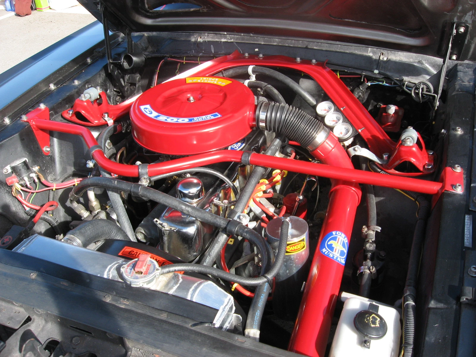

WORTH, there is no doubt the Duraspark is a better overall system, but in street driving it DOES NOT ignite the fuel-air mix better than a set of properly adjusted points. Adjusting points every week is okay but unnecessary. I checked mine about once a month (1,000 miles) and adjusted them probably once every 3 to 4 months. During the points era, cars that were sitting beside the road were usually there due to tires, gas or transmission. Seldom were they an ignition problem. Even bad points will allow a car to limp home or to a gas station. When I am in a 50 plus year old car 2 to 3 thousand miles from home, I want to be sure I can fix it myself and not blow $$$ on a mechanic. There are advantages to computer triggered ignitions, but they are mostly for people who never adjust anything, plus they work in all conditions (bad fuel, high altitude, under heavy load, etc.), where points need adjustment for optimum operation. The computer adjusts automatically. Having spent 20 years working on electronics as my job while building/driving Hot Rods as a hobby, I totally understand the love of electronics and computers. At street speeds the advantage is minimal...if at all. Fuel Injection is better than a carb. but again, at street speeds using annular-atomization (Autolite 2100 carb) works "almost" as well. A simpler system with fewer components and much less wire and worries, gives me piece-of-mind. I still have a flip-phone, love my HI-DEF 50" TV, am writing this on my HP computer, and do not hate computers. However, in a car ignition they are not necessary on a carburetor motor. My auto-overdrive will have a manually engaged lock-up torque converter without any need for a computer. Finally, I am not knocking modern ignitions when used for their designed purpose...I simply prefer what I know I can fix, even if at 2 AM in Nowhere USA. The 200 SIX in my 65 has Pertronix but points are in the trunk...just in case.

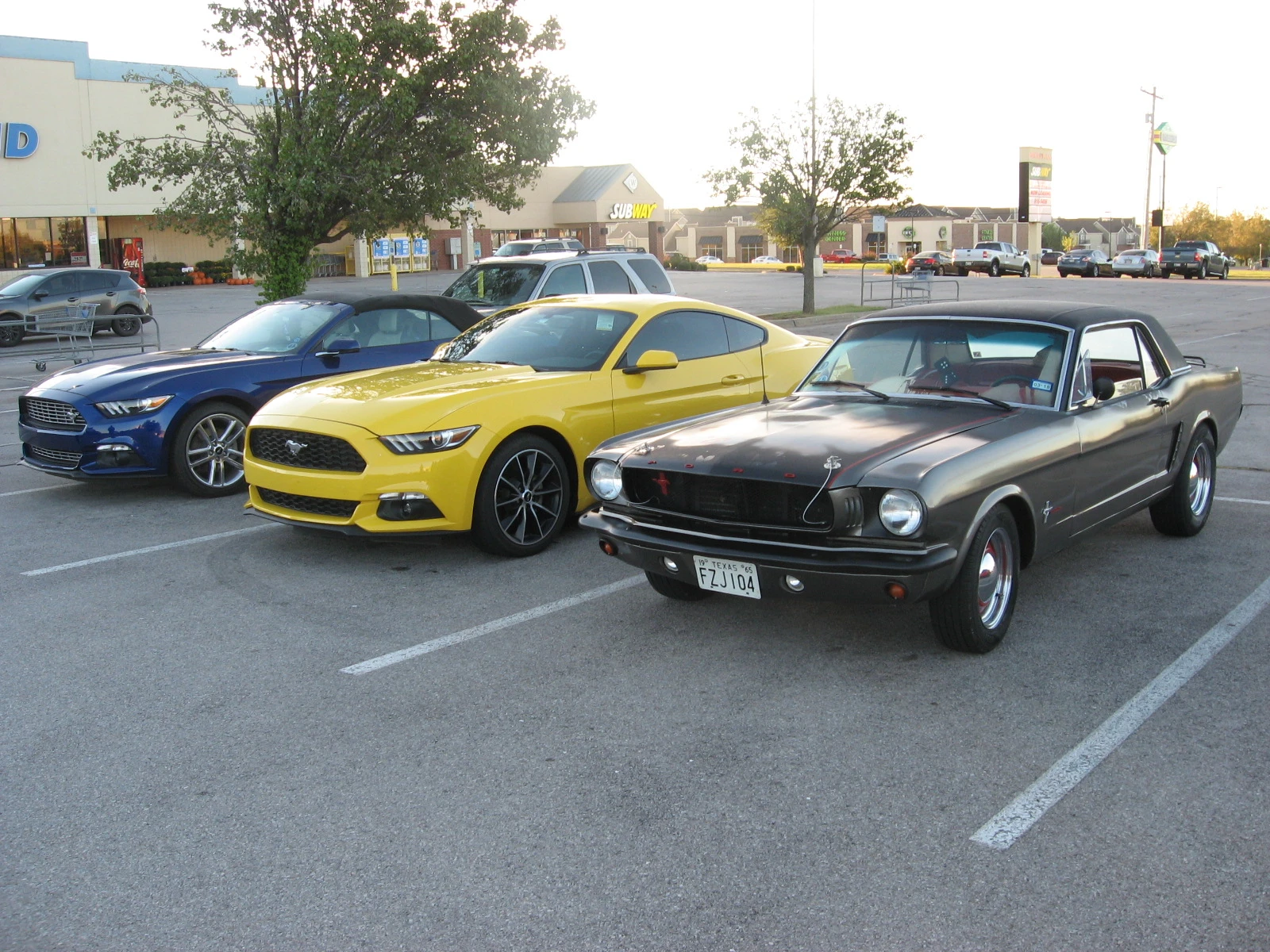

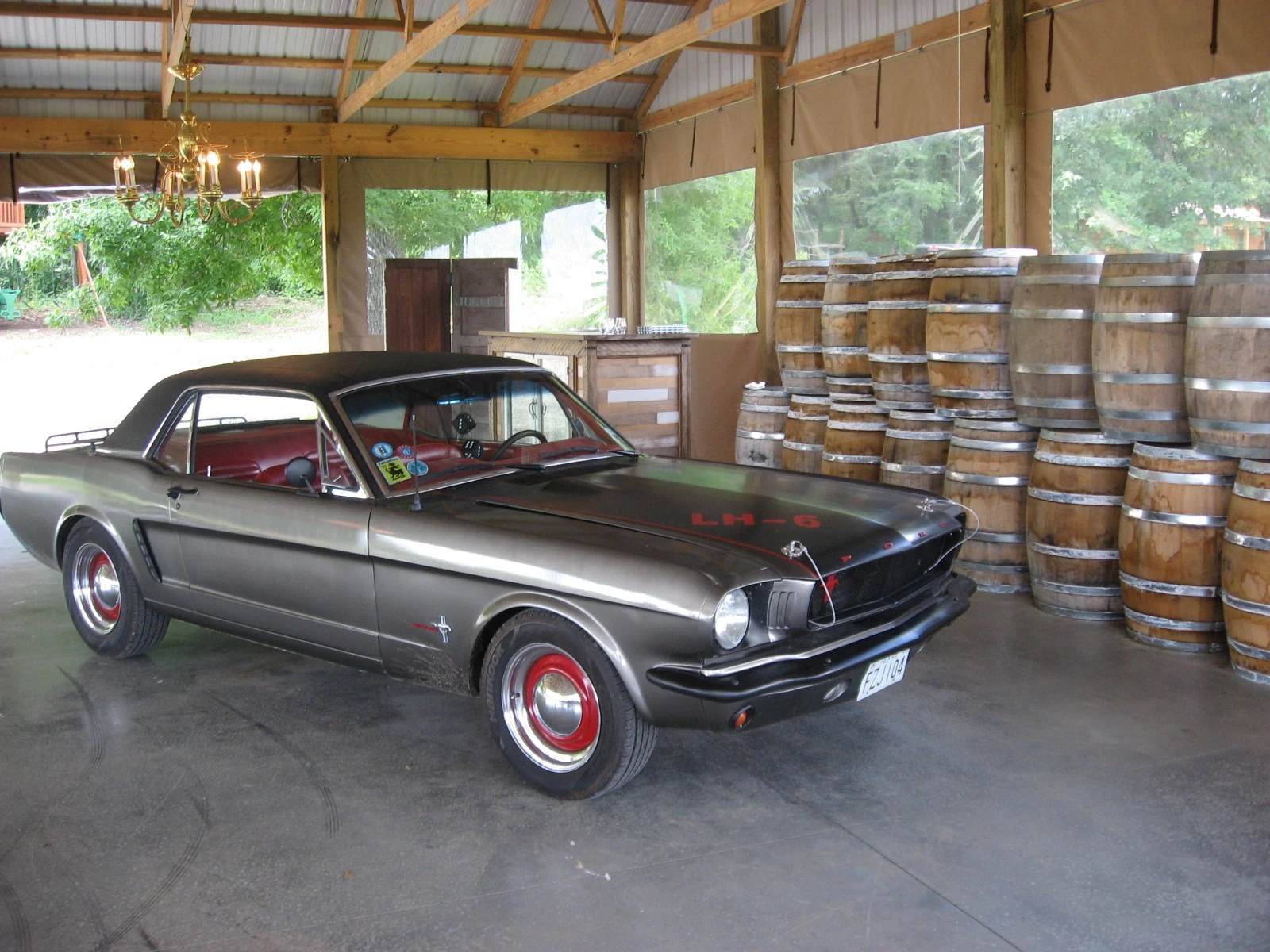

WORTH, I understand what you meant, but I have been shocked at how little most "car guys" know about ignitions. MY reply was targeted more at them than your post...though I should have said that. I run Pertronix in my 65 Mustang but originally set it up for points...which I keep in the trunk, just in case. As the Go-To guy for the Mustang 6 Association questions on-line, I learned more about modern ignitions just to keep up with today's younger guys. After much research, I learned points are not the "Bad old system" many car guys think they are. A good hot spark up to about 4,500-5,000 rpm can be produced, no computer sensors needed, NO DIFFERENCE in the "feel" of the engine points or electronic system, simple and effective if a carburetor is used, and heat is of little concern. Basic answer to Points-Electronic ignitions questions...Points just as good as Electronics if properly set-up, in a carbed motor intended for below 5,000 rpm street use. Fuel Injection or racing...get the hottest longest spark you can get, and it will most likely not be points.

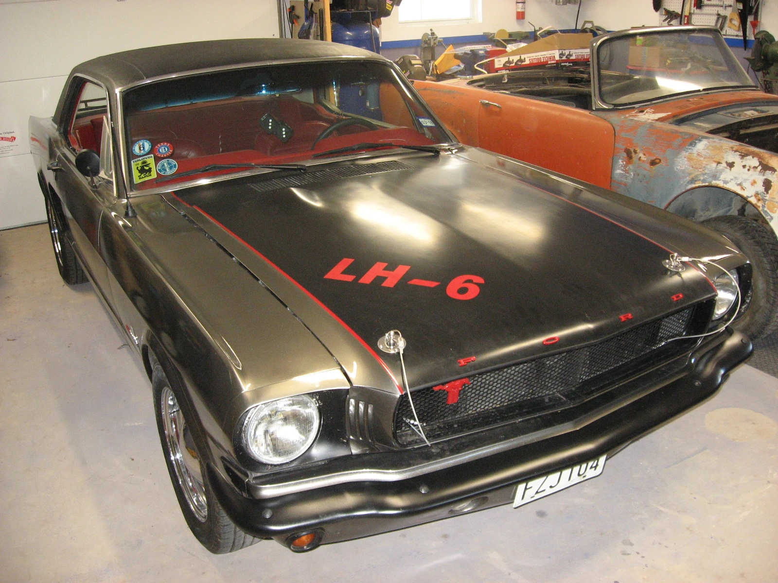

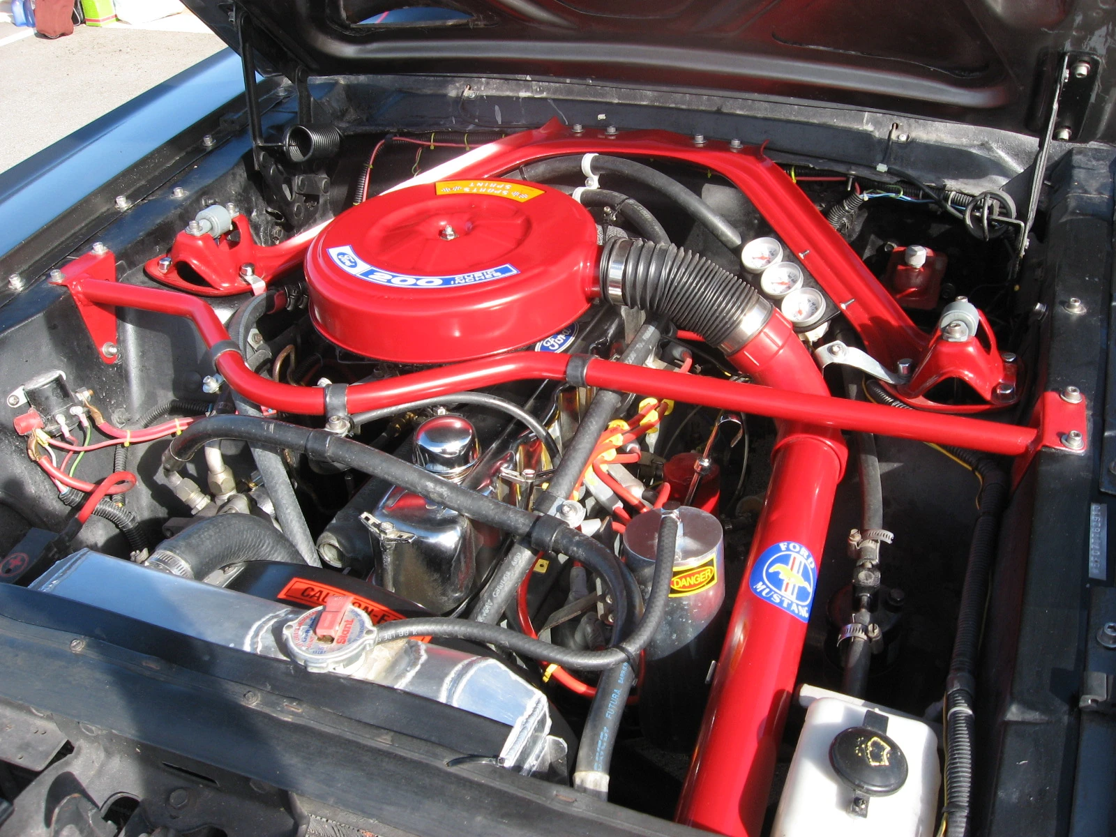

When speaking about bigger spark, one needs to understand I do have a hotter than stock spark with my points setup. If your ignition resistor is say 1.5 ohms measured with a multi-meter, change it to a 1.2 or 1.3 ohm resistor. That little difference will increase the voltage to the primary side of the coil, which increases the output, but will not hurt the points. Okay, you may need to replace points at 12,000 rather than 15,000 miles...Big Deal! Add a better coil, say ACCEL 42000 volts street coil, use the best available (BWD Select) points, condenser, rotor and cap, then get the best (lowest resistance per foot plug wires) and use the best platinum plugs gapped a few thousands more open...and hello bigger spark! More power? Maybe, but probably not something you can seat-of-the-pants feel. Better starting...yes. Better MPG...yes. Cleaner running engine...yes. ALL with updated points. I used points ignitions for 50 years using these slightly hotter spark ignition ideas, and it works. Remember, you need oxygen to burn fuel, so a good, even home-made cool-air intake helps. Increase spark, blend in cooler more dense air, time everything properly, make the fuel as gaseous as possible (Autolite 2100/4100 carbs with annular atomization or newer Holly) and unless you expect to go racing, you are good to about 5,500 to 6,000 RPM. The pix's are my 65 Mustang 6-cylinder in Oklahoma, Tennessee, and my shop in Texas. It is a driver and the LH-6 on the hood stands for Long Haul 6 cylinder. Running the AC and getting 25 mpg on the highway without overdrive. A fun six-banger!

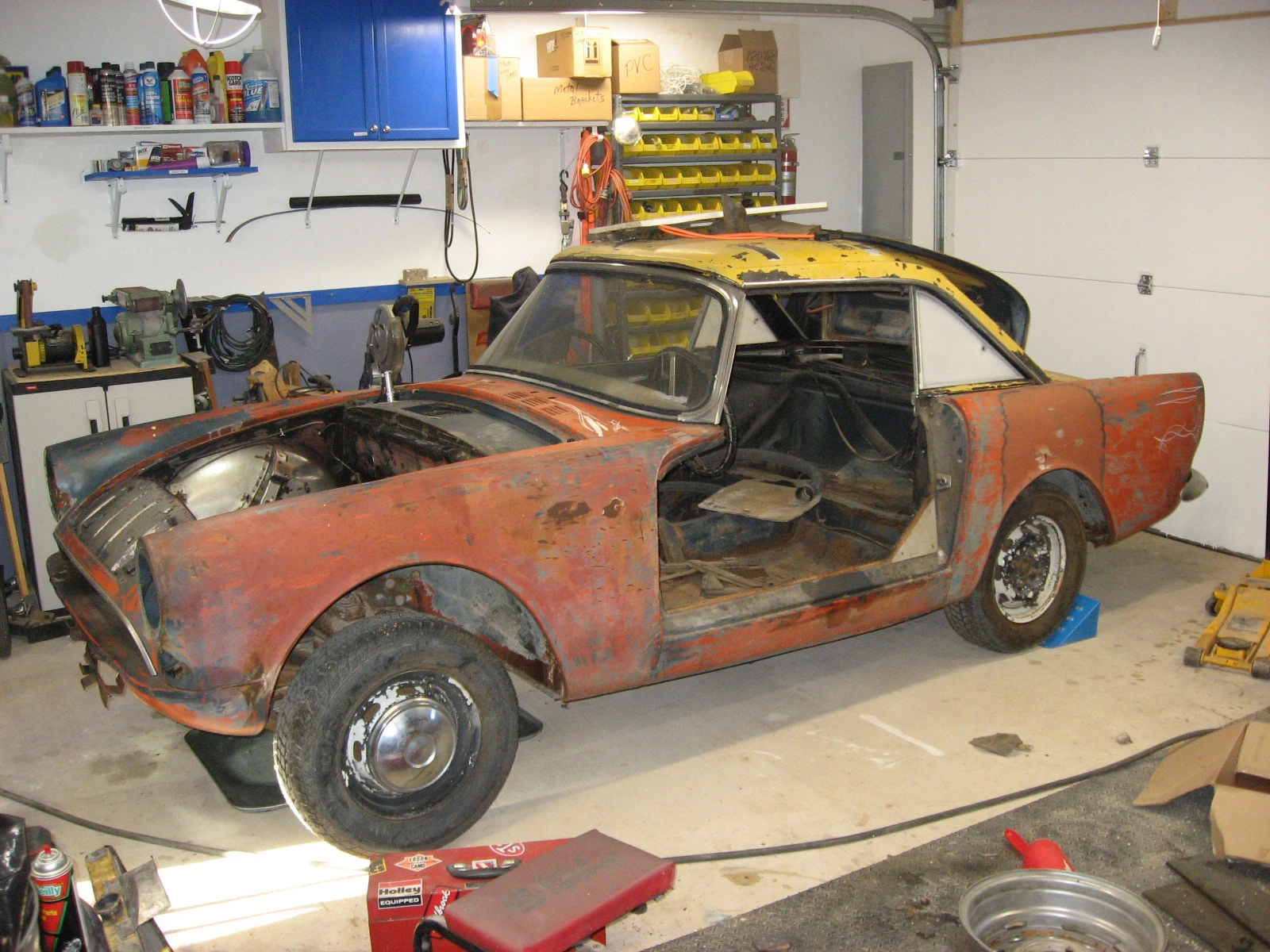

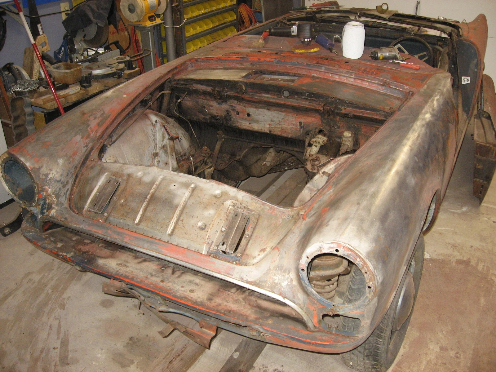

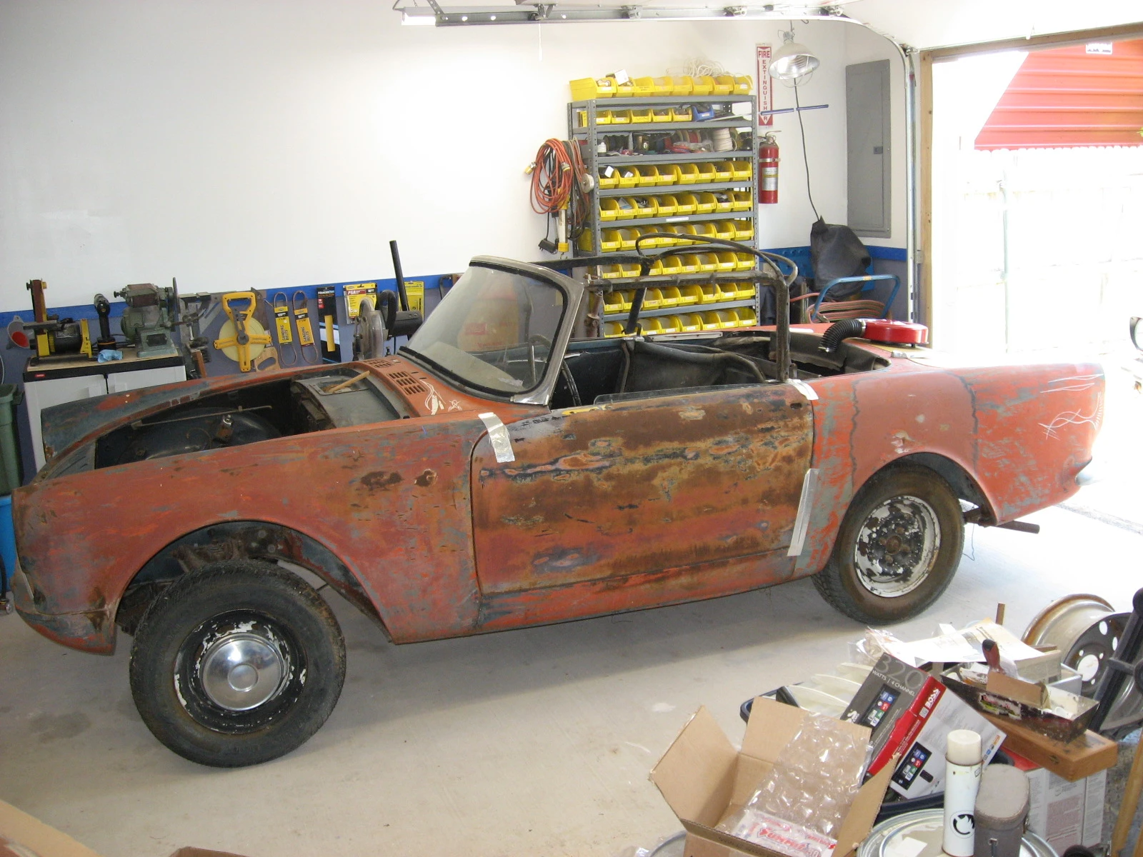

Zookeeper, the little car is a 1967 Sunbeam Alpine. I have 2 to make one. This will sound weird, but rather than a Ford V8 like the Tiger had, I am retro-fitting a 2.3 out of a 1985 Mustang with an A4LD overdrive tranny behind it. Hoping for about 150 HP and mid 30's mpg AND NO COMPUTERS! I have nothing against computers except in older cars with mechanical drive-lines. They are necessary in today's cars to control ignition timing, fuel-injectors and transmission shifting and converter lockup, but older cars do not need them. My converter will be locked to the flexplate manually when in overdrive, and my dizzy will be a home-built points unit re-curved for my use. I am also a federally licensed gunsmith and guns are much older than cars, yet they are still basically the same as in the 19th century. Newer ideas sometimes are better but in very specific instances. With mechanical advance timing tuned properly, and a hotter spark from a points system, plus a well tuned carb, I think I can do what I am hoping for without computers or Fuel Injection. A .75 overdrive, 2" taller tires, the engine tuned for the 2500 - 3500 max torque range, and my thinking looks good...on paper. The Mustang 6 got 24.5 running the AC all the way on a 2,275 mile trip this last summer, and that was with the cool-air intake disconnected. Twenty-five mpg is normal on trips with it connected. If I can find pictures I'll post later.

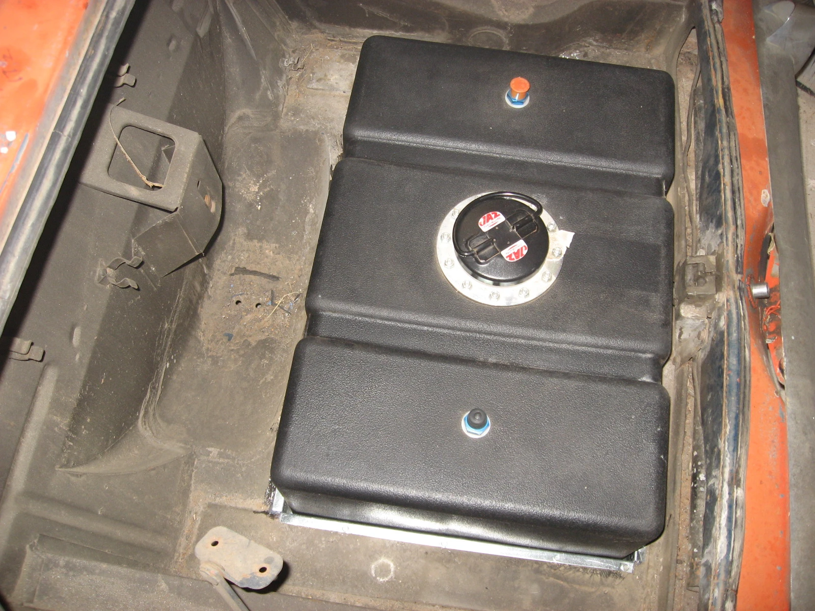

I hope this works. The removable hardtop will probably have a 3rd taillight installed for safety. It also has a soft-top that will be tan. The 16 gallon fuel-cell is recessed 3" into the trunk floor, and I am building a "tilt" to flip the car on its side for under-body work. All new fuel lines, brake lines, rear wiring, undercoating and fix any holes before undercoating. This will be a driver for serious trips. It is probably a 2 year project and at 75, I must work a lot...but it keeps me active and out of the old-folks home! With luck I'll drive it into my 80's then give it to my grandson. Plans are: chrome yellow with tan interior, minor body mods, total suspension rebuild, the Ford 2.3 with overdrive, 14" custom wheels, nice sound system with upgrades to cut down on road noise, and a USB input port to play my own music. Listening to "Southbound" and Dicky Betts playing guitar, while zipping down the interstate in a car you built from the ground up, is about as good as it gets! OKAY, there is that OTHER THING...but I am 75 years old guys and been married to the same lady for over 52 years...I hope to live to see 76!!
