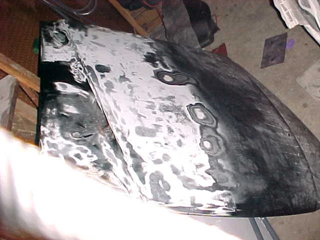

high volume low pressure, with regular guns you get a lot of overspray becaue the gun is shooting out paint so fast. That is a good idea about getting something to practice on, i practiced on my hood first, take a look at some of my pics. my hood was my practice piece, but what ever you practice on, make sure it sits up straight, because if its on an angle, the paint will run.
