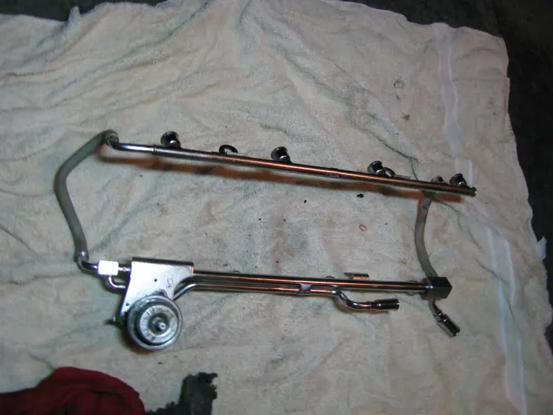

Soooo....WTF is the point?
I do have a fuel regulator....and as it sits before I focked with it...it was wide open.
You need a pressure gauge and need to set it to the correct PSI.

Is that regulator really a stocker?
FOCK!

DocG2828 said:
I think maybe i've had too much brew to comprehend.
FOCK!
I see no adjustment screw on it

it may be a holley. They look like stock and the adjuster is where the vac line goes.
it would be red then, and still junk. had one on mine for all of five minutes before i noticed it squirting fuel out of the adjustment screw and into the vac line. this after having a holley tb that stuck wide open. no more holley crap for me.
FOCK!
This is what I'm used to looking at..

Hmmmm.....well it would be a good time to swap a new one I guess. I'll have to look again but I swear it adjusted.
Maybe it does. Where does it adjust? And if you do swap it out, you can't go worng with a Kirban like I have.
