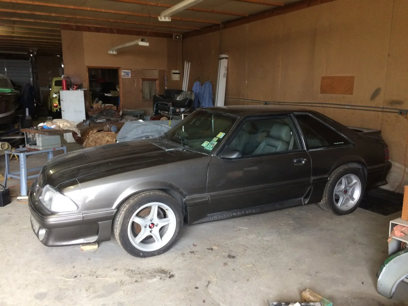

you can keep it in this post and the members following know what they are dealing with, year, model, engine size that kind of stuff.
post up some pics of the stang too, sorta like a repair thread documenting what you've done.
I have already started a new post. Will try. To attach a pic
