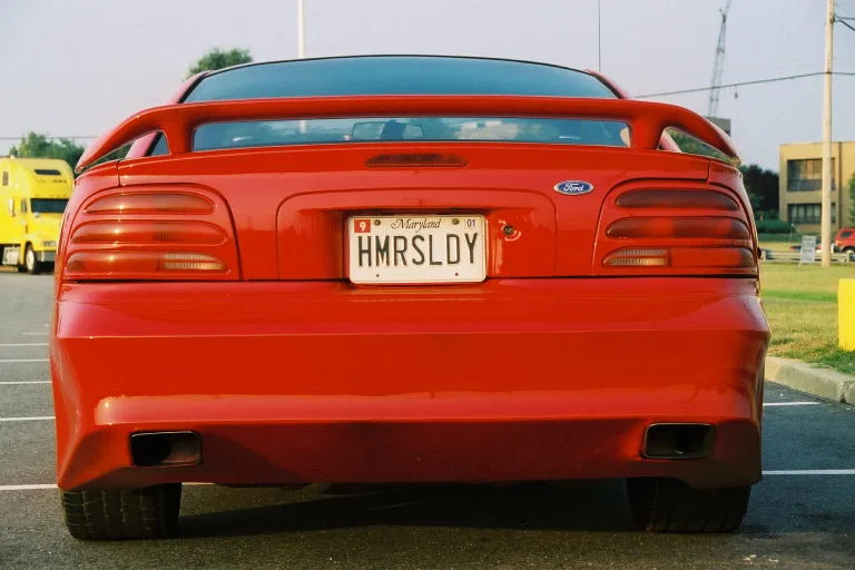

I've got one. Quality is first rate (from what my body guy says), and installation was a breeze, excluding the exhaust tips. Definitly more/better support than on the front bumper. Rear has 5 bolts accross the top/middle and 3 screws each side in the wheel wells. PM me for some pics that are too large for me to post here....

91BlckGT said:
I've had one for about 5 years now. Never had a problem with it.
Be careful installing it though. You only get one shot with that double stick tape. Note that I had to put an LX bumper on in order for this to work.
That's exactly what I wanted to do but I didn't know if it came with the whole bumper or just the peice to put on an LX bumper. you just answered my question. I too want to have the pipes coming out the back. Did you get those from an LX too or you brought a kit?
i got the cobra rear for my 93 gt cause i want to put lx style tips on it., but haven't put it on yet. but its made out of urethane now unlike the older ones which where fiberglass i believe, either that or a different formula.
I had Flowmaster 2.5" polished LX tailpipes on the car before I put the Cobra bumper on. To install the bumper, I had to disconnect the tailpipe hangers and let them drop down some. They were not straight in the bumper's cutouts, but it allowed me to install the bumper.
I went to my buddy's muffler shop later to get them straightened out and no matter how hard we tried, they would not get straight in the cutouts without the tailpipes hitting somewhere else.
I eventually removed and sold the LX tails and used a set of 2.5" Flowmaster GT tailpipes I already had. I bought some 22" x 3.5" polished stainless tips from Ebay and cut the GT tailpipes and welded the new tips on. Ths allowed me to put the tips centered in the cutouts and to have the tips positioned exactly how I wanted them.
I know other people have had good luck with getting LX tailpipes to fit with the Cobra bumper, but I did not. I like the setup I have now, so it all worked out.
