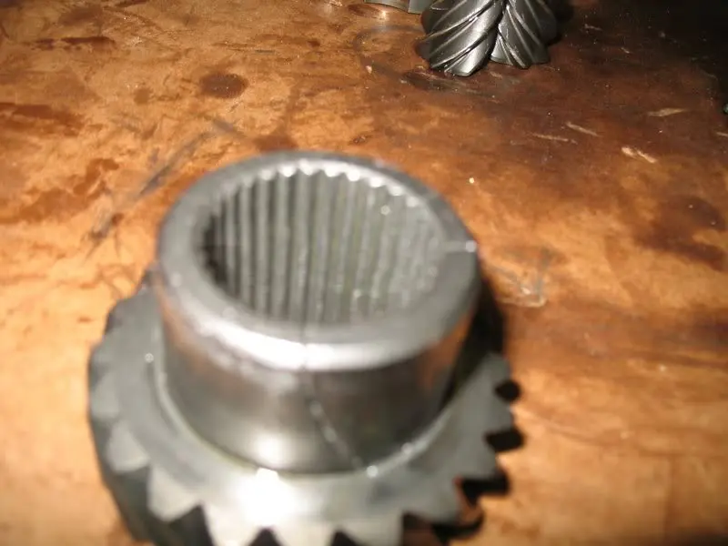

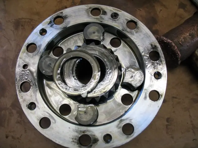

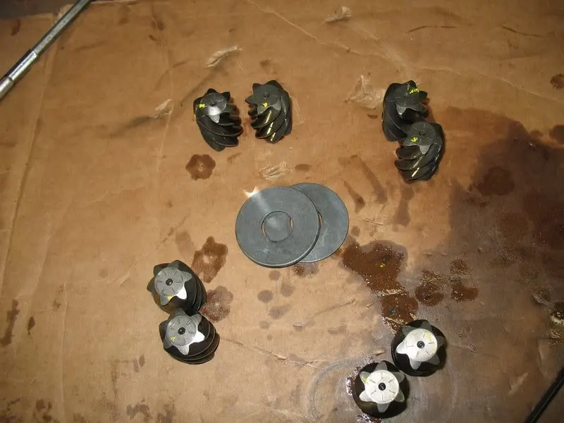

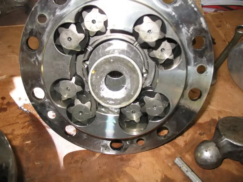

I had a Truetrac for awhile. It worked well on the street and OK at the track. I found that it wanted to push the rear of the car towards the right, which I found odd but was correctable with a Caltrac adjustment. It held up for 150 passes or so before it gave up the ghost--I was running Drag slicks so I added to its demise.
After teardown I discovered that there are no parts available to service the Truetrac and that it was supposed to be repaired only through a total replacement. Since I preferred drag over street driving I swapped in a full spool which does a better job of sending me straight down the track.

Here a few pics of what one looks like inside:
One of the parts that was broke:
That was the point I was trying to get across with my earlier comment about trutracs....in the end they die if you put a good tire on the car
Thanks for the pics :nice:
