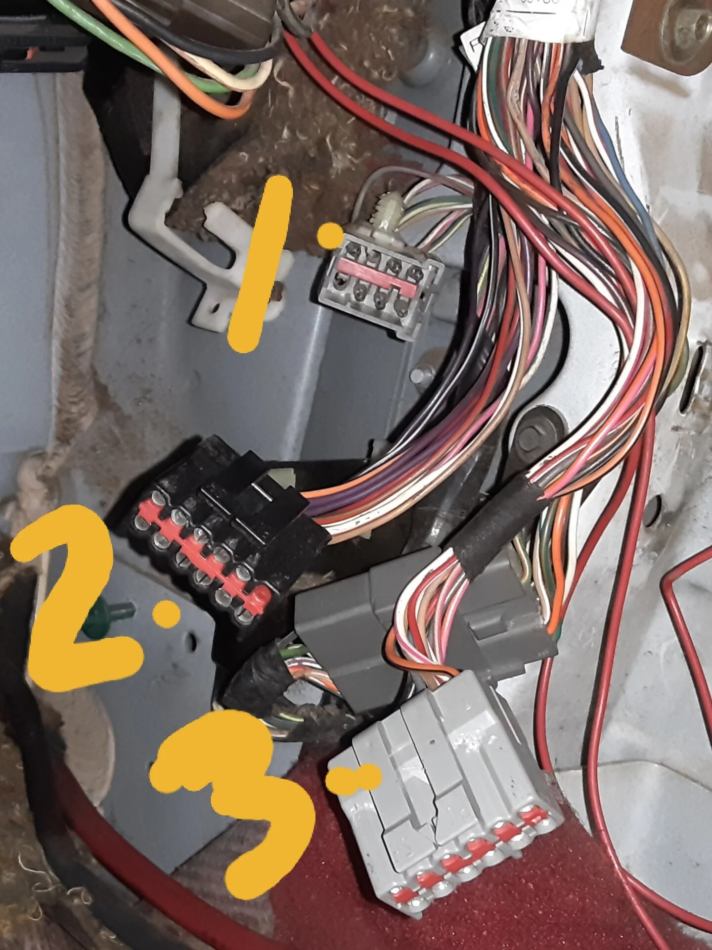

That would be absolutely great . Those things can be pricey even for a used condition . It's bad enough that a used A9L e.c.u. ran me $200 .
\/ I'm glad i looked to make sure about those 3 main connectors .
If you really don't mind l, i could sure benefit and be real grateful for that engine-to-dash harness and i could send you a paypal donation for shipping and time . I'll have to message you .

Absolutely correct! But OP was asking about the dash harness, and not the engine harness.
The dash/ECU-to-engine harness.
