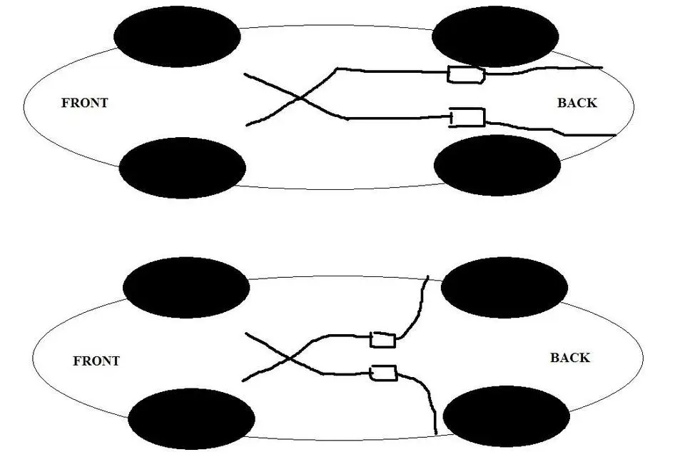

If I move my mufflers closer to the crossover, will it change the sound? I'm thinking about routing my pipes to fashion a side exhaust setup, but don't want too many bends, nor do I want to change my mufflers. So I was thinking if I move the mufflers closer to the front of the car, I can get a pipe with a 45* bend to achieve the look I'm aiming for.

That wont work, or will be very hard to work. Basically the Muffler will need to be integrated with the x-pipe if you want to try that. And yes, location of muffler does affect sound. The more piping after the muffler, the mellower the tone gets, as opposed to a muffler thats dumped/turndowns right after.
You will probably have to find a muffler with a inlet and outlet on the same side. Your options are limited. Magnaflow has one, Spintech has one, and thats all i know. Roush uses magnaflow if i remember, and they sound like garbage IMO. I used the Spintech 333scs, its 2.5" in/out and was 140 for the pair. Some say these types of muffler lose power, but i think the coolness factor of side exhaust and the exhaust note makes up for the loss of maybe 3hp/3tq and is still better than the stock mufflers.
If youre going with the roush kit with the side exhaust, you have to go with genuine roush tips. Nobody makes them or anything like them, they are Cast Aluminum btw, you cant just weld them on. We basically took a 4" long piece of 2.25" Outside Diameter pipe, stuck it on the expander, and expanded the pipe until the pipe was snug inside the tip(2.5" Inside Diameter), tacked the pipe and tip together, then welded the unit to the exhaust. unless you just want to use a screw like roush does and wonder where your tips fell off at a week later.

I was thinking if I move the muffler closer to the crossover, I won't have to get the nasty sounding mufflers with the inlet and outlet on the same side.

what ur asking has been done by few people over at the fnsweet.com. and done fairly eaily. Just need someone to bend up few pipes for ya, and weld up new mufflers. It will not have pretty shinny muffler visible from rear like that with stock set up, however, unless you manage to find someone with mandrel bender and tig welder with various muffler shop equipment
It will actually not change sound much. Infact, makes it sound hell of alot better then genuine Roushset up - Just look all of those nasty bend stock roush exhaust on diagram above. U can imagine how much restriction there is on those set up

Probrem i see with moving muffler up more is that unless you use something really small, i think u'll run in to issues with ground crealance. like pic below. u can see that you only have about 3" at most

Moving the mufflers closer to the engine will increase the "raspiness" of the exhaust,farther back will give you more of a "smooth roar". People think the short pipes make it louder but it's dumping them under the car that makes it louder. Even quiet mufflers with dumps are loud because of the resonance.
