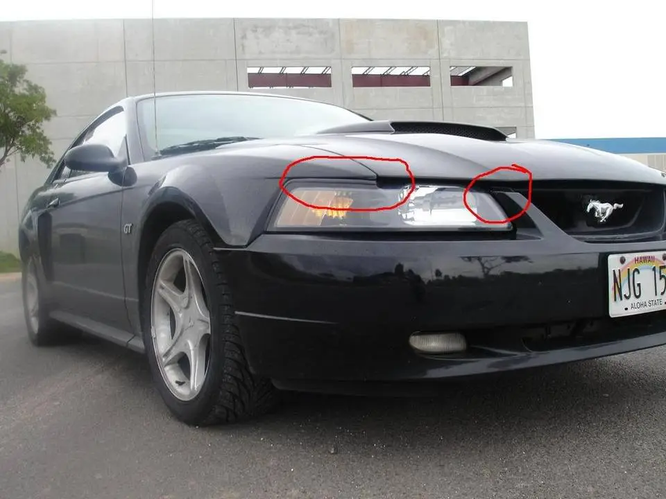

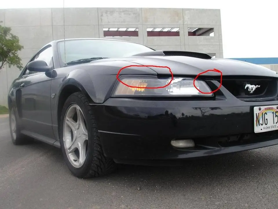

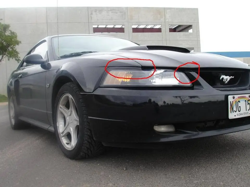

is yours like that?
Stang|ess said:
is yours like that?
Yes.
It's EXACTLY just like that at the corner of the front fender on the passenger side just like in the picture above!
The black rubber gasket seal on the headlight unit on the passenger side headlight is almost touching the tip if the front fender, but not quite and the size of the gap at that particular location is almost the same size opening like the one in the picture above.
And the other gap on the driver's side is located in a small area on the fender just above where the amber colored lens on the headlight unit begins that's located next to the clear part of the headlight lens.
I would like to know WHAT causes this and HOW the gap was created because it wasn't there before the repair was done to my car?

n0v8or said:
Did you notice if the gaps were closed after the damage to the bumper, but before you brought it to the shop? If they were, it suggests the gaps were created by something done during the repair.
Can you compare your car to another to see if your headlights are lower where they meet the bumper cover? If yes, the light assemblies are mounted too low.
Is the gap uniform from front-to-rear, or is it wider nearest the tip of the fender?
I seem to recall another thread a few months ago with this same problem. It might be worth a search (both here and Modular Depot).
The gaps were closed BEFORE and AFTER my car got hit. And they were also closed when I took my car into the body shop for repairs.
The gaps happened AFTER the body shop did the repairs to my car.
On the passenger side, the gap is located near the tip of the front fender. And on the driver's side, the gap is located just above the amber colored signal light.

ALSO, from the picture above that Stangless posted, his headlight unit looks like it's on straight. The top part of the headlight unit does not look like it's tilted downwards. But it still has the same exact gap like my Mustang has between the top part of the headlight unit and the front pointed end of the front fender.
It's a big mystery to me as to WHY the gap is still there if my headlight assembly units were mounted on correctly? Maybe someone in here who had or who currently has this same exact gap problem like I do, other than Stangless, can give me some clear answers as to what the causes the gap and how to make the gap disappear.
