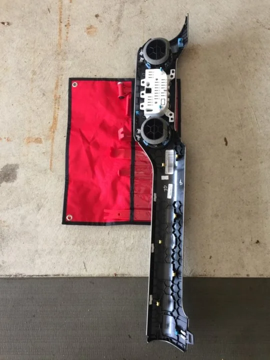

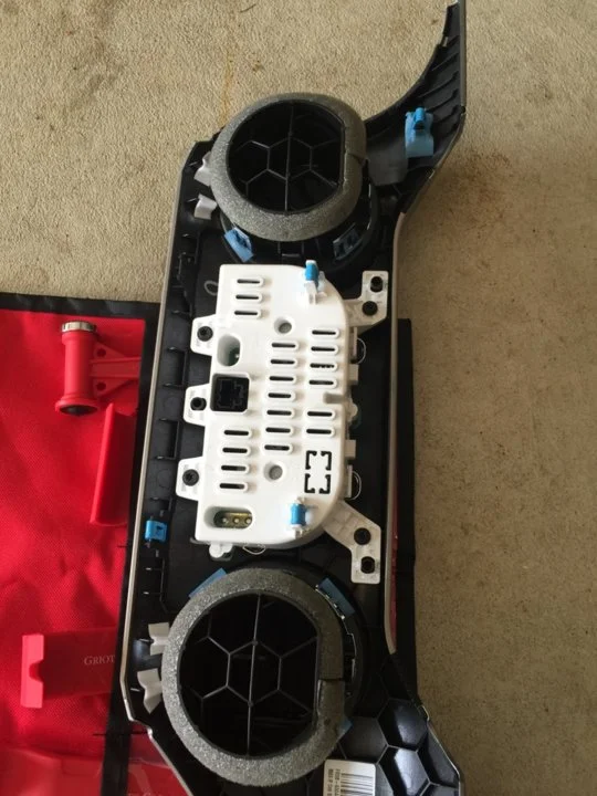

This is what the back of the panel looks like. I did not take pictures of the dash with the panel removed, only a quick video which I already posted

Jmeo said:
Then this will not work for you...... Unless you swap the dash panel you have for the PP panel. I would pull yours off and see if you have the wiring harness behind your dash.
Sent from my iPhone using Tapatalk
This is exactly what I wanted to see, Thanks!
Unfortunately for me, the dash panels are completely different and like you said this won't work. I appreciate the pictures though!
