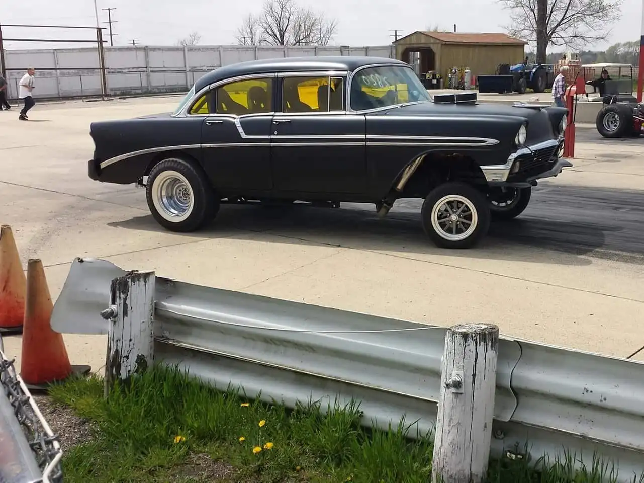

I'll give you an example to go along with my last post. My uncle has successfully built a number of cars. My cousin has a 56 Chevy that he wanted to build as a gasser. My uncle was able to locate a straight axle and welded all of the bracketry and such and got the car built. They took it to the local track, made a few passes before my uncle took a turn. One of his welds broke, but luckily he was able to keep the car under control and safely got it stopped. Can you imagine how badly that could've gone? All it takes is one thing to not be right and disaster could strike. Cars are repairable, but lives are not. So I truly hope that everything is copacetic with your build when you actually put power to the pavement.
(This is my cousin's car....)

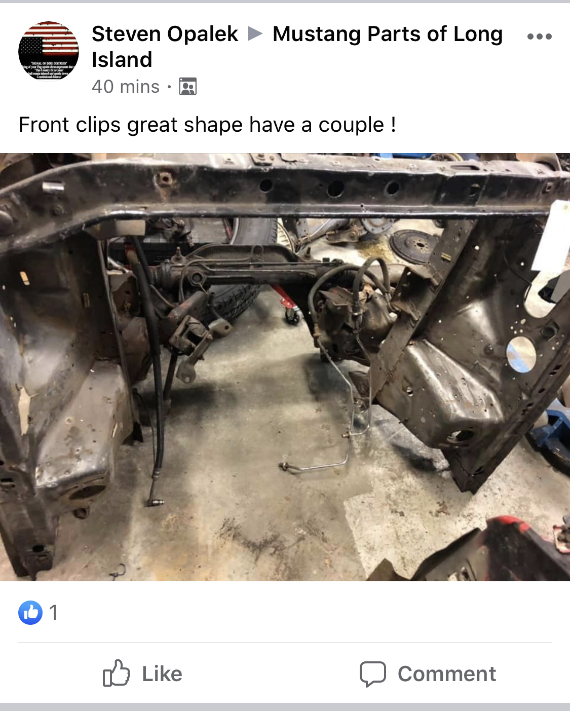

In the mean time i have a question while i know the similarities between fox and sn95 platforms i could never get a beat up fox and just snatch some parts n leave it to rot, buuutt my passion for the new edges arent exactly the same and i would just spring for a $500-$800 sn95 but in my entire state there really isnt any. I have found a few new edge cars (99-04) that i could pick up for some misc parts. Could i get stuff like rear end, gas tank, little misc hoses and such maybe fuel lines and brake line from it ?
A lot of stuff changed by then. Brake lines all route differently. Fuel system and tank agent returnless.
Some stuff is the same, but closer to 2004 these cars were changing with the times and technology
