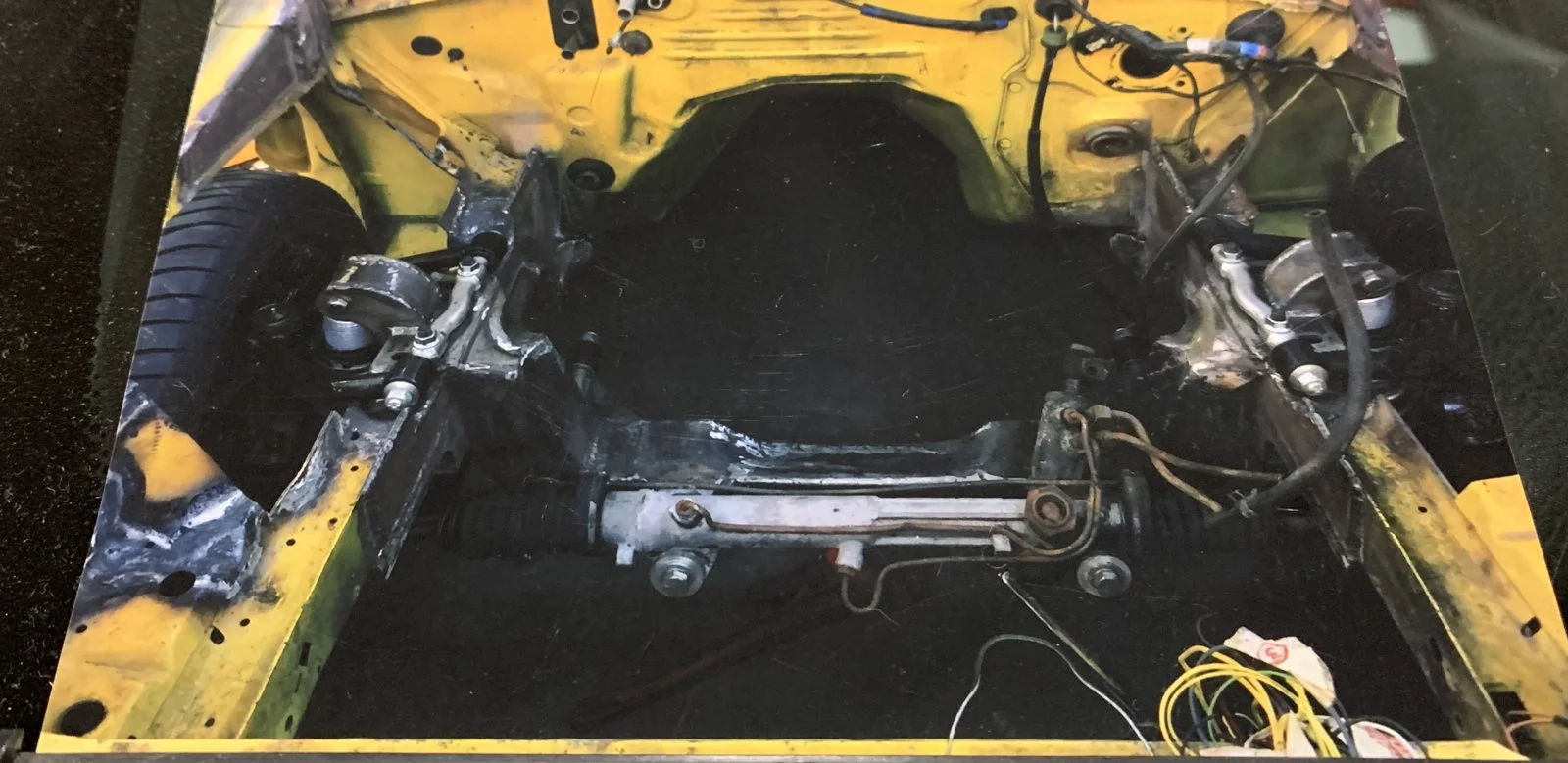

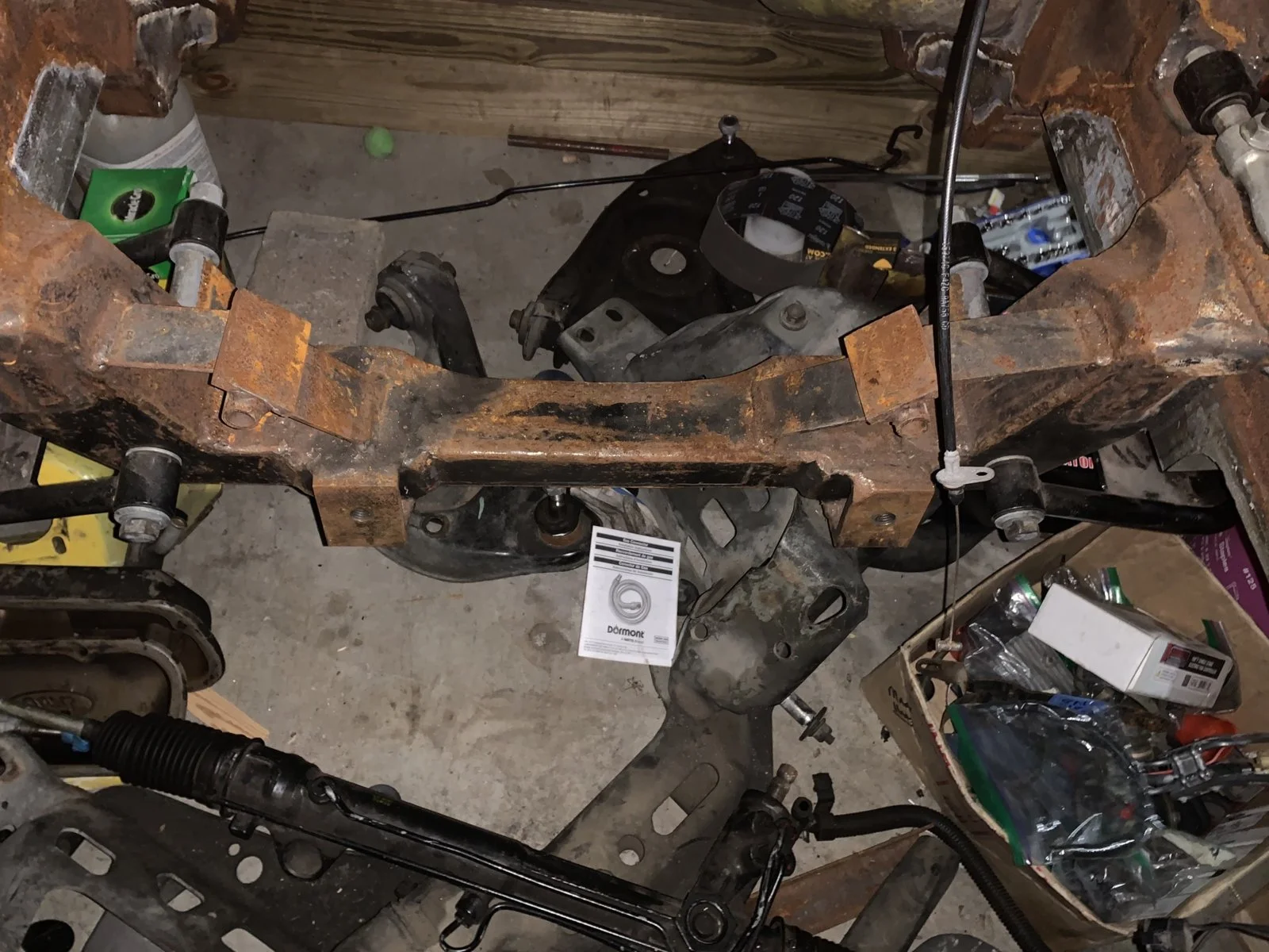

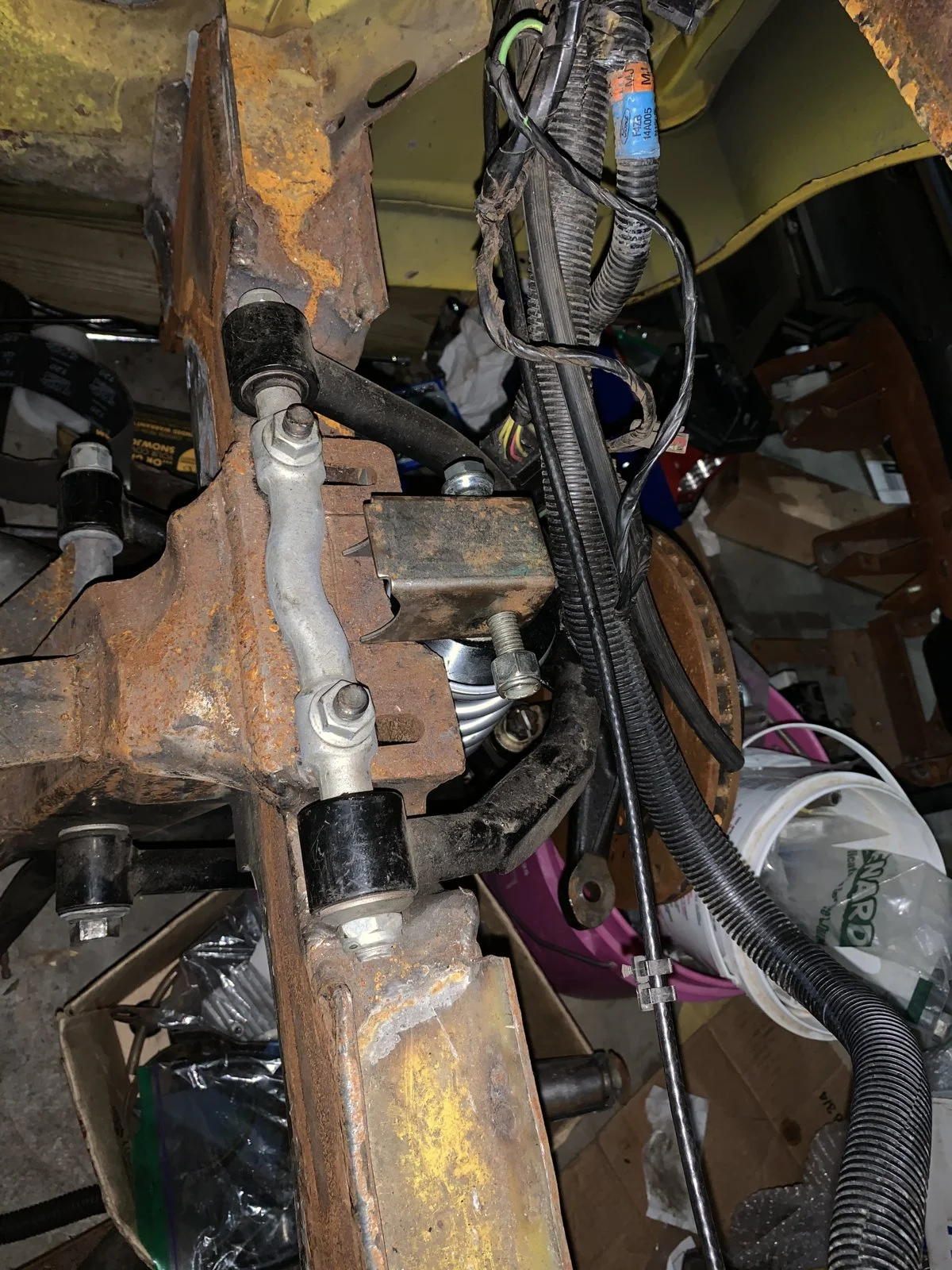

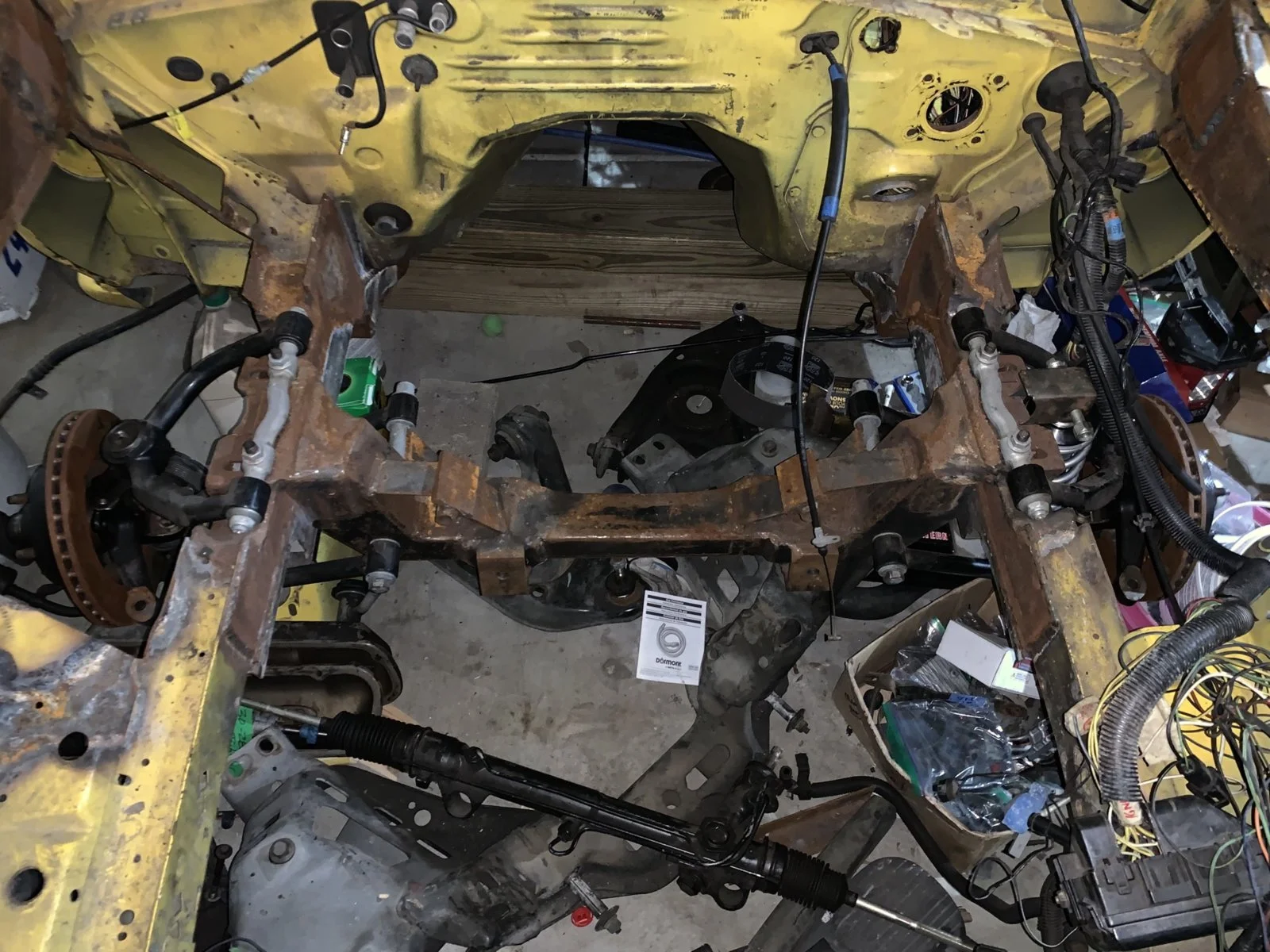

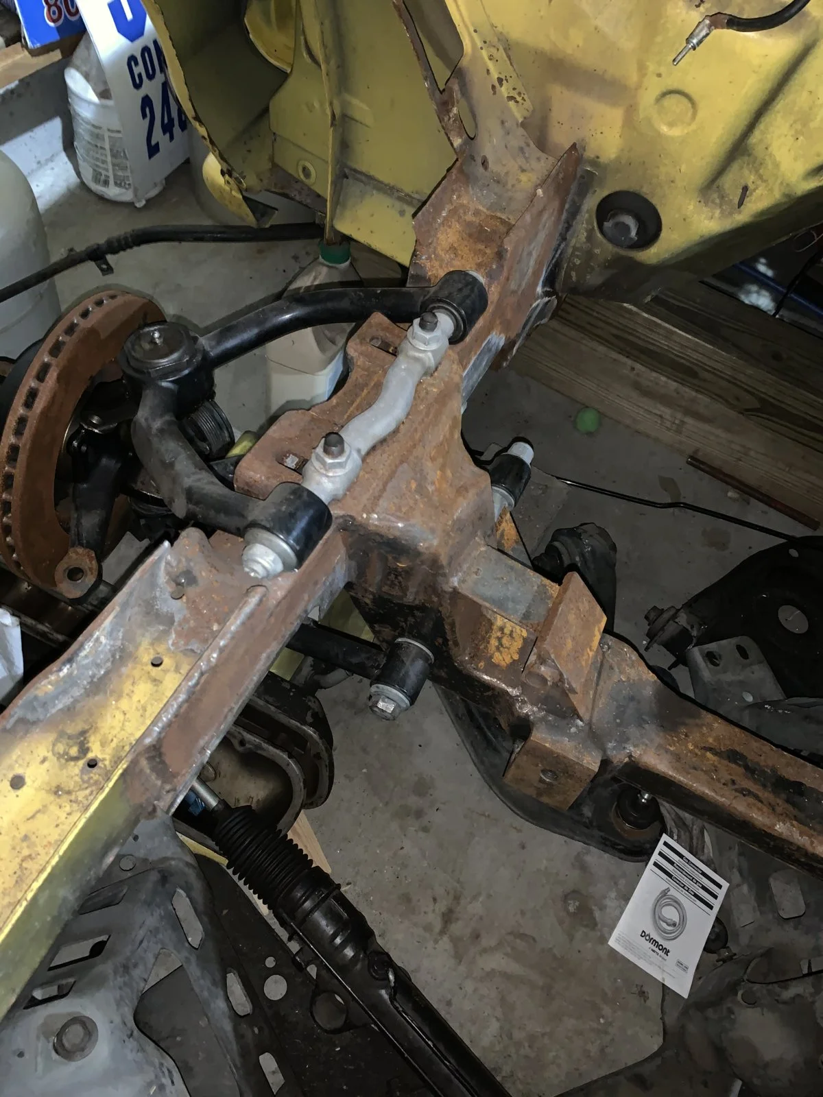

These are some photos of where it at and what i have to guide me to get it back to that point
Now I am not a fabricator, nor have I ever played one on tv but I'll tell ya that looks pretty stout to me, are you doing a cage of any kind?
The reason I ask is I (and remember I'm not a fabricator) would add those bars from the cowl to the front frame rail at the radiator support. Other than that I think it looks very good.

unless there is some reason that car should stay in your life, your fathers friend has doomed it to JY status. If you arent a consummate welder, the whole deal will be best left to die in some field behind some shed.
Taking a donor car, and going through the process of cutting off that snout, then replacing it on the future dead car would have me wondering why?
A 460 would’ve fit the engine bay in its stock configuration w/o needing anything other than mounts and headers. ( And those are already made by somebody else) let alone a 351w which would’ve literally dropped right into the stock mounts.
The work in those pics just screams “ I don’t know what I’m doing” ..any competent chassis guy would’ve advised your father he didn’t need to do any of that. And... even if he was putting in some obscenely huge mis-matched combo ( like 426 hemi) and needed the additional room that the factory strut towers interfered with, a competent chassis guy would’ve jut notched the strut towers to clear.
In its present state, there is no place for any of the sheetemetal to mount back to. There is already ride height issues, and it’s just one big pain in the ass waiting to get bigger. Who knows what kind of bump steer issues you have, and looking at the whole fab would have me terrified to drive it past a slow roll.
I wouldn’t bother buying a donor car. I’d buy another car, and donate the one you have to the shredder.

Theres a lot to take in so I'm just gonna start talking lol.
Grafting a stock front end back onto this is the start of a never ending project. So we will continue assuming keeping the mustang II front suspension.
First you should check to see how close of a mustang ii suspension setup you've got. Measure measure measure. Will a mustang II manual rack bolt right into what you've got?
Do you mean 1-2" of travel on the coilover or do you mean the k-member is that close to the ground? Low ground clearance will be a headache, I aimed for a minimum of 3" at the k-member which matched the 03-04 cobras with my tires tucked.
If you are can do the math you can figure out where to put your upper shock mount. It's a lot of measuring and articulating the spring-less suspension but it is doable. You'll need wheels with tires to do this, i don't see any in the pics.
