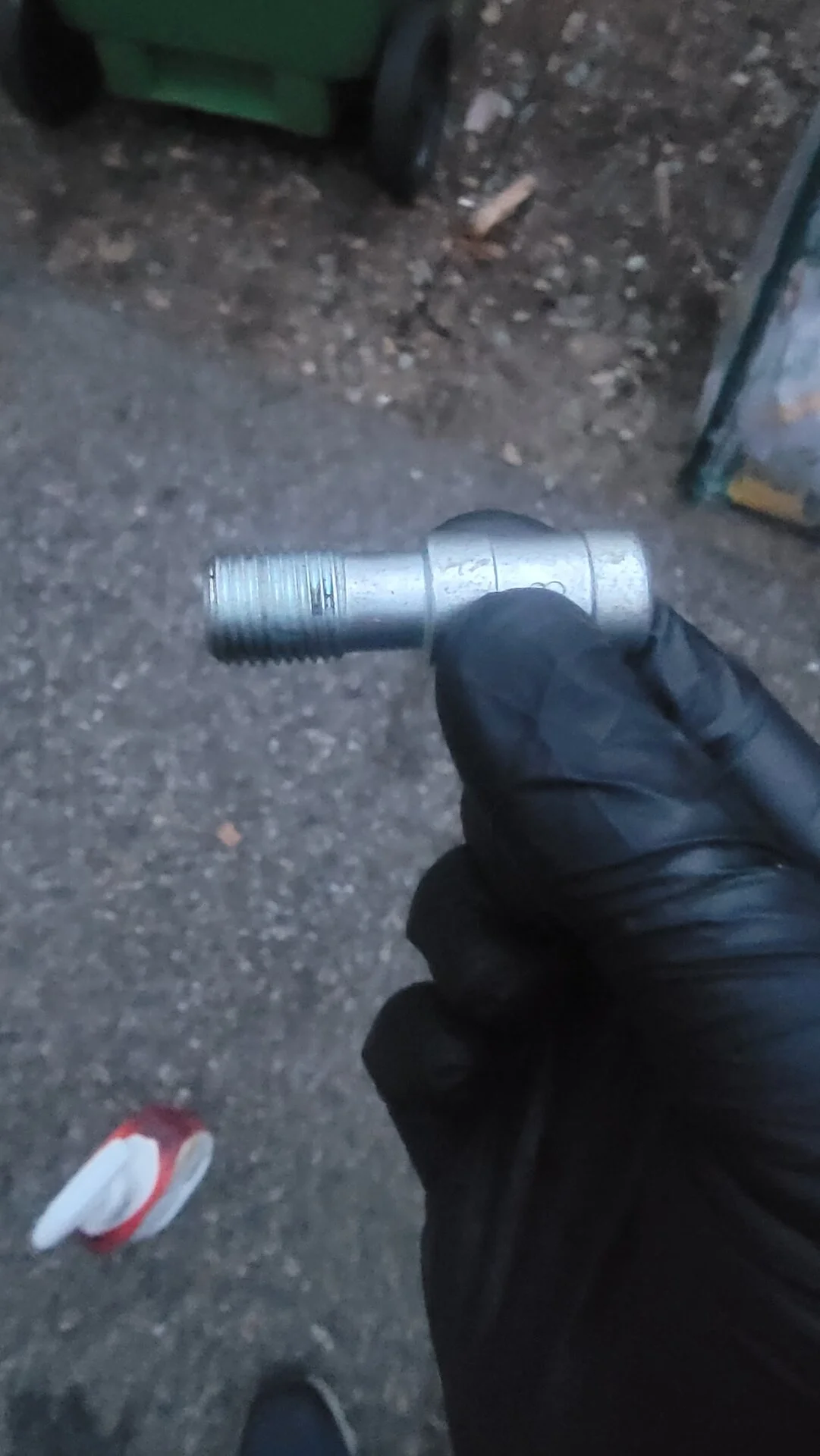

doing harmonic balancer for first time
yes I'm a noob I'll be a good laugh with all my questions now can any help with this adapter that's stuck
Ahhhhh, you can spin the engine backwards by hand till the rope inside the cylinder stops the rotation then try to remove it, maybe use an impact or a long breaker bar, that's what I would do.
Reactions: 7991LXnSHO

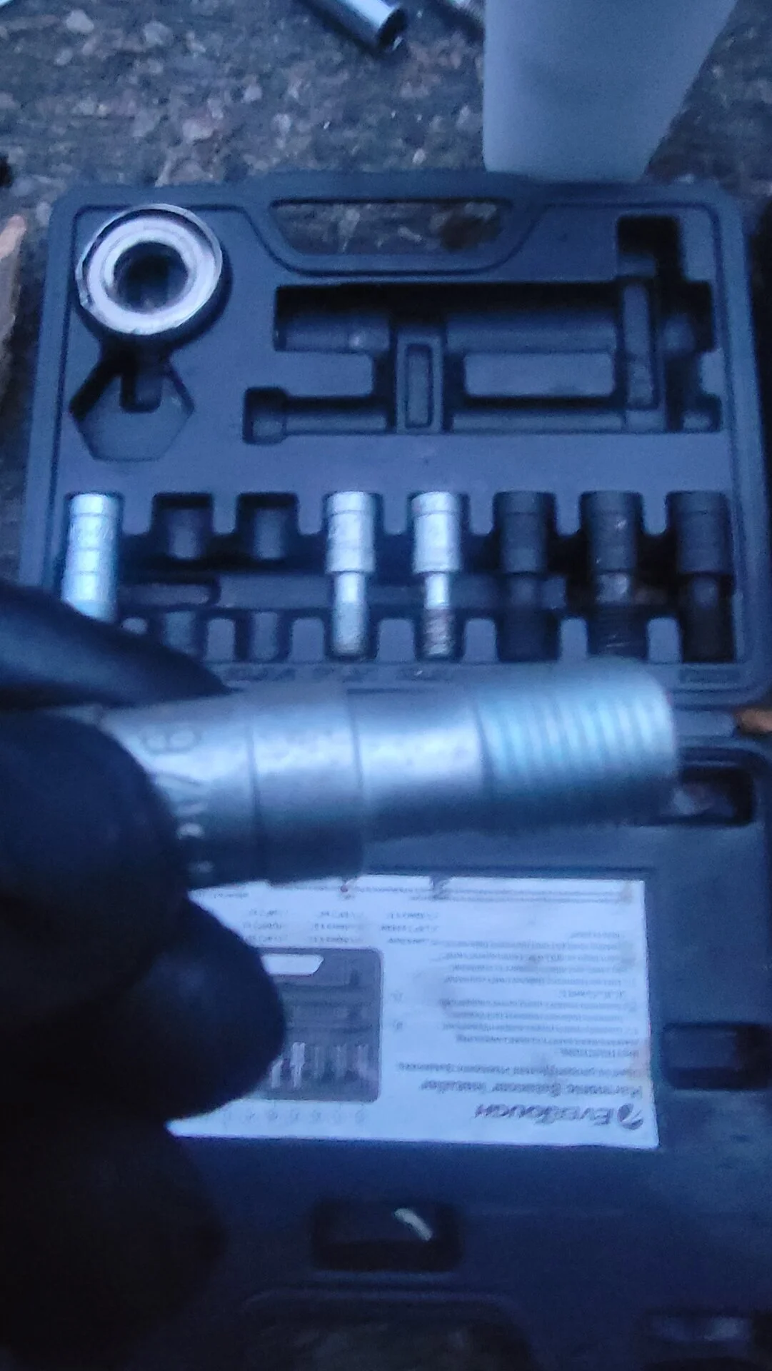

it's this part from the install kit
Can you get a large nut on the piece that screws into that? If so you can lock it down and try removing them togrther.
Or use some crazy glue to lock it on then remove them, cause you gotta get it out somehow right?
