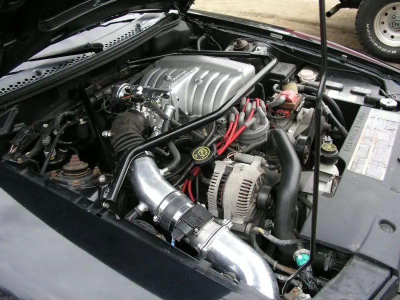

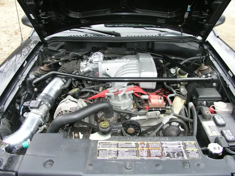

When I did my Fox TB swap I did a ghetto-fab of cutting that OEM corrugated rubber hose that goes to the air box and using that as a flex elbow to my 94-95 cold air.
This was supposed to be a temporary fix, but I'm still running that way a year later. . . :doh:

Yes it will! The temps are going to be much hotter there. I was looking at the cold air kits for the foxes and with the stock strut tower brace the kit will have to be pointed downward more to clear but that should work. I'm not not sure you'll be able to use the fender mount part of the kit due to the difference in the inner fender on the fox.
