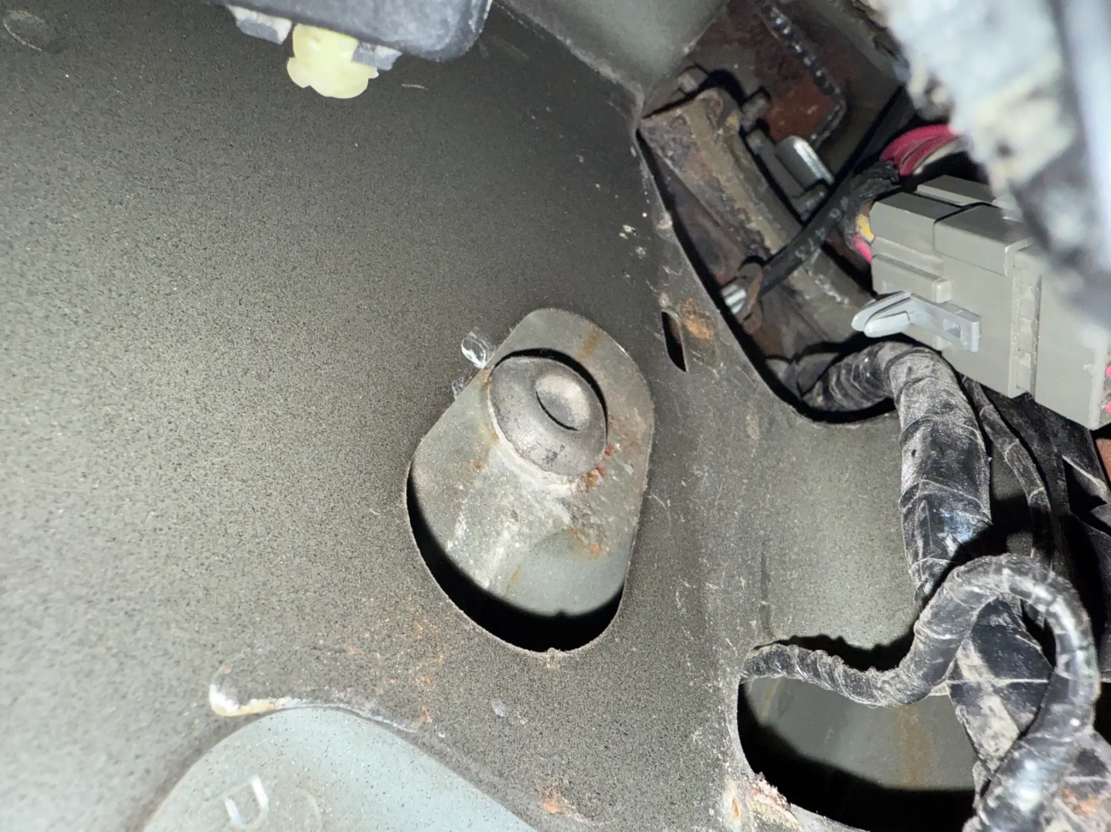

Was working around the ECU and I noticed above it I got some rust going on. I had metal work done on the car there and it looks like where the welds burned through to the other side and left bare metal it caused rust. It’s pretty deep in there and hard to reach how would you guys treat that?
I have a bottle of OSPHO I was thinking putting it in a spray bottle and jet streaming it up in there but is that stuff safe if it gets on any of my wires?

Pretty sure OSPHO is just pool acid... It will not harm plastics....... BUT, after spraing it, I would wipe it down a couple of time with a damp cloth, dry it, then mask and paint it.....

Do you have to paint it? Will the rust be stopped with just the ospho alone? I’d rather not paint it cause I’m scared overspray might get everywhere in my interior and exterior
I also don’t even know if I’d be able to get a spray can at the right angle in that tight space to shoot paint up there
Ospho is not 'just pool acid', it IS caustic but a chemical that reacts with rust turning it black once it's dry you should wipe down with thinner or wax/grease remover then a coat of etching primer then paint, otherwise it will start to rust again, not right away but soon.
If I attempt fixing it without removing the dash id use a long brush like Mcmahst recommended. In that case I won’t be able to use spray cans so I can’t spray self etching primer on it. In the past when I’ve used ospho I’ve just top coated it with Eastwood rust encapsulator and that’s it. I never use primer. Is that wrong or will that work?
I believe that will work just fine, I think Eastwood has a spray with a flexible tube spray head of some kind, check em out, I'd pull the dash to make sure I got it all taken care of. But that's me.

If your worried about over spay use wool wax or fluid film then wipe off Areas that are still sealed by paint....
