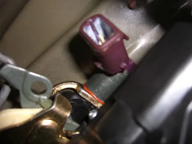

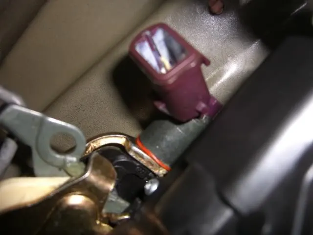

Driver door ajar Switch
So I finally got around to getting the replacement 'door ajar switch' - see first image below. So I took the door apart again and was still not able to get the damn thing off!! I tried twisting and pulling but no go, here are my questions:
1) Looking at the pictures of the switch below with the little metal tab thing, does it look like a twist off or does it look like there is something else holding it in? The last picture is of the switch inside the door still attached to the doorlatch
2) Can anyone tell me if there is a knack to disconnecting the plastic clips for the door lock actuators so that I can remove the door latch from the door and thus make it easier to remove the door ajar switch?
3) When I was unable to remove the switch, I decided to make sure that was the actual problem. I plugged the connection into the new one expecting the light inside the car to come on and it did not, I pushed in the little button on the top of the switch and still nothing - does that mean the switch in the door is really ok and the problem is elsewhere? Should the connection have a live current that I could check with a multimeter or something?
I would really appreciate some help on this lads, the car is still in pieces but I have to put it back together tonight for work tomorrow.

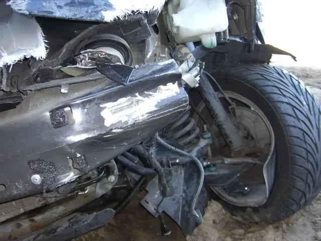

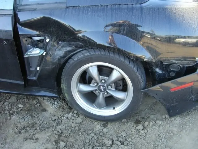

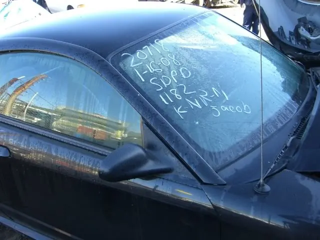

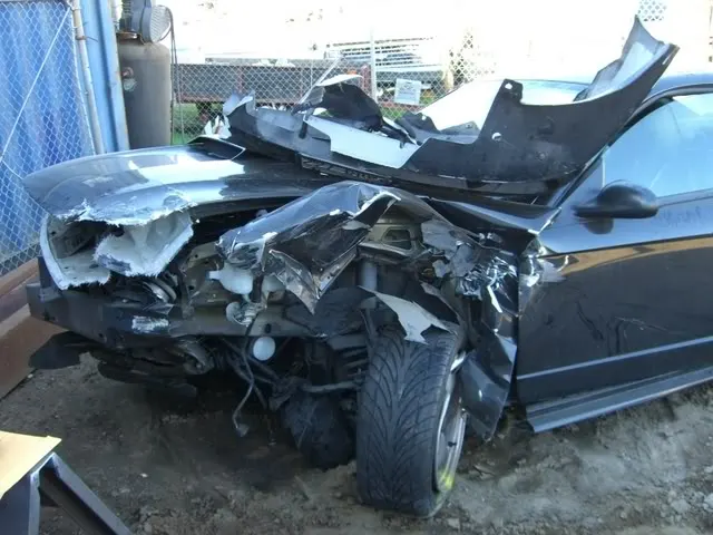

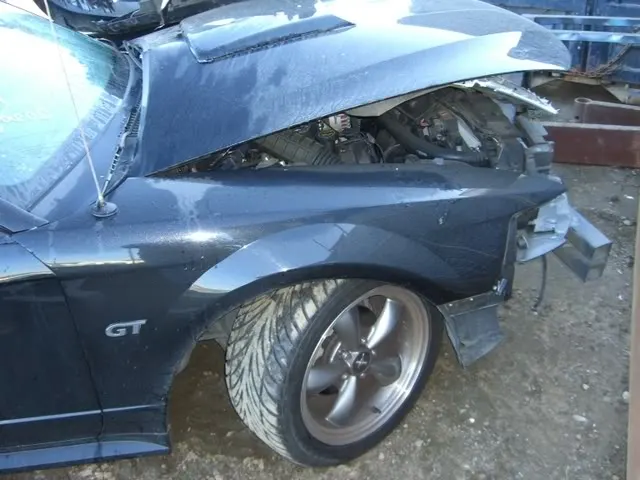

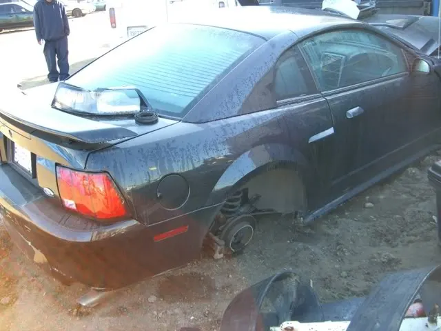

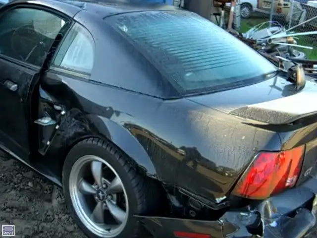

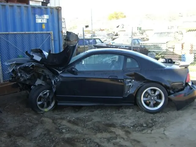

Problem Solved (Kind of)
Hey lads,
well I don't have to worry about the door switch issue anymore because my poor 03 GT was totaled by a drunk drive :shock:
Check out the pictures of woe:
Next I will be getting a Mach 1 but these pictures really make me sad :(
