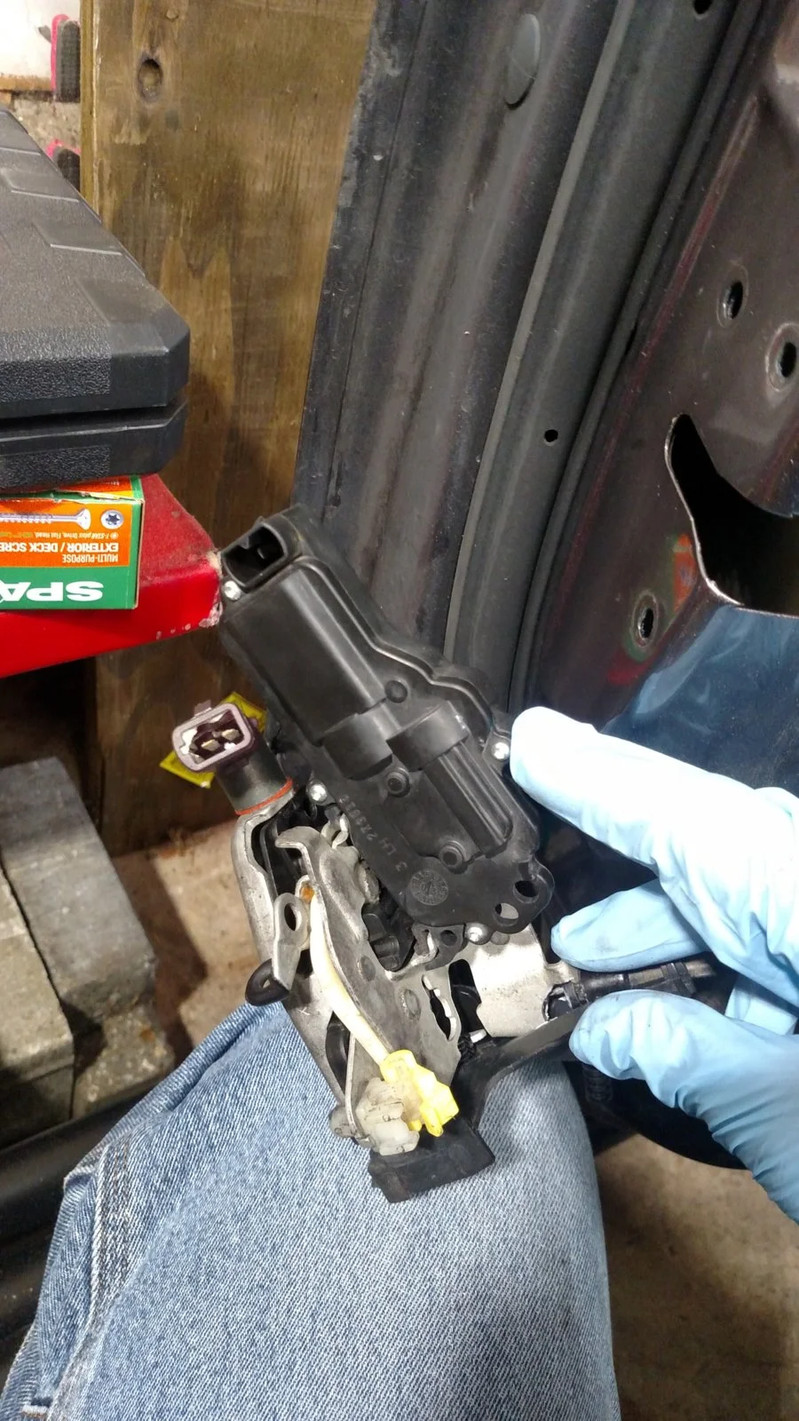

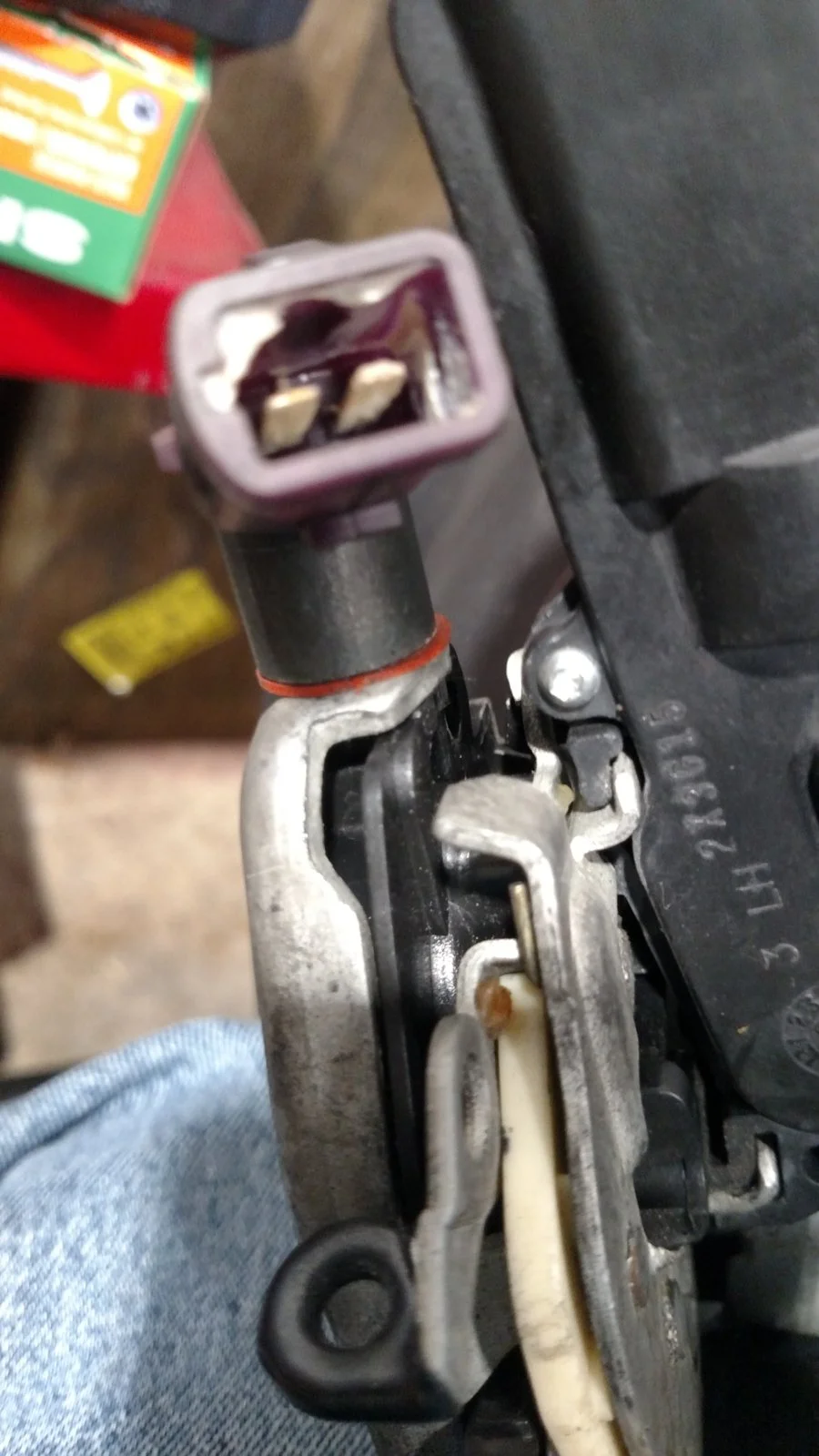

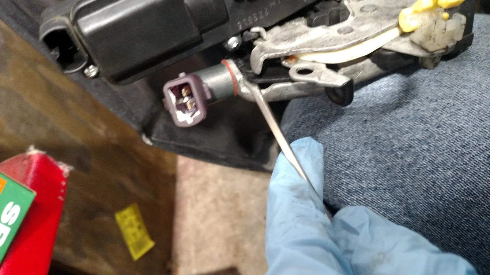

Ok, how is this for a threadsurrection? I just fixed this today in my Mach 1 and I wanted to both thank Top Fuel Friday for his comment and also post some pics for the next poor sucker that can't figure this out. Here as some pics of the latch assembly I removed from the car that should help anyone else figure this out. In regard to what Top Fuel Friday said, I pried out on the plastic clip as opposed to pushing it in but it worked just fine. I'm not sure if I could do that without removing the latch or not so maybe pushing it in is the way to go.
Sorry the one pic is a bit blurry, I only have 2 hands and my phone is a bit of a potato these days. I'm going to post a link to this thread in another thread that will hopefully help other people figure this out.
