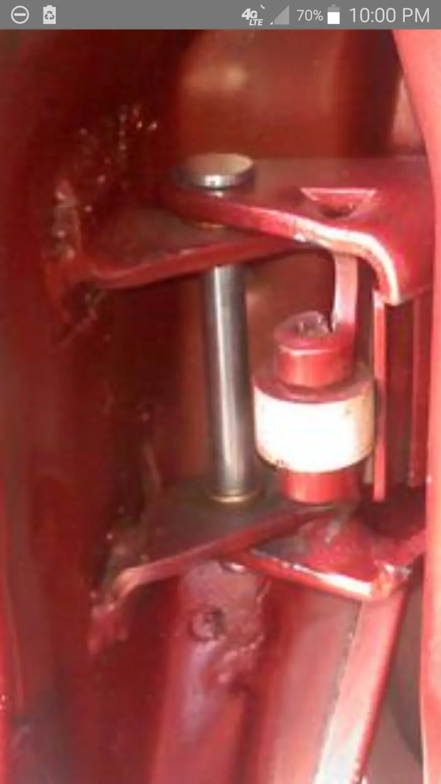

I have to disagree. There's a reason they go in the correct way. It's very hard to describe on here but....the bushings have a flange that needs to be held captive between the two hinge pieces. I've put lots of these in and never had to put them in the wrong way. And yes I'd try the oversized ones. With the old ones out, all you do is see which bushings fit very tightly in the hinge holes. The bushing makes up the slop in the holes so you may need to used an oversized one in only one place. That will be fine since the inner diameter is matched to the pin.
630997
Like this. If you put the lower bushing in from the top then the flange is just sitting on the top. Nothing holds it in that way and yes they can come out. End of the world? No. The wrong way to do it? Yes. Now you know. Hope it goes good for ya. :nice:

Well, I reinstalled the bushings the proper way. Even though my original bushing holes are not hogged-out and the bushing seem pretty tight, I'm still able to wiggle the door up and down a bit if I gently lift it. I was originally gonna use the "oversized bushings kit" to make it a tighter fit, I could in no way get those fat bushings in. I guess the only remedy I can now think of is to get 4 of those fatter bushings are slightly hollow out the bushing holes so I can get those bigger bushings installed. I'm thinking that there is a slight amount of "play" in the original sized bushing holes. Not hogged-out, but enough wiggle room to allow 1/8" or so of door play when pulling up on the open door.
Glad you got them in there. I would not make those holes bigger. If anything, chuck the bigger bushing in a drill...you'll have to get creative to do this but it's not hard. Then take a piece of 80 grit or so sandpaper and sand the outside of the bushing while it's spinning. Do this until it is a perfect fit. Time consuming but it works.
