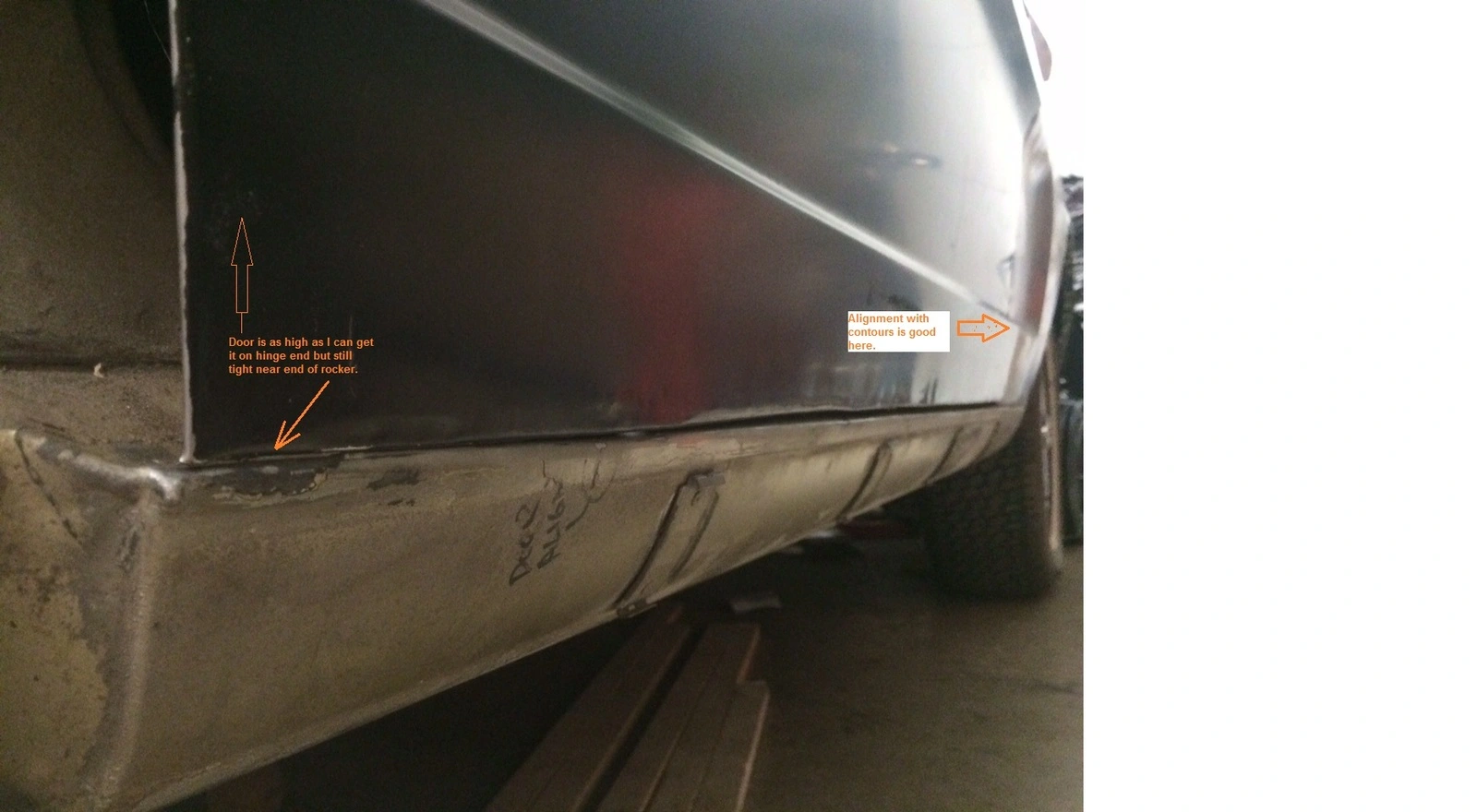

Anyone have much luck re-skinning a door? I did mine yesterday and am not really happy with it. Started with a Dynacorn skin but I don't think there's any issue with that. I used a air operated door skinning tool which did not operate as easy as they make it look in the video. Right on the tool head it says "Max Air 60#" but I had to turn my flow up to 100# to get it to start folding the flange over. At 60# it wouldn't tear a wet paper towel.
Anyway, look at the pic. The lower line on the door was rippled due to the tool and I will need to do some work there to smooth but it's not too bad. Can be fixed. I'm more worried about the gap above the rocker as it's fairly consistent all the way along but then gets really tight at the last 4 or 5 inches on hinge side. The door is up as high as possible on the hinge end and the body contours line up good on the other end.
I have not tack welded the skin yet.
Any suggestions??

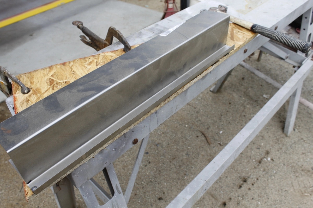

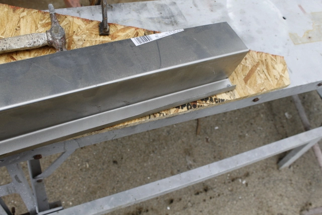

lets start with a simulated door .It is 20 gauge sheet metal so close to a real door ,we have a box channel for the door shell and a flat face with a 1/2 inch lip for the door skin. With the shell setting in the skin and on my plywood

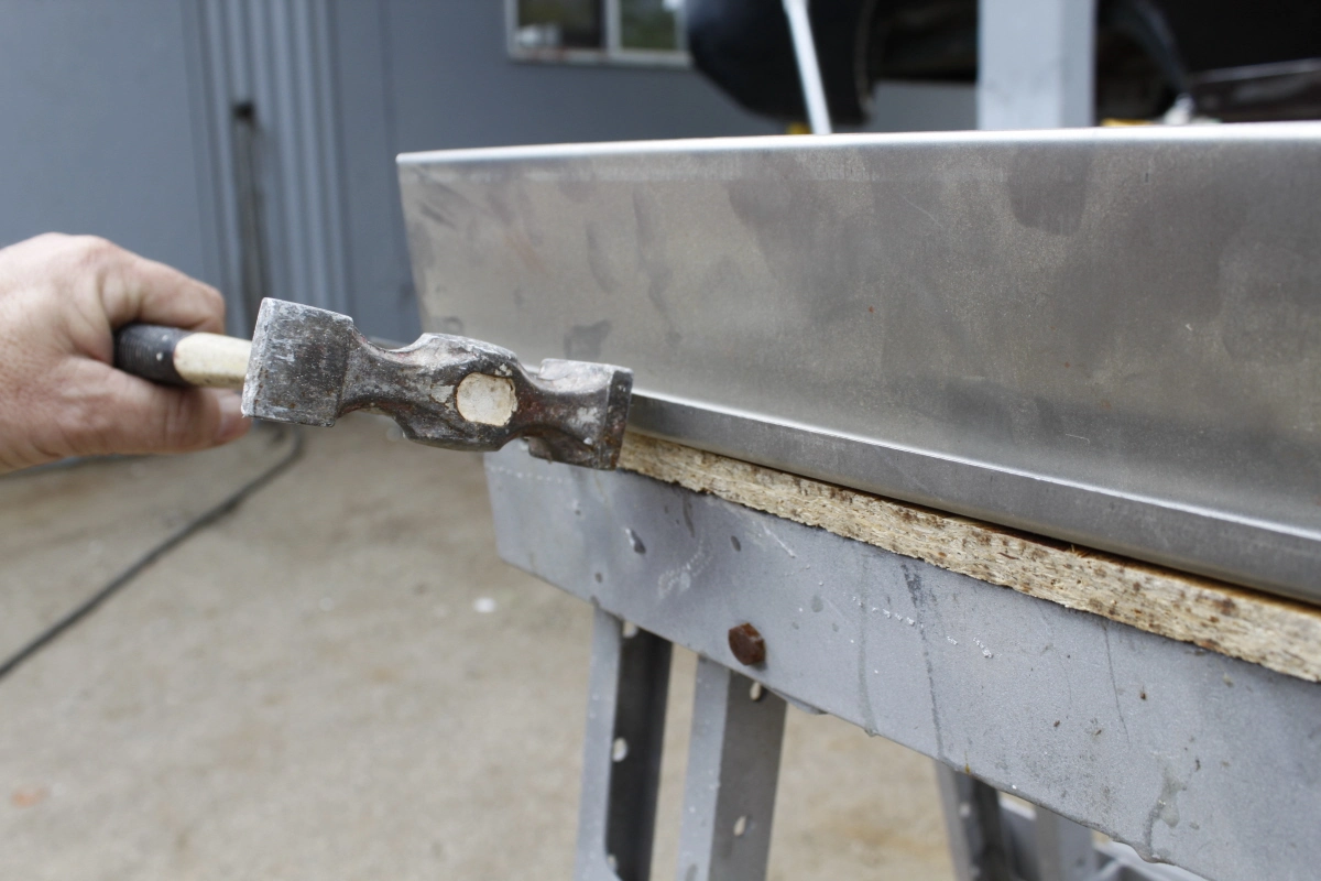

Start hitting the flap in a slight angle to start the metal bending on the fold .go all the way down the skin with light hits just enough to get it to bend,do not try to bend it all the way just a slight bend at a time keeping the hammer blows one beside the other .

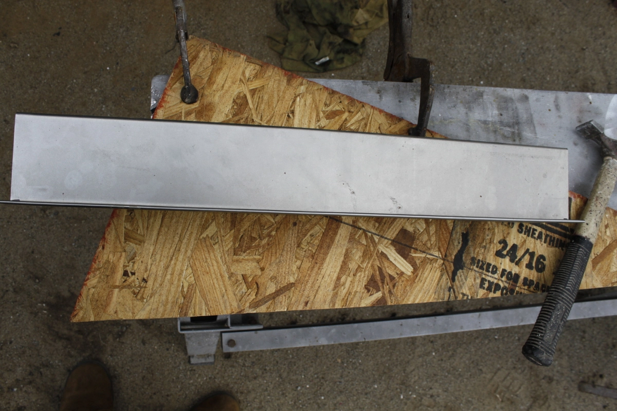

keep working the full length just a little at a time with light hits keeping the skin tight to the plywood or dolly what ever you use .It should take at least 4 passes to bring it down snug.
After you have made it to this point your hammer blows should over lap ,this will even out the folded edge an finish tightening up the fold .

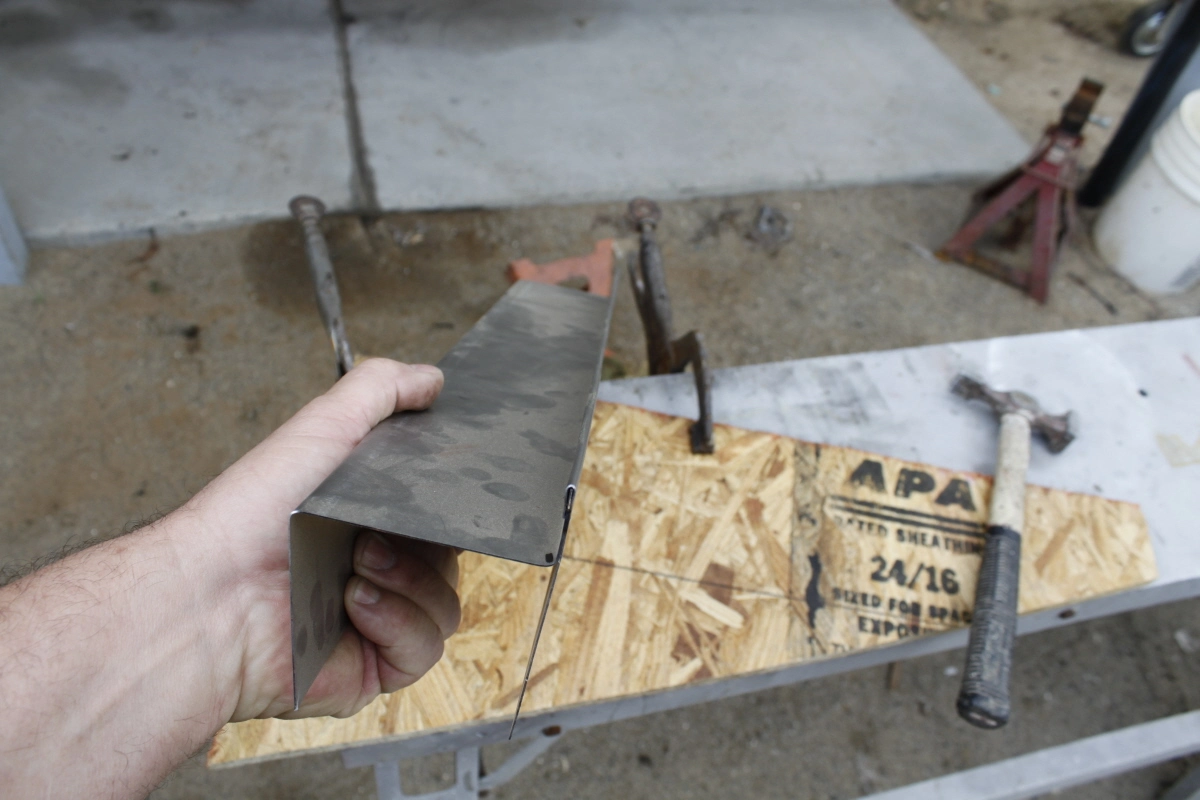

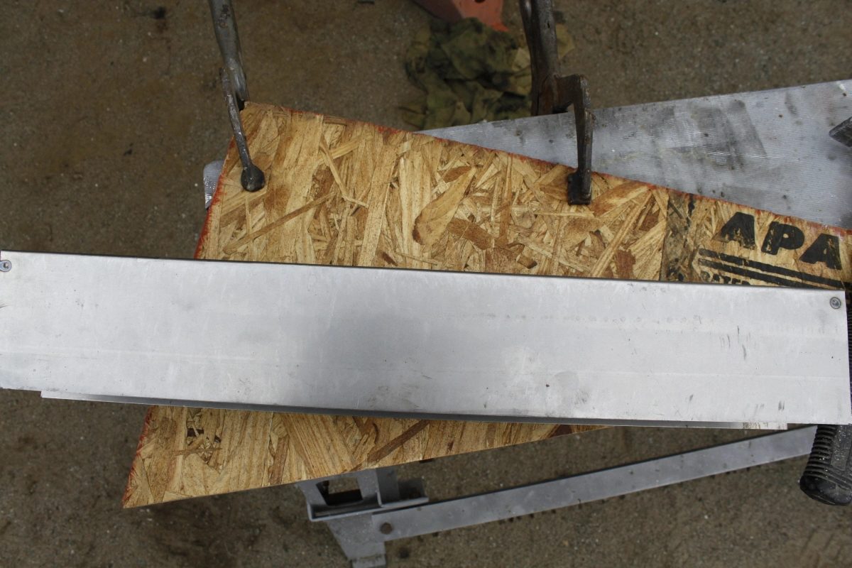

Nice tight fold and a straight edge

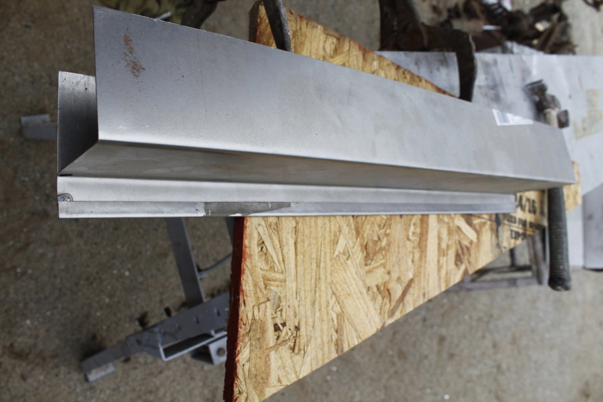

We even have a dent free front surface .the fold is at the top of the bottom pic

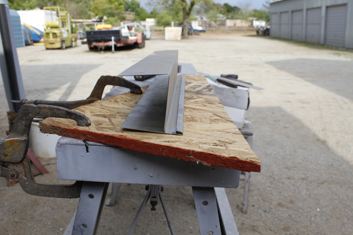

You will need a curved face dolly for the ends to get into the curls .if you should happen to get wobbles in the outer edges of the finished skinned door you can knock the edges in or out to remove the waves or wobbles .You can bend the edges enough to make them line up with the quarters ,rockers or the fenders if you need to.
You could try hitting upward on the edge where it hangs low ,it will distort the front a little but hammering the fold again may straighten the line .It looks good except for that last 4 or 5 inches .what it looks like it did was fold very slightly before the bend causing the skin to drop low at that last few inches.
Have you put a straight edge on that rocker? To me, it looks like the rocker rises making the gap tighter.

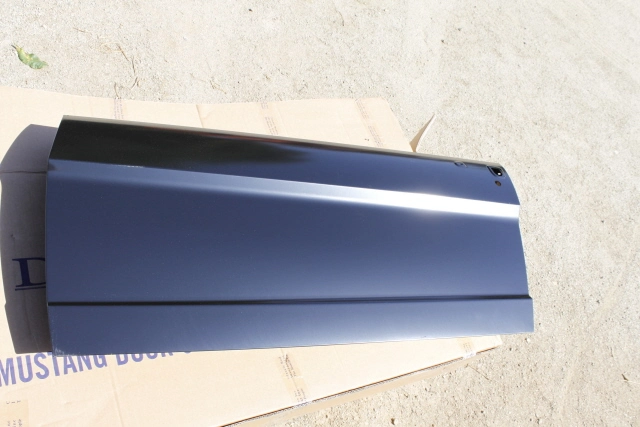

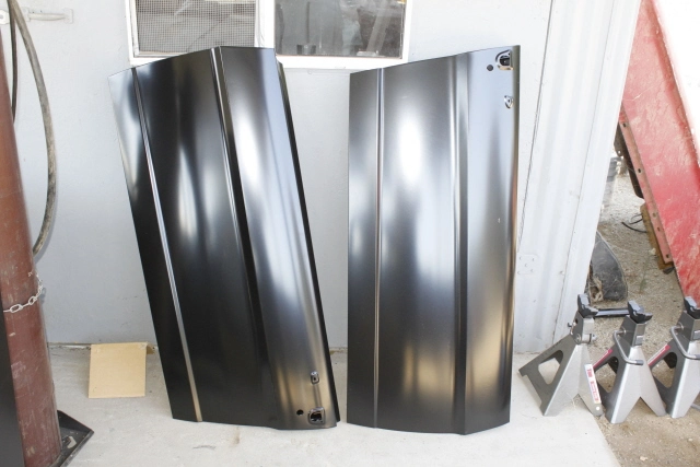

Must just be the visual in the pic. Checked it with a straightedge and it's dead straight. I pulled the skin off the door. Think I am just going to spend a few extra bucks and throw a Dynacorn shell at it. The door shell I used was not original to the car and it had some rust in the front corner. I had to cut out the rust and dolley a new section to weld in. The bottom flange that the skin folds over was not perfect along the base either. It's likely more cost effective for me to put a new shell on. I've heard the Dynacorn shells are darn near perfect. Any thoughts?

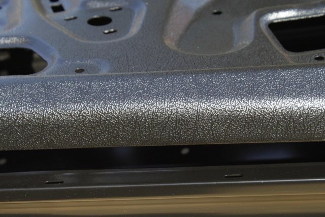

They are full doors . I don't know what they used to fold the lip but it is dent free.
Almost looks like it is pressed . I could not find even a small ding in the outer skin or any where . The 65 -66 are the only ones i have used so far ,if the other years are as nice i wouldn't even think of skinning a door .
