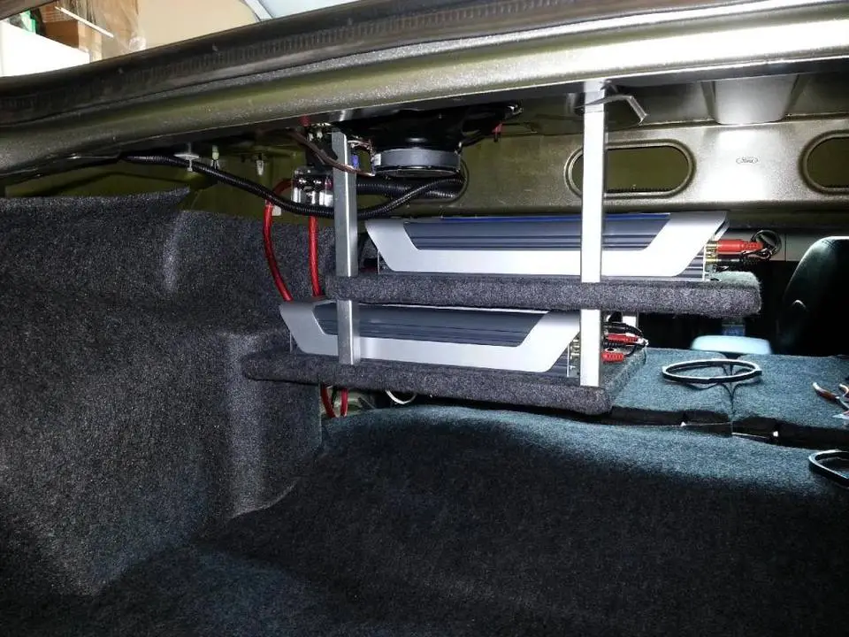

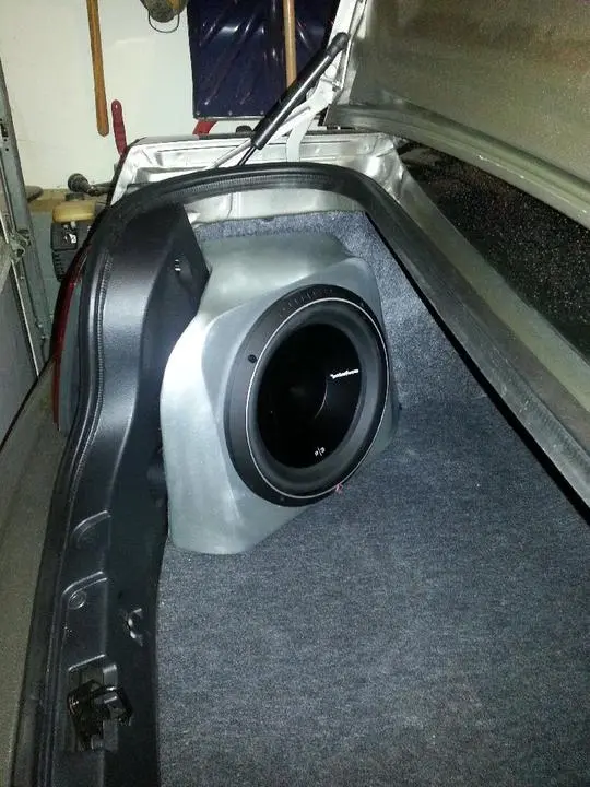

Total system replacement - Clarion DVD/NAV head unit, Infinity amps, Polk speakers all around and RF Punch 12" sub in a custom fiberglass enclosure I made to fit in the driver's side trunk corner near the tail light. Hung the amps from the package shelf inside the trunk to conserve space.

Not a good picture but here's how I hung mine (this is still during the install so the siring wasn't yet cleaned up and I had crappy RCA cables...)
(the mounting posts are straight - it's the camera perspective)
(the subwoofer enclosure wasn't yet properly finished - my steed isn't green but Vapor Metallic)
That could be true depending on the design of the driver. Mine is sealed; tuned to 28 Hz. I've designed and used similar enclosures for many years. Excellent response, amazing SPL and compact. Not a good solution for boom and drone though and there are a lot of folks out there that want boom and drone.
