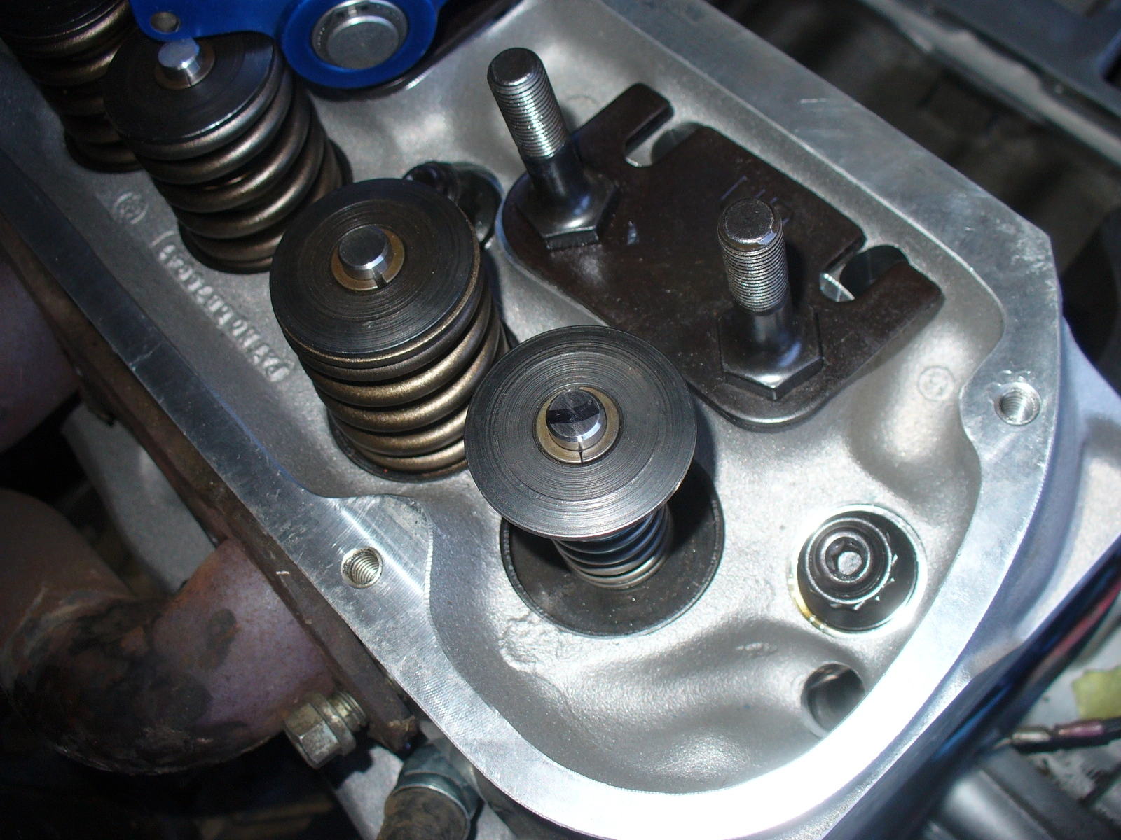

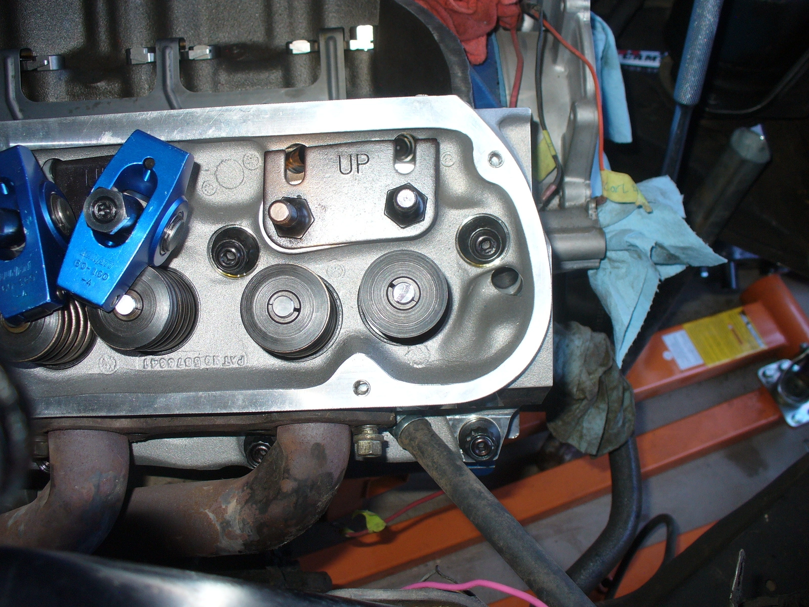

The last thing I need for my engine internally, is a set of push rods. I measured today.... 8.137 inch length. Seems like a lot to me, but Trick Flow said in their instructions that came with my heads that longer than stock PR's are required.
I guess my question is, does it matter where in the firing order you start with the measuring process? I installed the light weight springs, and made a few rotations. Came back to it and did it again today, with a solid converted roller lifter. PERFECT center of the valve stem, narrow sweep.

Do you see anything here that I may have done procedurally that is flawed? After my last go round with PR measurements, I just want to double check my method here.
