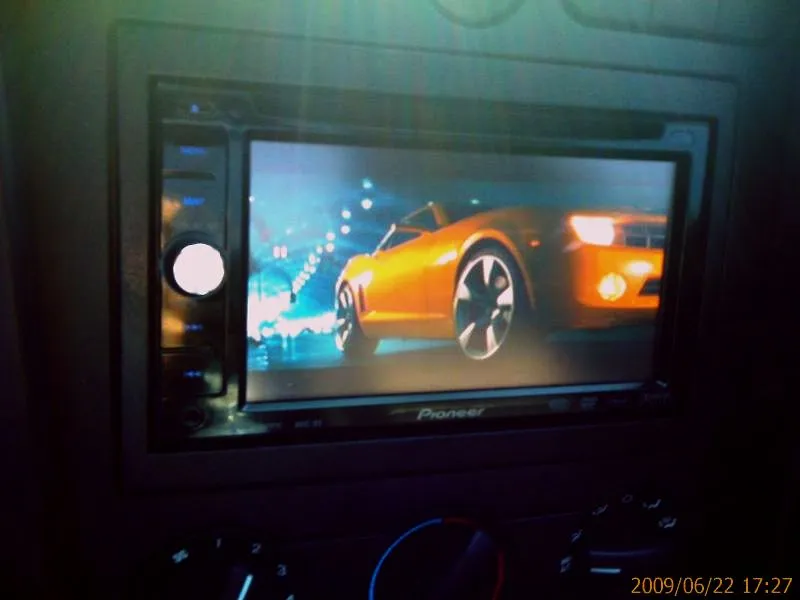

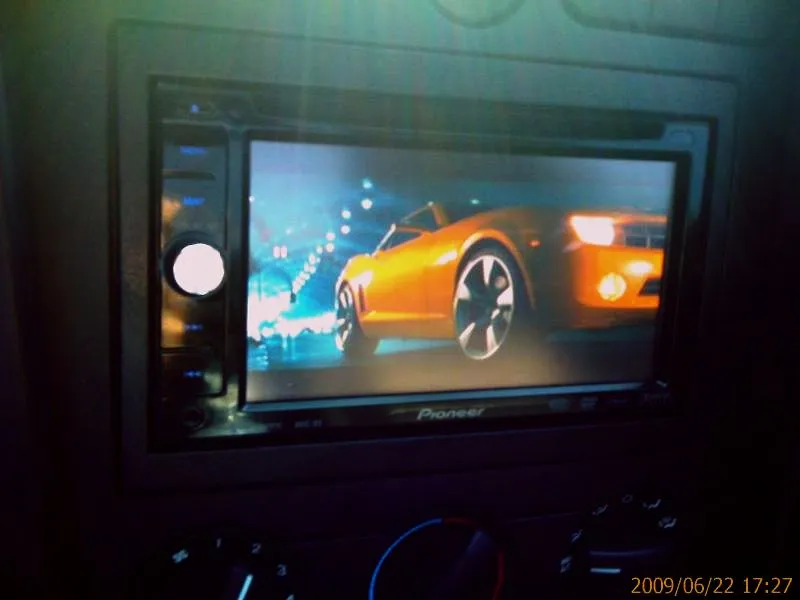

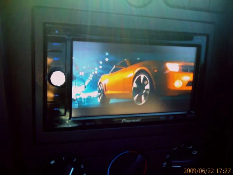

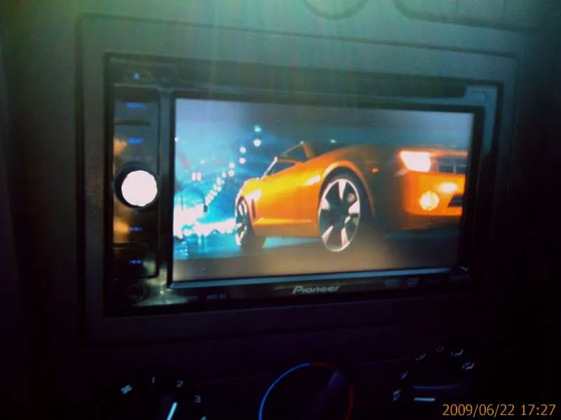

Good work. I sure miss the Pioneer double din I had in my 2006GT. Use to watch movies on the way to / from work.

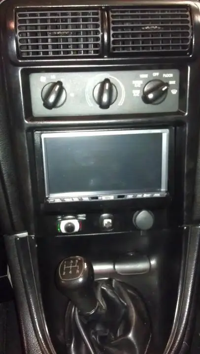

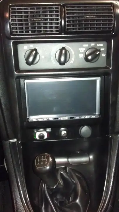

Finished... Still a few tweaks...... have to match the bezels better..... works pretty well another 7 hour day....
Touch is the way to go. Pretty easy.
Nav. DVD movie, Bluetooth, Ipod
In the knob holes are Blue tooth control, SCT chip/tune selector, and a cig lighter
