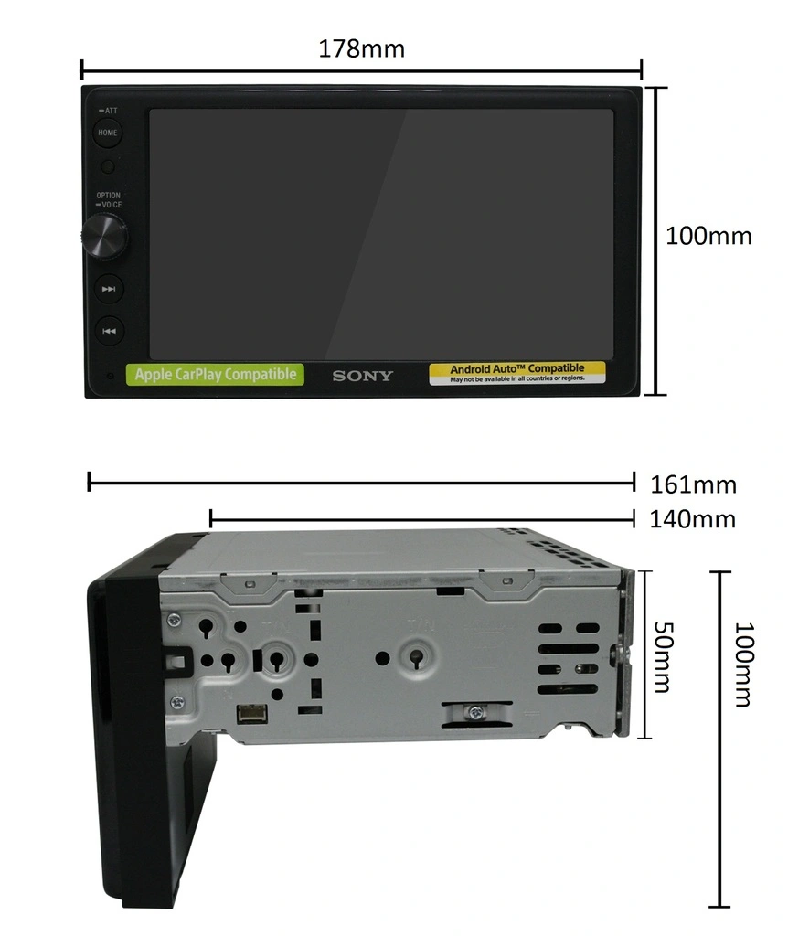

Basically the rear of the radio contacts the amp mount bracket and trans tunnel. How you clearance depends on the radio.
It's why I've been looking st the cd-less Sony XAV series. Should eliminate that issue.
Problem is I can't decide between Xav-ax100,ax1000 or the ax5000. Can't see the differences between them.
Me too. It’s definitely gonna be one of those Sony’s for me too so hopefully I don’t have to deal with the trans tunnel at all.
Exactly why I'm going with it. No more cds for me so phone connectivity is key. I usually leave Waze open to get alerts on speed traps and such. Hard to hear over my exhaust, but having it through the radio (with navigation ability as well) will really help. I need to watch some videos on the three and just pick one.

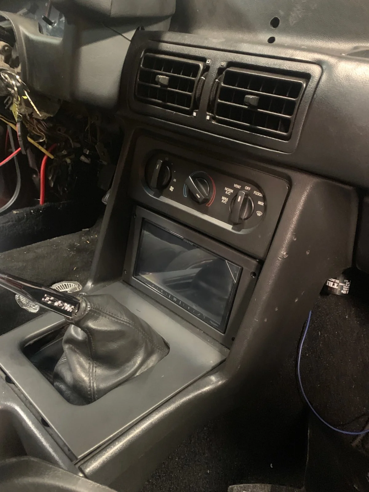

Just installed this a couple months ago. (Pic is during install, so dont mind the loose wire) Has apple play and andriod auto. The amp is in the trunk right now, I'm going to try and secure it to the back of the backseat.
I never drill to install radios in foxes. I've got a Pioneer in Dusty. Standard radios fit without any modifications other than removing the little bracket that holds the cubby hole to the bottom of the stock radio. The hole is already 7 inches. I remove the factory radio...then slide in the included radio surround. Bend tabs to hold securely...then I just slide the cubby in below it. The radio slides right in the surround securely. No need for any holes or plastic front adapters. Been doing it this way since the 90s.
