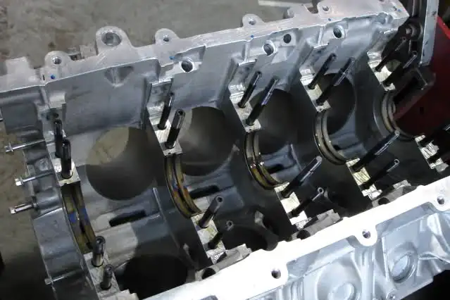

For what it's worth, my block has the Xcode (its a 98 block) and it has the jackscrews. I will take pictures of this later today if you would like to see, as I am installing my new main bearings and so on so it won't be difficult to get you a photo.
i dont know the block code, but i have a 1999 cobra with a teksid aluminum block.
this is what it looked like with my clevite bearings.
hope this helps, if you need a higher resolution pic let me know.
