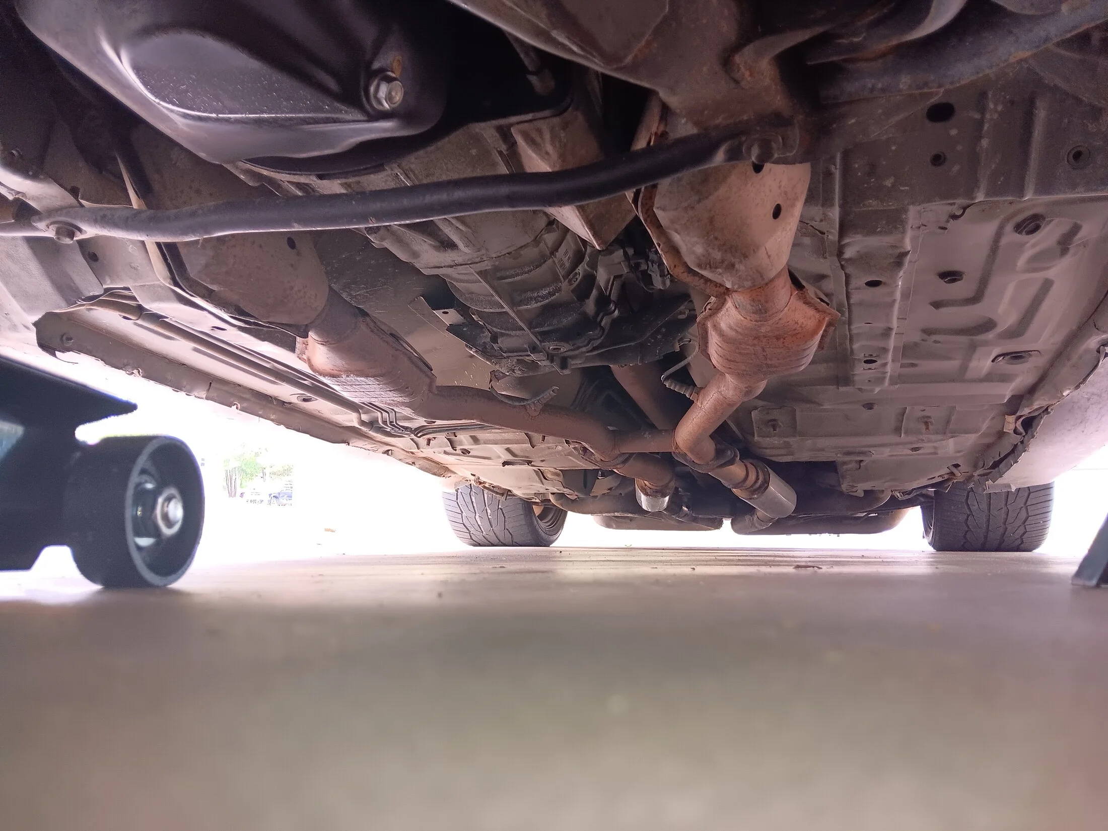

Ok so on my 01 svt cobra 4V 4.6 the hoses keep blowing off of my dpfe..I have taken the egr off and made sure valve is working, I have disconnected from the rear of my h pipe back and still the hoses blow off..the cats and what not are in front of the h amd everything is welded, but feels like plenty air moves through...someone PLEASE HELP!!!
Well everyone...today I got to lift and got one side of my stock h pipe off (cat n all) and took it for a test drive..that's DEFFINATELY my issue.. felt like my svt again ..so next up...bassani x pipe <3 thanks for all the tips everyone, have a great day!
