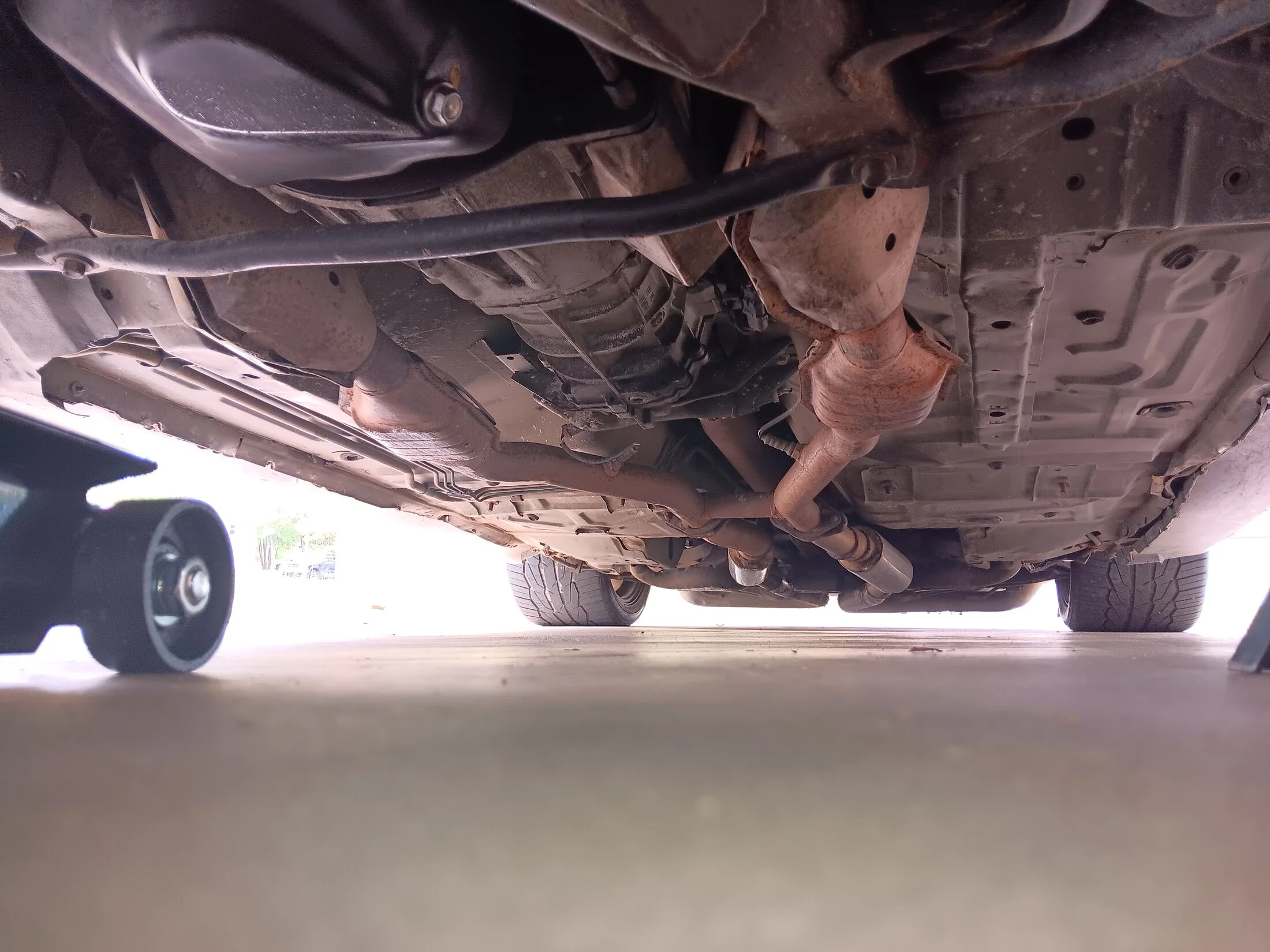

Agree I just did a 302 swap in a maverick I had..the 4.6 is new to me lol hang on I have it up today somewhat and will snap a pic

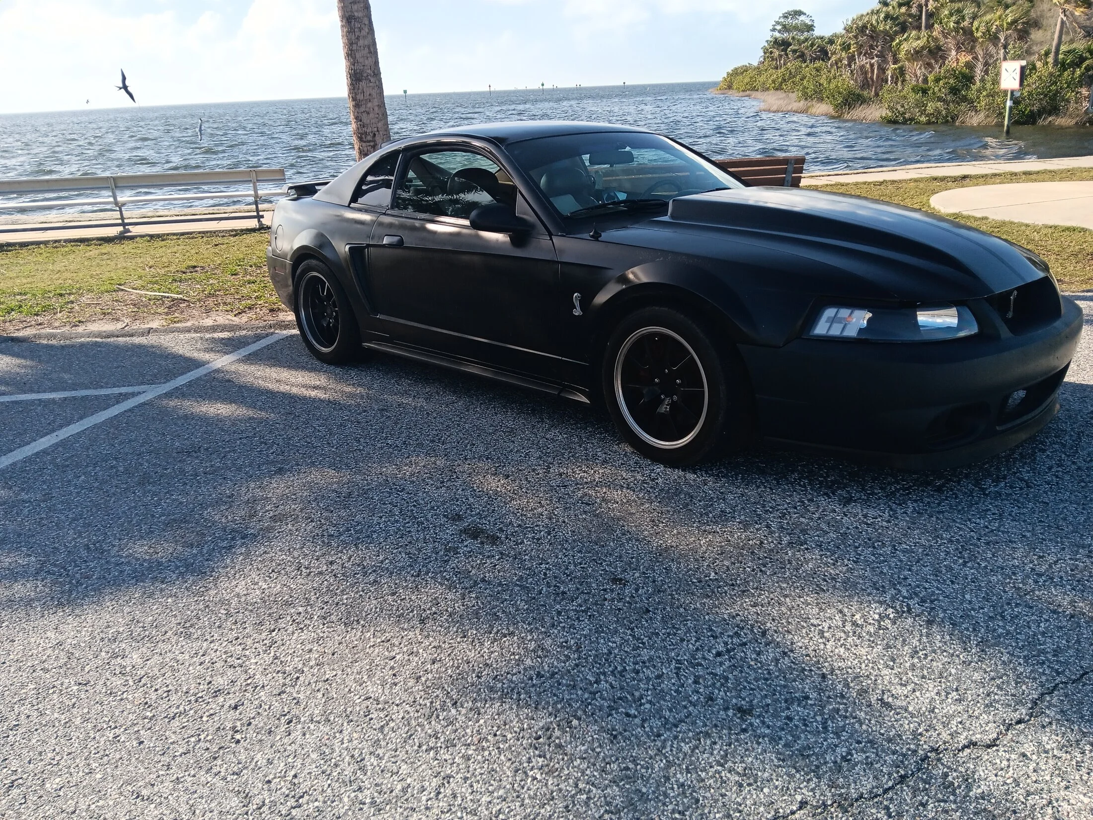

Also the 03 bumper, i put on myself after I got it..it did have the cobra r bumper but paint was terrible on bottom and it was too low where I lived so 03 was deff a must lol ..nice eye though :)
Remove the cats and see if it wakes up, maybe they are clogged.
That's kinda what I'm thinking..seems like alot of pressure blowing off the hoses on the dpfe but before today I hadn't had the car up high enough to actually see but now I was unable to get the nuts from the exhaust man. And that's right where I need to open it lol
Spray them down with blaster or wd 40, let em soak, then use a couple of uggs ugh uggs.
