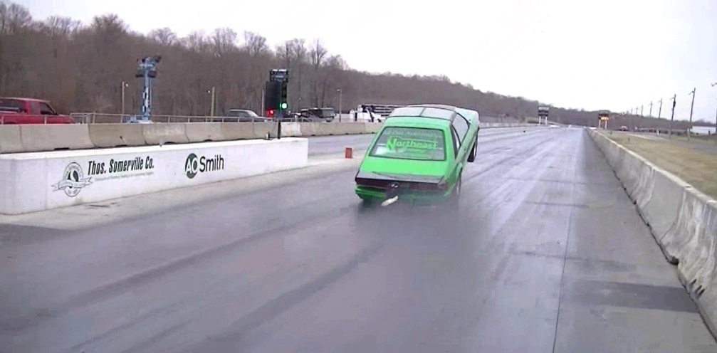

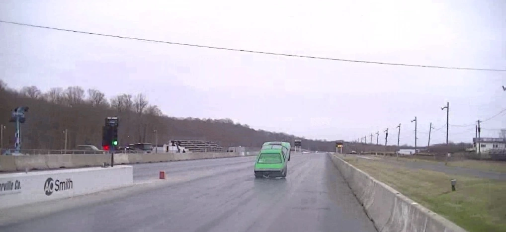

275/60/15 MT Pro Radials and leaving part throttle.... Drag radials work! Just worked a little too well in my instance...
