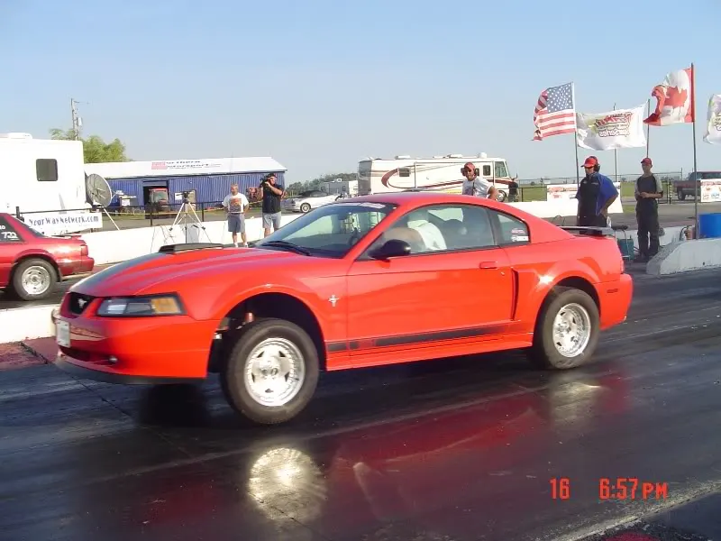

+1 on the MTs.
Ours
G
gfong
Aug 31, 2004
26
Jul 8, 2009
#18
  • Jul 8, 2009
  • #18
Good choice of drag radial. Very stable at the top end and predictable on the start. consistant as well.
and wrinkle....
