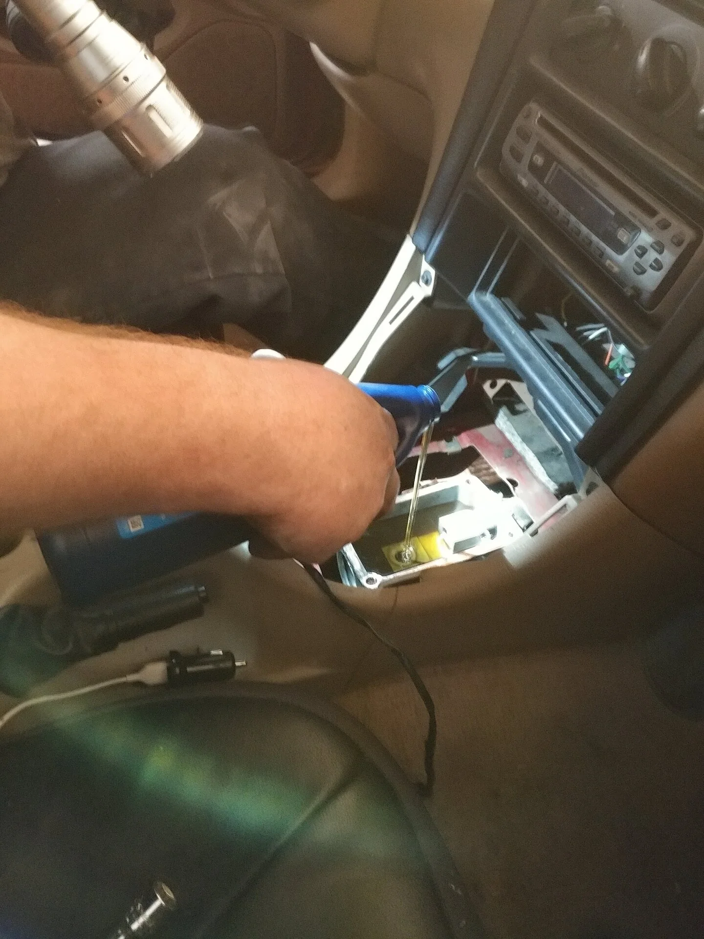

I drained my T-5 all over my garage floor (The Mess it causes) by taking the engine out and the trans attached. Some moron never bothered to plug the tail shaft of it. So Yes it is 100% possible to drain it this way.
If need be you can fill it from the top with shifter removed.
