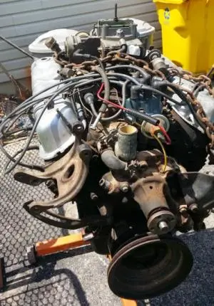

I got an engine and I got it running! Now it is time for the install. I know the motor mounts are specific but what about the frame mounts? There is a chance I might be able to get some v8 mounts here shortly. How different are the v6 FRAME mounts than the v8 frame mounts? Also I am going with a 157t bell housing. I know firewall modification will be necessary but will that effect the drive shaft length? One last question. I have a regular front sump oil pan, can I modify that to fit right? I herd some where I need to take the space before the sump in like an inch. These should be my last questions... hopefully.
Thanks for any information!

Anyway, to answer your questions to the best of my ability, I believe the V8 frame mounts are different than the V6 frame mounts. I don't know from experience about the V6, but years ago I did a V8 swap in a 4 cylinder car and they were indeed different. Maybe someone else can elaborate/confirm.
Drive shaft length will be determined by the distance of the tail shaft to the differential. So, it depends on where your tail shaft lands compared to the original tranny in the car. Comparing an auto vs manual V8 drive shaft, there is about an inch or so difference between the 2. I would imagine there might be a slight difference with a V6-V8 swap.
The oil pan discussion has been discussed recently, but I think you can modify it to work just fine, or shim the engine up at the motor mounts, provided you can get that issue sorted. Shimming the engine up would probably add to your firewall modifications? If that were so, I guess it would be 6 of one or half a dozen of the other to which direction you would want to go.
Good call with the famous last words. Hahaha. I did some measurements and it looks like the bell housing are very close to each other. Thanks for the information. When (if) I get the engine in there I will post some pictures! Thanks again!
