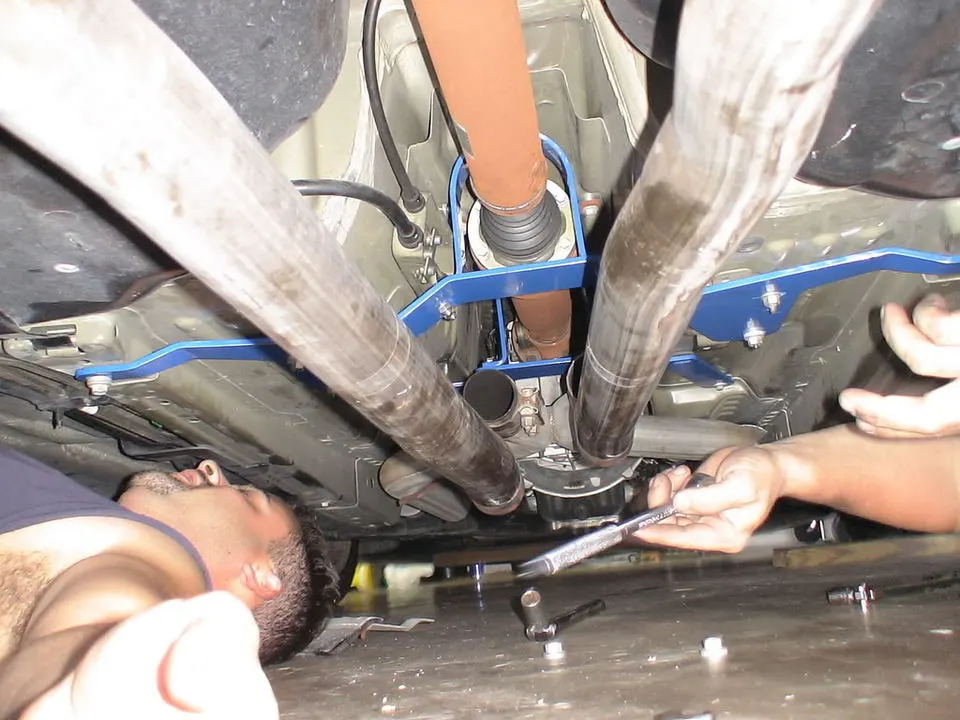

I'm leaning towards the granatelli kit right now, cuz for Front and Rear its only 180 and the design looks old school as it should not cause any rubbing or banging also a local guy sent me pictures of his setup and he says it does not bang or rub.
I would never buy another GMS product personally. Too many bad experiences out there. Also, is it just me, or is that rear loop really far forward? That'd be fine for a 1 piece, but it doesn't look like it would do a whole lot of good for the back half of the shaft anyway.
