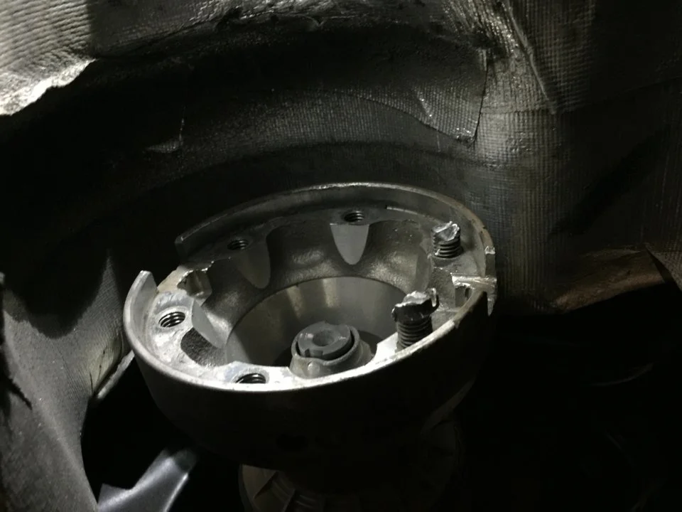

I finally got the DSS mounting ring off the flange. I went through 6 cutting wheels. I tried to use vice grips to get the bolts out but the heads sheared off. I'm considering trying some type of easy out and a tap. I've also called Ford to get an estimate on replacing the flange. (probably won't be cheap since I believe they will pull the pumpkin out of the car).

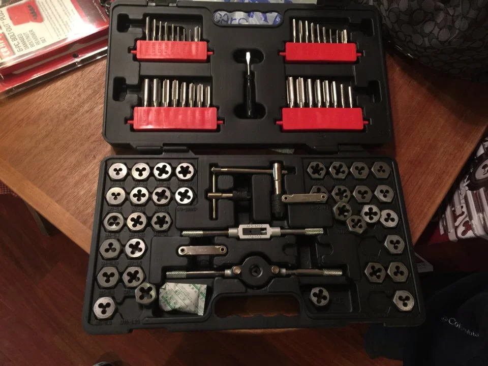

@84Ttop I've never used a tap set. Any advice?
Not yet I was in a wedding on Sat. I'm pretty sore from the dance floor. I might try to get to get out there today but I doubt I'll be able to.
Lubricate the tap with oil and ensure its straight. You may need to work it back and forth to straighten a really marred set of threads out
GREAT NEWS! The Mustang is fixed! Ramsey's was able to turn the car around in a couple of hours. They cut the bolts flush with the flange and were able to drill them out!. The best part is the new 4" driveshaft doesn't seem to have any vibration that I can feel as of yet.
