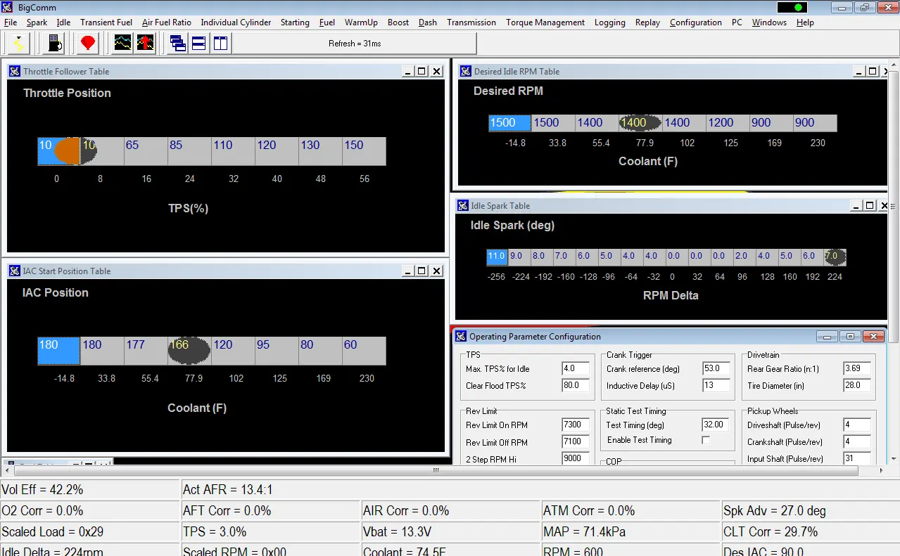

So, this is what I'm currently trying to figure out:
That "desired RPM table" is your warm up table to help with cold idle. I've been dinking around with the cold idle trying to get it working right. In this snap shot, the car was surging a bit, but I have been able to get a smooth cold idle at around 900 RPM. What's weird is that I don't think the IAC is working. So, it won't bring the RPM up to what's desired. The "max TPS % for idle" should be 2-3% higher than idle TPS. Here, after adjusting the screw to set warm idle, my idle TPS is 3.0% and I need to adjust the Max TPS for idle up to at least 5%. I understand that if these numbers aren't set correctly, then none of the idle tables will work. This may be the problem I'm having with the IAC, but I don't think so, because it wasn't working when the idle TPS was only 2%. Tomorrow, I'll try bumping it up to 6% to see if that makes any difference.
Another peculiarity to me: the bubble in the idle spark table should be on the far left at an RPM Delta of -256 or less, where it would advance the timing by 11 degrees and try to bring it back up. For whatever reason, it's actually on the far right, where it would normally retard timing, and I'm not really sure why. However, cold idle timing (bottom-left most cell in the main spark table) is set at 27 degrees, and the "Idle spark" doesn't seem to be affecting that. I haven't noticed if the idle spark table works correctly once the car warms up, because it idles right where it should, and the RPM Delta goes to 0. I might play around with the throttle blade adjustment screw later to test it when I have less pressing concerns.
This looks very similar to tuner studio.
Are you sure you don't need to denote an - before the numbers in the positive rpm delta range? The way you have it set it looks like you are increasing timing there.
Another oddity the delta rpm should follow the commanded rpm/clt temp so at 900rpm you should have a -500rpm delta and increase timing to bring idle speed up.
Imho your closed loop idle activation settings may be incorrect this will cause the system to run in warm-up mode (table driven idle no automatic correction)
Can you post up those tables? Maybe I can help there, also what Hz are you commanding the idle valve at? Bosch valves like ours run best at 98-150hz above this they get much less accurate.
Your valve polarity may also be wrong, should be a setting for this it may be commanding it to open but driving it closed.
I am sure. I have been over and over this table due to this discrepancy. Like you, I do not agree with the say he programmed it, and I would prefer to see "-" signs for the timing on the right side of the table. However, the instruction manual is explicit in the fact that the table will retard timing on the right side and a negative sign is not necessary. In fact, I tried putting one in just to see if I could force a timing adjustment and it would not accept a negative.
I agree. Totally confused on why it's doing this. However, as mentioned, it is not actually having an impact on timing. My main spark table calls for 27* and in the dashboard at the bottom of the pic, you can see that's exactly what it's getting.
Imho your closed loop idle activation settings may be incorrect this will cause the system to run in warm-up mode (table driven idle no automatic correction) Can you post up those tables?
That could be true. I believe the closed loop activation is commanded above 1200 and off below 1100, IIRC. I'll check it out when I get home, today. That would be below the commanded/desired idle RPM. I think I'd prefer not to run closed loop at idle, since I'm paying so much attention to setting the tune there manually.
I'm a little confused about your question. I do not recall a Hz setting in any of the tables. To what Bosch valves are you referring? Are we talking about the IAC?
The closed loop settings I am referring to are for idle control, not ego. You want the idle to be closed loop or none of the aforementioned table will do squat.
You may not have a Hz selection option for the idle valve, i do. I have not used bs3 so I am using terms and settings I am accustomed to.
Hmm... Ok. I'll take a few screen shots with all of the idle tables so you can see what I'm working with. I don't think there's a separate closed loop setting for idle. I assume ego is exhaust gas oxygen fuel trimming, but I think that's the only closed loop setting I have. That's still a good idea to play with and might have something to do with this situation.
