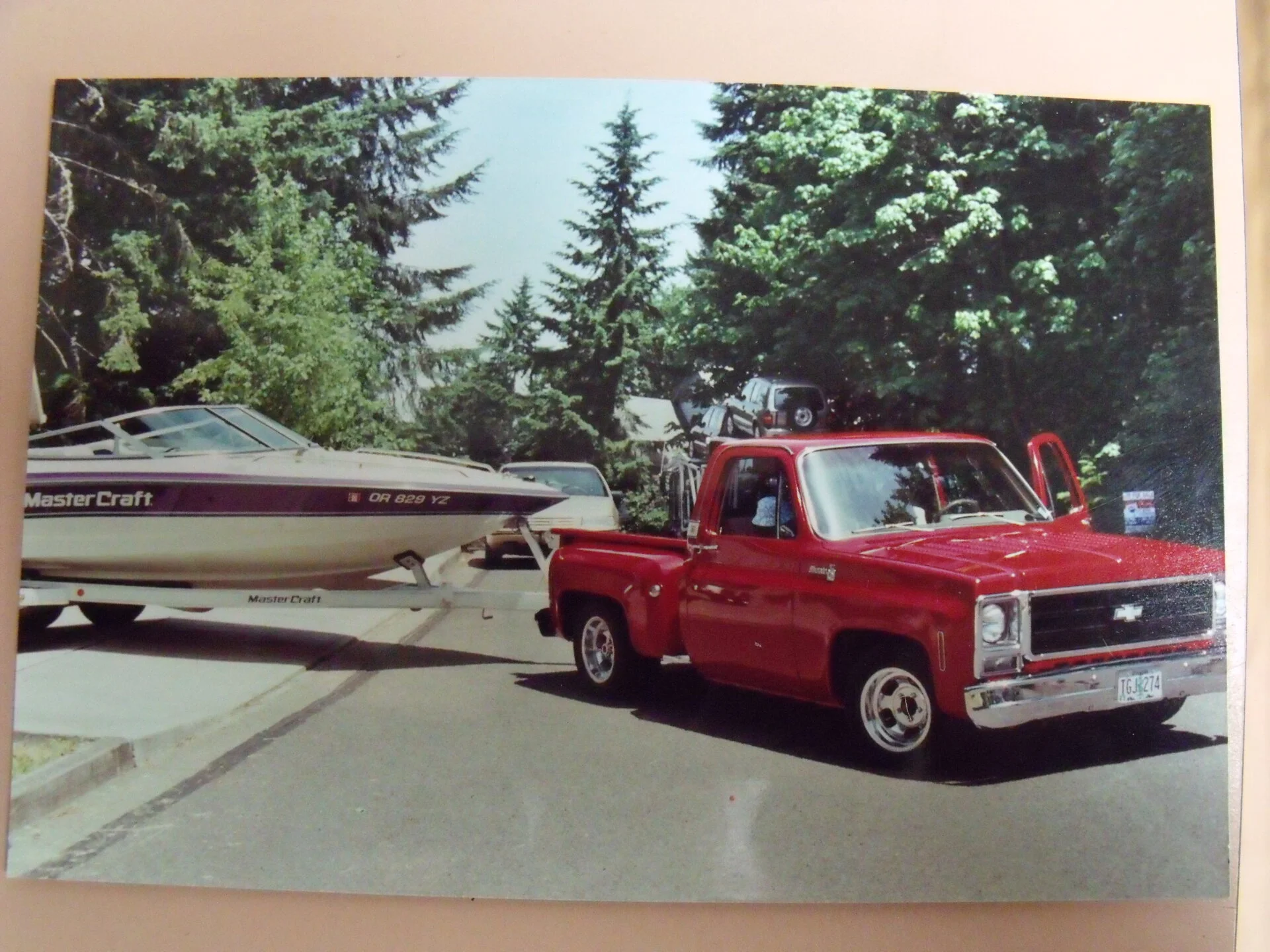

I installed a Dutchman bolt in 9" rear on my 77 chevy step side low rider after not being able to find parts for the rear in it.. I know this is apples and oranges somewhat, but it was one of the best things I did for my "boat puller" years ago.....
