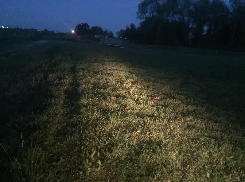

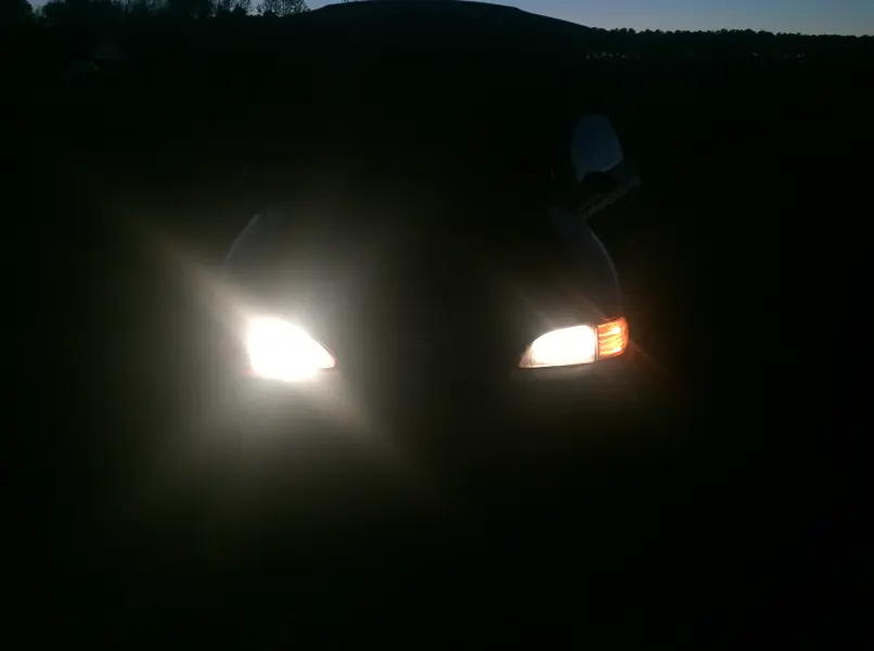

So this has been going on for awhile, this car hasn't been moved much until just recently. Basically the driver side light looks like something is in the way not letting all the light out.
I've tried new bulbs, checking the ground, and making sure they have the same voltage on both sides.
So far nothing so i think it has something to do with the housing. IT has water in it so it is leaky. Would that be why it is so dim, or could something else be wrong inside the light assembly?
Here are some pics of the lights and the beams.

Show a pic up close in daylight, if the moisture is minimal and it has not started turning black inside pop that thing out, if it's not cracked anyplace take some clear silicon and run it around the edge where the two pieces come together and polish up the lens and see if that helps keep moisture out, replacements are not expensive and sn members get a discount from lmr.
It's pretty bad, imma replace it later on. Not really that important since it won't be driven during night.
