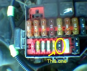

I see you posted in several different sections (I already replied in the 94/95 section). What year stang do you have? This might make a difference, although I'm not sure. Anyway, on the 94/95's at least, the driver's seat and the power point (cig. lighter) are powered by the same fuse. It's the green 30 amp fuse in the engine bay fuse box. You can see it in the pic, first row, 3rd from the bottom.

Thanks for the reply. It's 94 GT. I'm a little confused about which fuse that is, maybe because of the orientation of the picture. Could possibly open that picture up in MS Paint and just put an arrow next to it or something? If not, no big deal, I'll just look for the green fuse with a 30 on it, yea?
Oh, are there spares in the fusebox or should I just head straight to Kragen for these?

Here ya go, updated pic. And you might wanna go to a store to get some fuses (most parts stores have a box with an assortment of common fuses). If you're like me, you've already used all the replacements, lol.

Many thanks, seems to be fixed now. There was a 20 amp fuse where the 30 should have been, and it was blown anyway. Also, I did blow the first fuse in like 30 seconds after playing with the seat adjustment. I replaced it with another and it seems to be working for now. At least I was able to adjust the seat to a better position. Is there a common problem with these power seats causing blown fuses?
