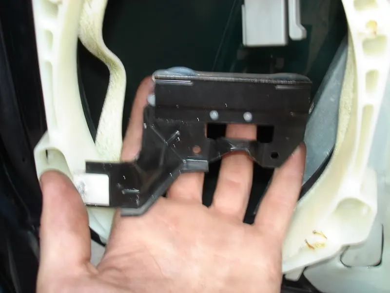

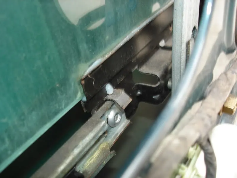

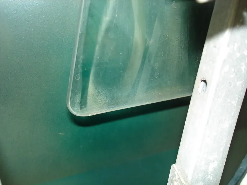

If you take the door panel off, there's some adjustable bump stops for the window that you should be able to adjust, to stop the upward travel. If it's aftermarket glass in the door, it might not fit the same as the factory stuff. I've had a similar issue with my passenger side door for years, since some douchebag decided to break out my window. I've adjusted it as best I can, but might end up taking it in to get fixed properly someday. It only cost me like $115 for the new glass installed, so the adjustment shouldn't be anywhere near that price.
I had the same problem one of the stop (black plastic clip) came unglued, it should be at the bottom of the door. just put silicon sealant on the clip and hold it on for a while so it can tack up then let it harden some, problem fixed
