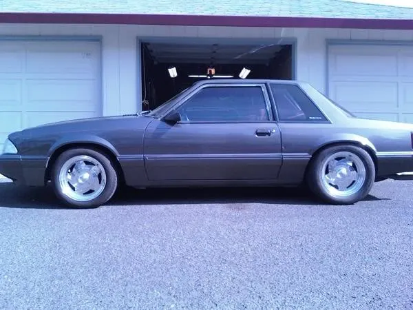

Heres my yearly driver.No studs no chains no nothing.Front tires are yokes 225/50/16 amd rears are also yokes and are 255/50/16.Last year since i got high centered is all that stopped me from going anywhere! peace
john:p
