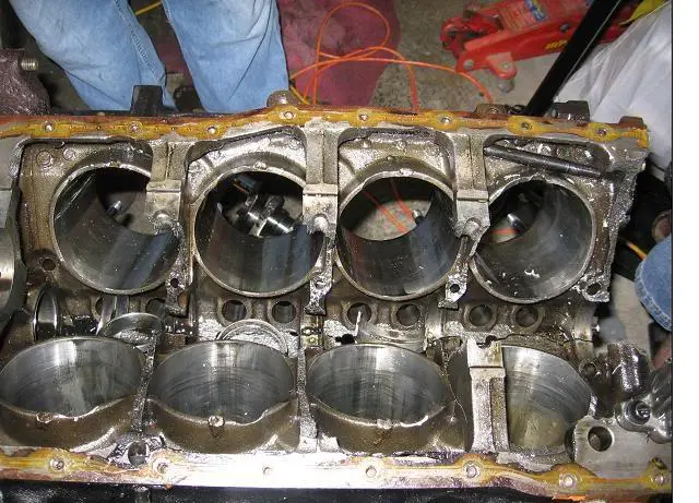

This was in my father's road race Panoz with a DSS 347 with a stud girdle, road race build, AFR 165s, custom cam, Edelbrock Performer RPM Air gap, Pro-Systems carb etc. Made 370+ rwhp. Never ran right all last year; never made it through a full track weekend without some sort of problem. Finally :poo: the bed this February at VIR on the back straight at the top of 4th. No warning, no issues with oil pressure. Started ticking last fall, but the shop who built the motor swore it was a lazy lifter. I felt it was rod knock. Upon tear down all the lifters looked fine, but the rest sure didn't...
Supposed lazy lifter...
Before...
After... Snap goes the crankshaft. The mains are all intact, rods banged up but all intact as well.

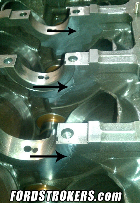

Scat makes good stuff. Not saying their stuff doesn't have flaws, but that would make me lean towards the block weakness. Ford made alot of block improvements in the mid to late 90's, Unfortunately for us fox guys, it was done in the form of the mod motor. The LS block are definetly tough.
Joe
Tell us if you see cracks between the main bores and the cam bores, and possibly all the way down the center of the intake valley. That's how the stock blocks fail, and when they do, they open up bearing clearances and things get ugly. IMHO, that crank didn't start the problem, the block did. FWIW, I split a stock 302 block in the typical fashion, but with only 260-ish RWHP, and I did it chasing down a Lotus Elise at Mid America Motorplex. All I initially noticed was a drop in oil pressure, but the other odd thing was the oil pressure gauge acted like a vacuum gauge. When I applied load, the pressure went down.
I drove it home 2.5 hours and even ran it for a few more days before figuring it was time for a rebuild. When I tore it down, the cam bearings were walking out of their bores (and getting banged up by the cam lobes), and I discovered the cracks in the block. The vaccum-gauge action of the oil pressure was because when I applied load to the block, it flexed and opened the clearances, lowering the pressure. 6000 RPM sustained is just too much for a stock block IMHO. I'm still running a stock block though, because I can rebuild it twice more for just the cost of a Dart block, and I just keep the revs under 5800.
Funny.... I can't get the cam out because one of the bearings came loose and tries to come out with the cam. I don't see any cracks from the top in the valley area, but the main webbing is completely split from the block. Is that the area you're describing between the mains and the cam bearings?
