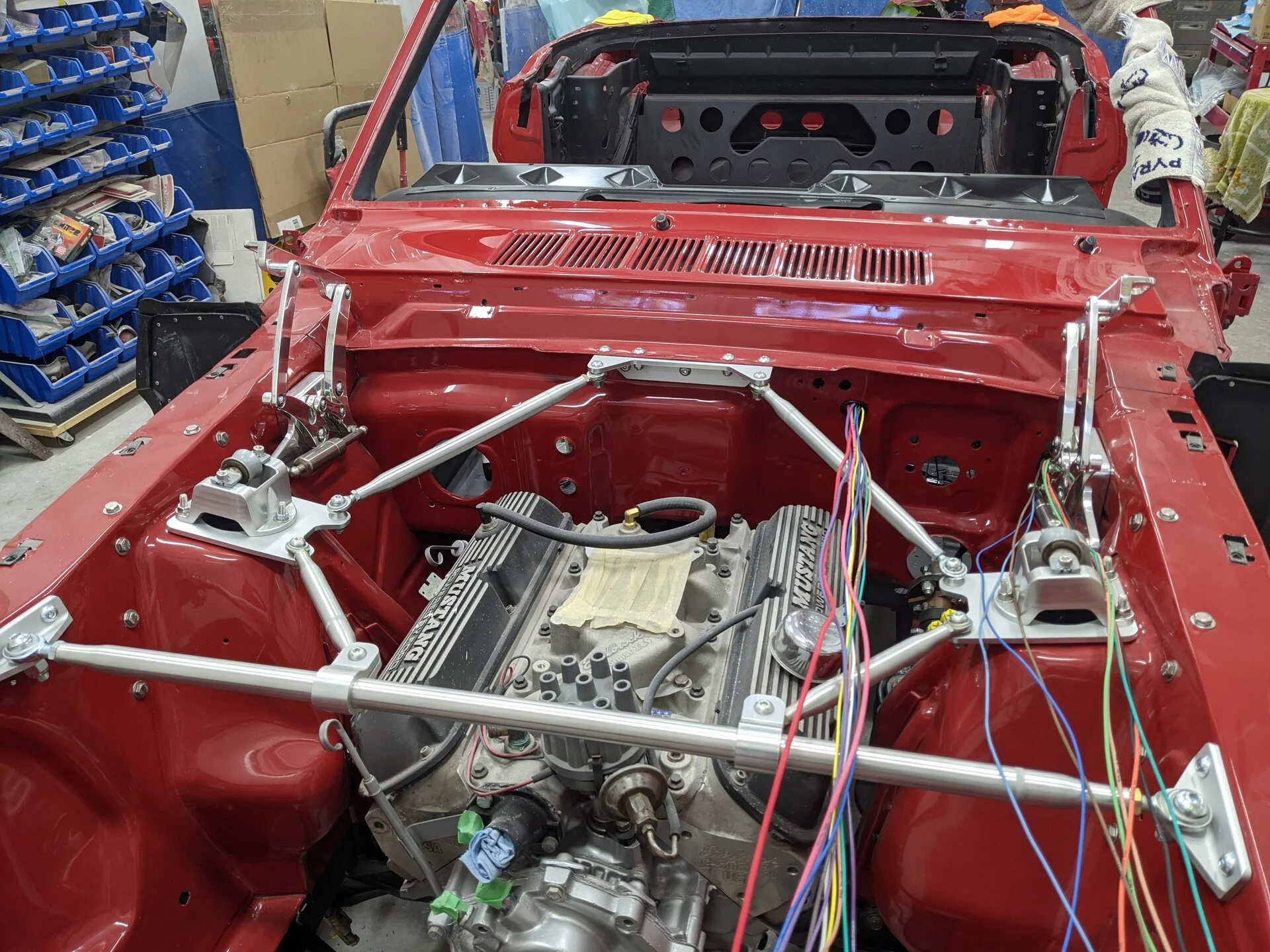

I have a 65 with stock power brakes and the Grenada front disc swap. I want to change to a dual master cylinder and would like to get one with a new booster.
I can't seem to find anything that is a power to power upgrade, just manual to power upgrade.
Any suggestions would be greatly appreciated

I'm going to stick with the stock setup for now. I'm still wiring it and have lots left to do before I can drive it. I figure it's best to do the upgrade at the end in case it needs to be sent back.
It's a restomod type build so I was looking at Willwood as they look a bit more high tech.
I can't find anything about a direct swap by anybody that's done it with the same setup as I have.
