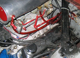

I don't know what progressive throttle linkage is. I'm sure I don't have it though. I'm attaching a picture of the linkage (well before I cleaned everything up). The fuel lines are routed a different way too.

Every Holley I've installed has had a hesitation. Usually stepping up to large squirters will fix it. I've never worked with a daul setup before. But in my Holley tuning book they recomend using a 50cc accelerator pump for automatic trannys but that's for a single carb. I would think as your using two accelerator pumps just going with larger squirters would do it.
Check to see what size squirter you have.
Or post the carb item numbers and I can look it up in my book.
It's probable around a 25 but I'm not sure with a carb of that size. My 600 came with 28 and I stepped up to 35 and it's perfect. I have a very aggressive cam and needed to go big

Bogs are almost always fomr running too lean. In your case, I'd bet the problem is too little of an accel pump shot. Your carbs are a long way from the motor and it takes a pretty big shot of gas to get things rolling. I have a low-rise 2x4 manifold (the type that fits under the hood)with a pair of 390cfm carbs and the throttle response is immediate, even with straight linkage. BTW, by straight linkage, I mean both carbs are opened at the same time. One thing you need to be aware of is Holley offers some pretty neat stuff that helps the driveablity of 2x4 setups. For instance, Holley offers a kit that ties the secondary vacuum pots together with a vaccuum hose so they open and close together. Also, you may want to go up to the next stiffer spring on the secondary canister to keep it closed a bit longer. Finally, try to adjust your carbs with a vacuum gauge attached to the vacuum port at the front passenger side of the base. I disconnect the linkage, then attach a pair of vaccum gauges, then adjust the idle speed screws until the idle is at the right RPM, and the vacuum gauges are equal. Yes, it takes a bit of fooling around, but at least you know they're right and the throttle linkage isn't affecting your settings. Good luck!
