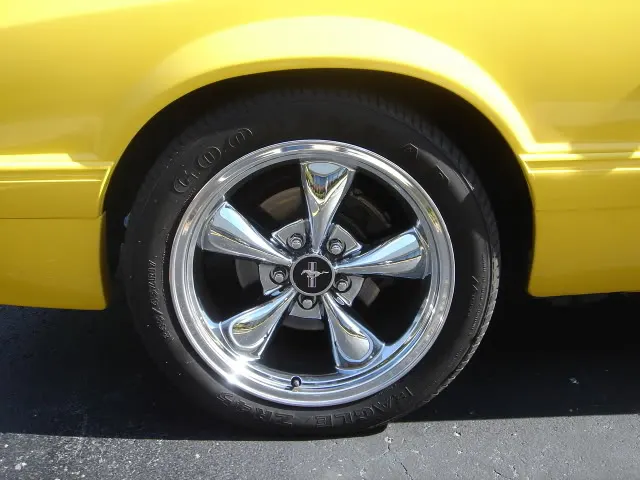

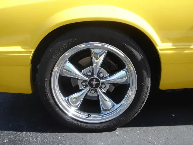

I put Wagner Ceramic Pads on "Project 81 Hack Job" (81 notch with a 2001 drivetrain). I had chrome Bullits on there. These brake pads would NOT make the wheels very dirty. After a tank of gas in the city and hell even after twelve 1/4 mile passes they has just a light coating of brake dust. They didn't even look dirty. They stopped perfect too. NO complaints.
Here's the car so you don't think being a 1981 Mustang is a POS.
Wheel is dirty in this pic. 200 mile and no cleaning.
