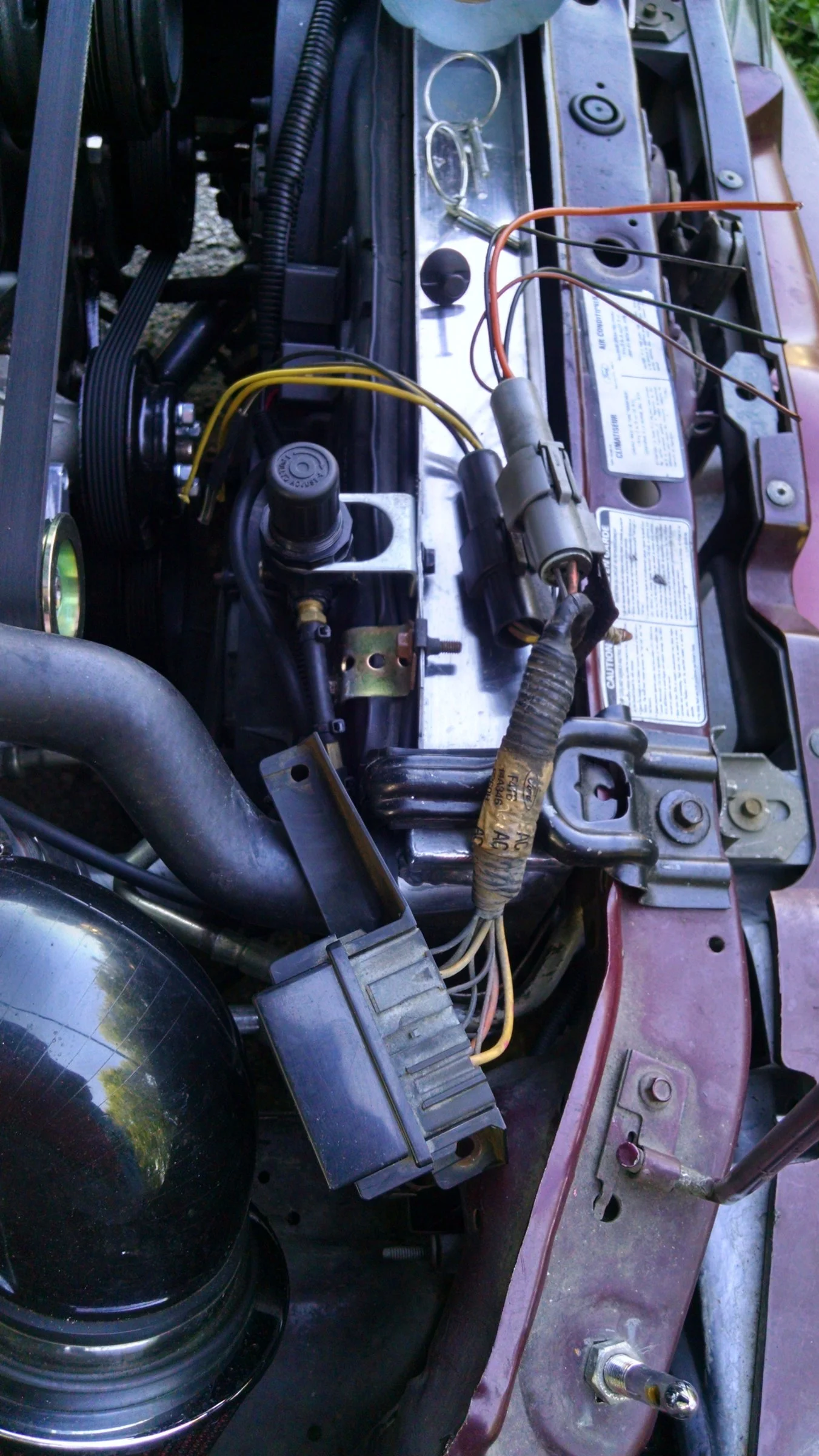

The factory relay won't work with mspnp2 without making changes. This way my AC will cut off above 85%...just like factory. No need for AC at full throttle. I can also use the ground switch to actuate various other relays I may need...:thinking::burnout:

Yeah man, me too. Guess a lot of people running this system don't have AC anyway... " race car ". Glad my diag skills are pretty good or I would've thought it was something else.
All fixed now. Still need to order a new AC cut relay. Who would think the computer would shoot out a ground signal to cut power at that relay.

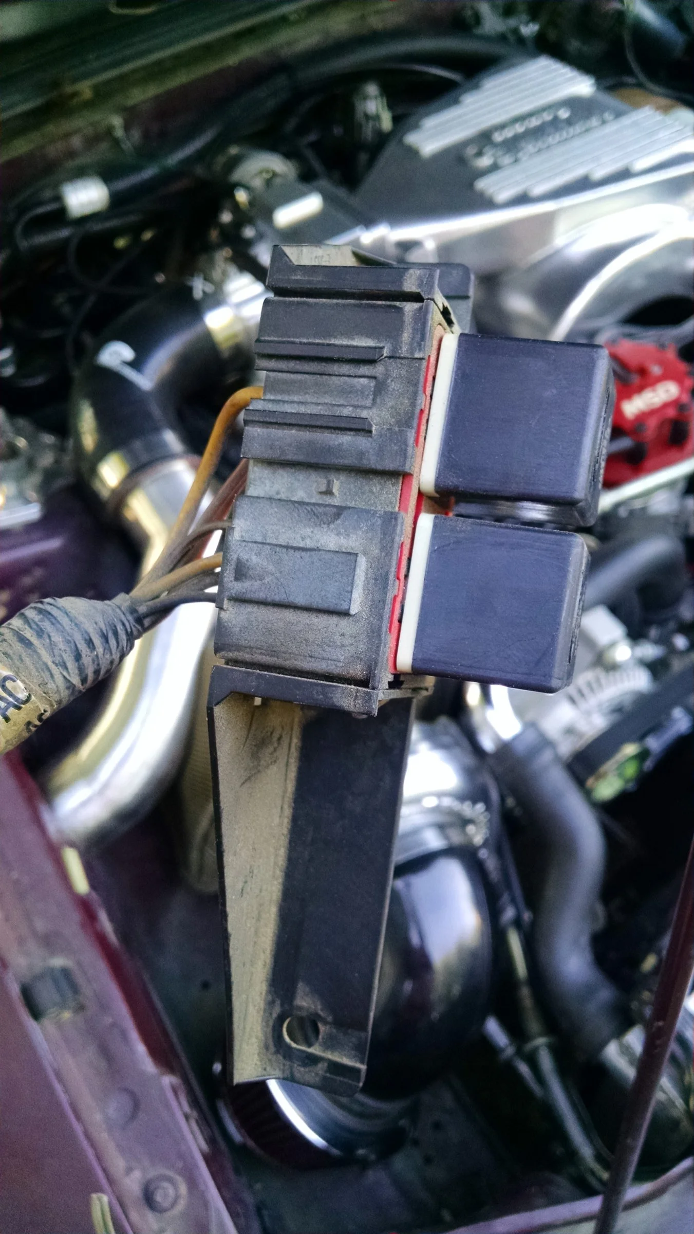

Today after another round if testing and a day off from work, I acquired one of these little things. Ford did a great job engineering this little double relay set up..
They have two separate connectors for each relay...
This thing was held in a 95 f150 by two 5.5mm screws right on the side of the fuse box.
The relays would fit perfect on the contour fan shroud or many other places. I could use them to run the high and low fans...and use one of the ones currently used for the fans to control the high speed fan for AC. The plugs would make the relays removable with the fan shroud...hmmm :thinking:

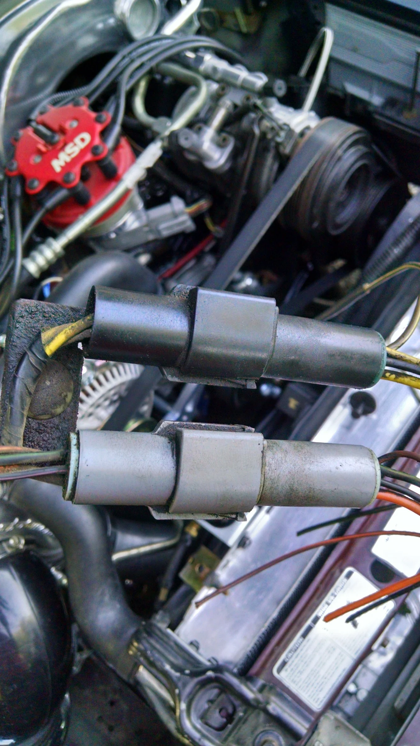

This whole time I thought I would need to wire a relay to cut the AC cooling fan on. Another case of completely over thinking things.

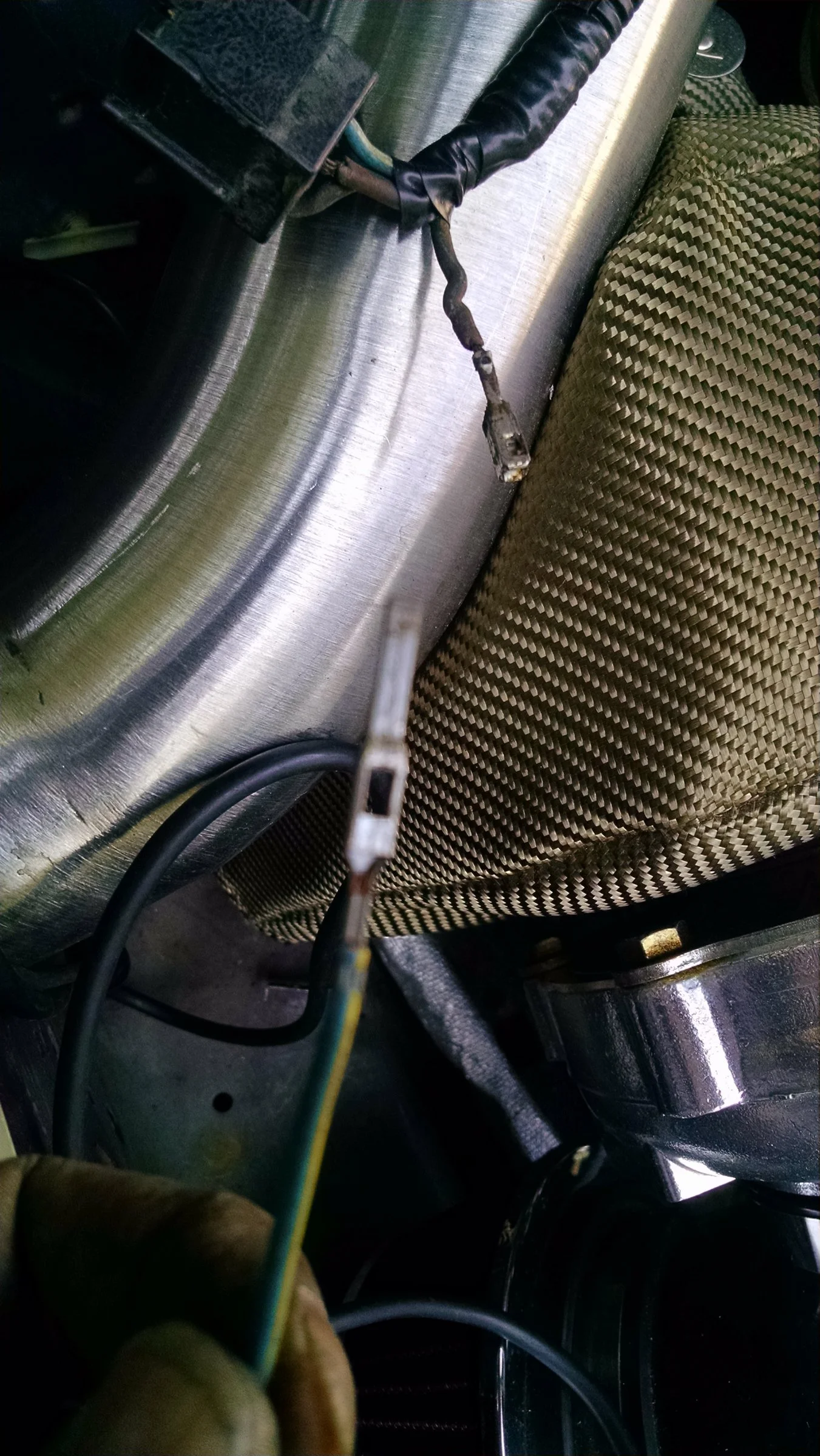

The MS puts ground to the orange and light blue wire that runs to the AC relay at the passenger fender well.
I dug through this....
Found this and de- pinned that orange/ Lt blue wire...and heat shrinked a plugged in rescued wire end. I refuse to cut a factory wire on a car unless its absolutely necessary.
Connected that wire to the ground trigger for than fans....and what do ya know.....the fans come on every time the AC is cut on.
I also found a female end that fit the relay in all that spaghetti. Plugged that in the relay, where the orange/ blue wire went , and wired to my nitrous switch. Now, the nitrous switch grounds that wire at about 85% throttle effectively cutting the AC off at WOT.
Not that I plan on running the AC doing anything but cruising. That's just similar to how the factory has it set up. Plus, I don't want to have to take my hand of the shifter just in case the need should come...:doh::burnout::nice:

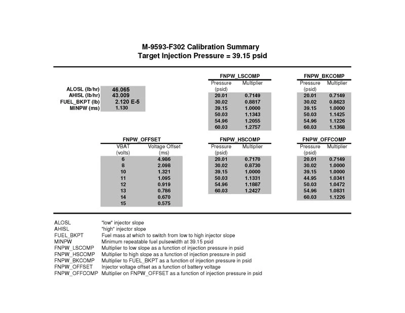

I have a suspicion about the settings we are using. However small a role they play. I want to mess with some injector settings, namely the number of squirts....
We currently have 2 alternating
I want to try 4 alternating however an incorrect dead time will affect the fuel map.

OK. I'll research the dead time and post on your MS help thread.
@a91what Here's the best Greek I could find. I have no idea if this will help....
According to this my dead time would be somewhere around 1.07?? @ 43psi. I've got to look at the formulas and do some math.
Reactions: a91what
perfect, dead time looks to be a bit above 1ms.... the voltage curve is great to have as well. ill update the info in the tune and send it your way when I have time.
