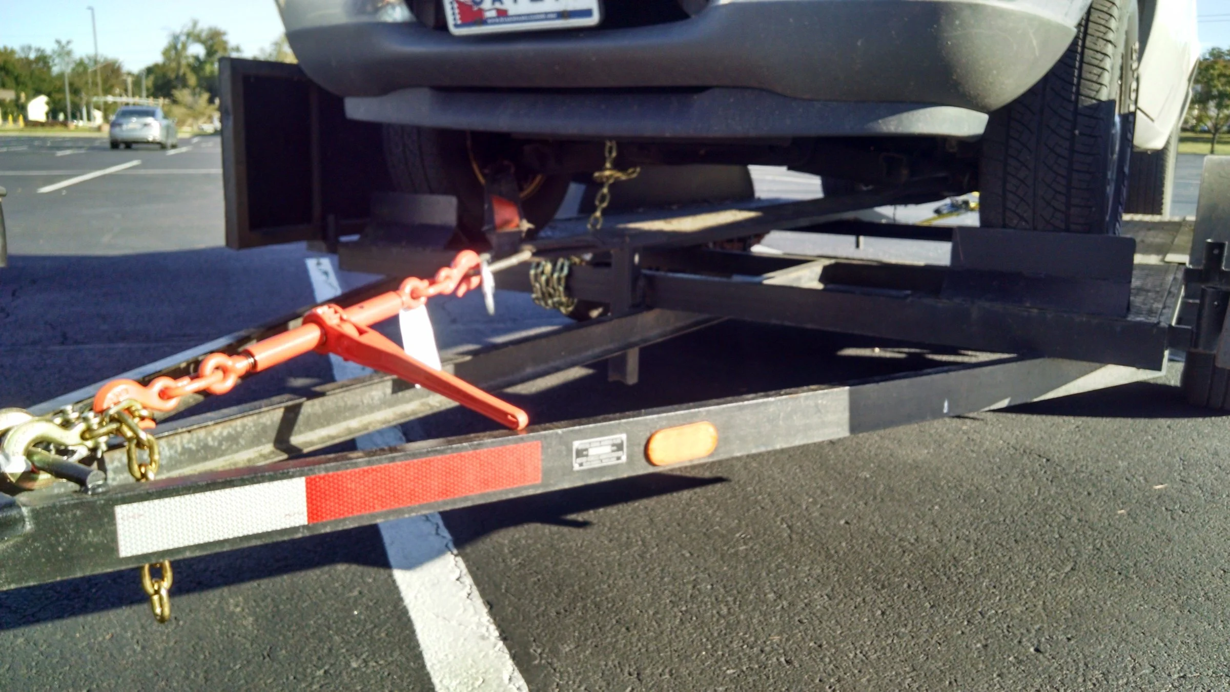

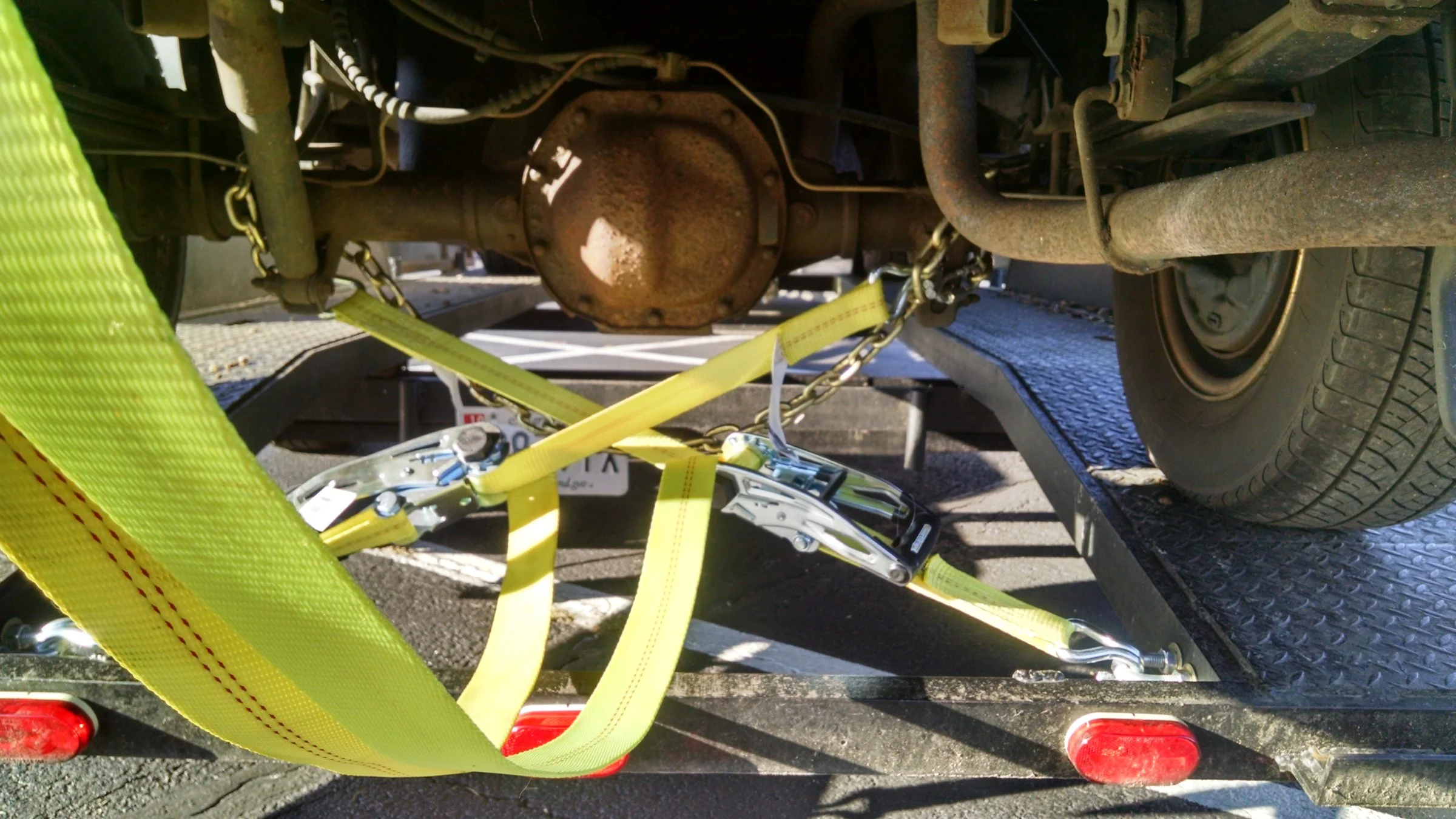

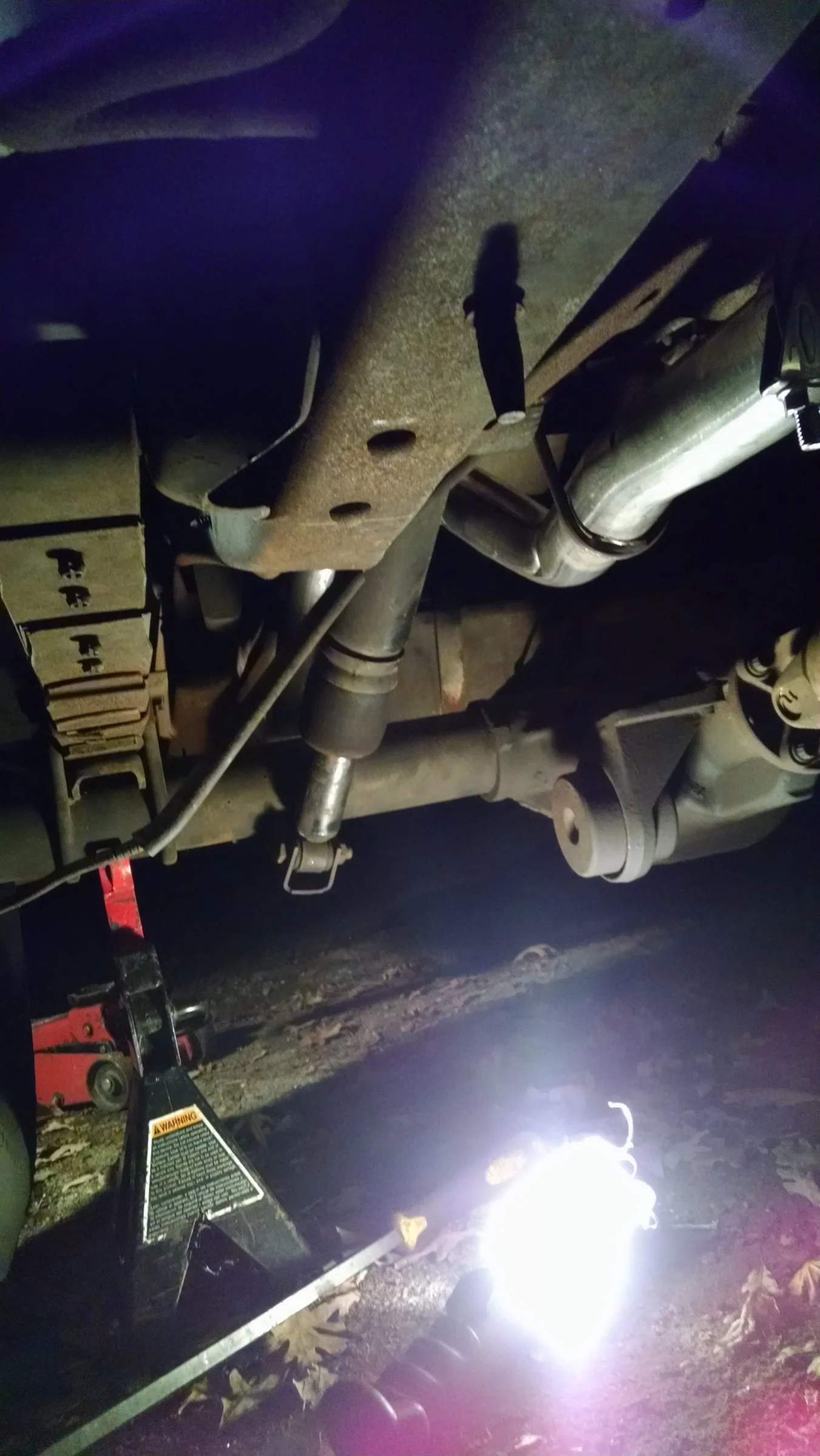

Big Poppa Smurf needed new wheel bearings, new left front caliper, and a tail pipe.....in order to pull my home made car trailer that needed straps, chains, and tie down points. It works fine for a car but the Ranger was almost hangin' of the trailer.

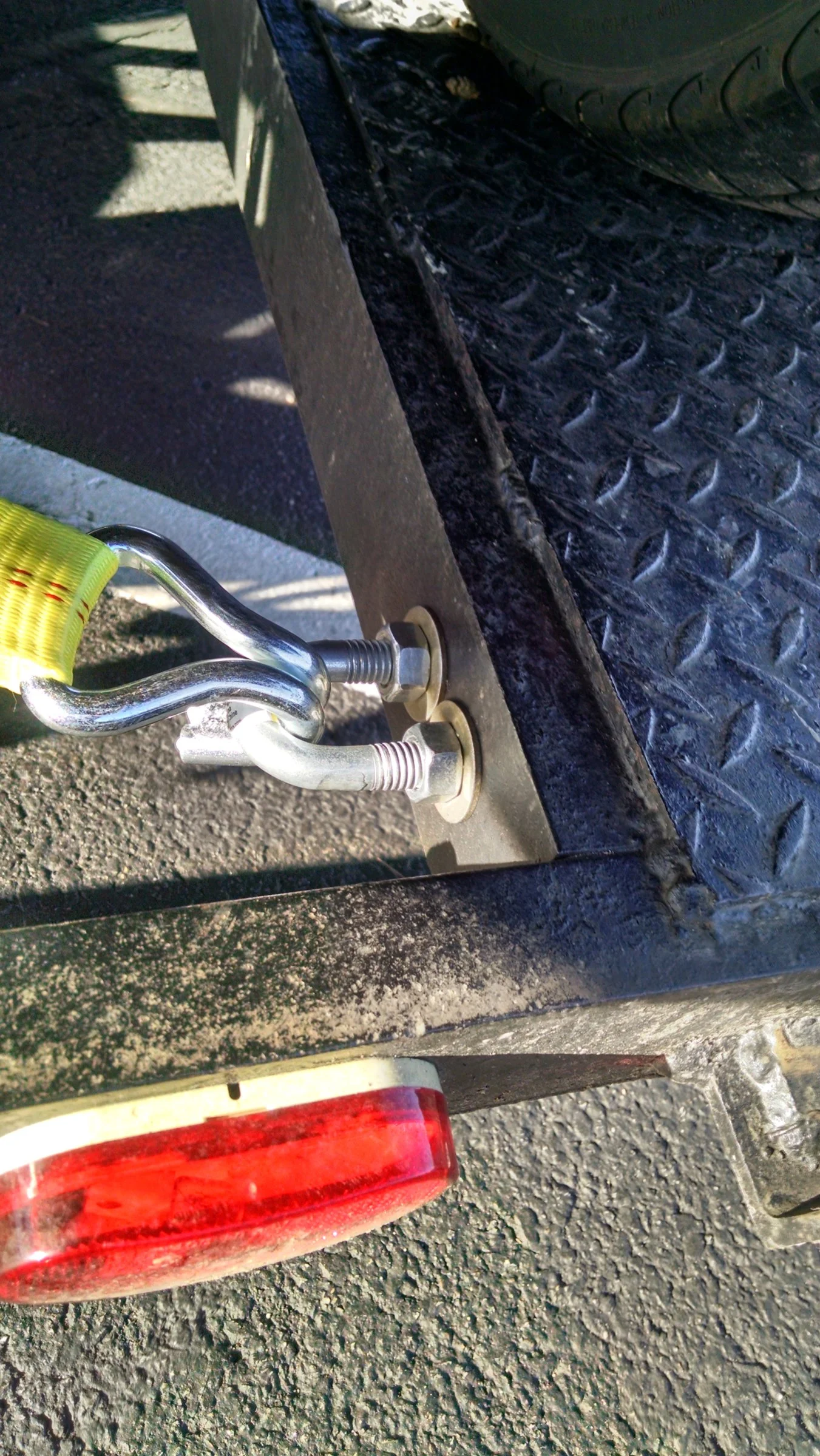

Running around looking for tie down points was a real pain. I don't like the flush mount rings with the 4 carriage bolts. I've seen them rip out unless they are welded on. The hold downs I like were too thick for my welder to weld on. ....so.... I improvised.
I bought these from Tractor Supply. These are 1/2 inch cable lugs. They don't sell threaded " U " bolts this thick. I had to buy 4...because they don't sell the right sized nuts individually. That was fine though. They only cost 3 bucks a piece.
Quick work with a center punch, drill bit, and a step bit and it was all done.

Got Big Poppa Smurf all fixed up. This is what cruising after a hill climb, pulling a trailer, gutted catalytic converter, and a little rich will do.....
All better now...

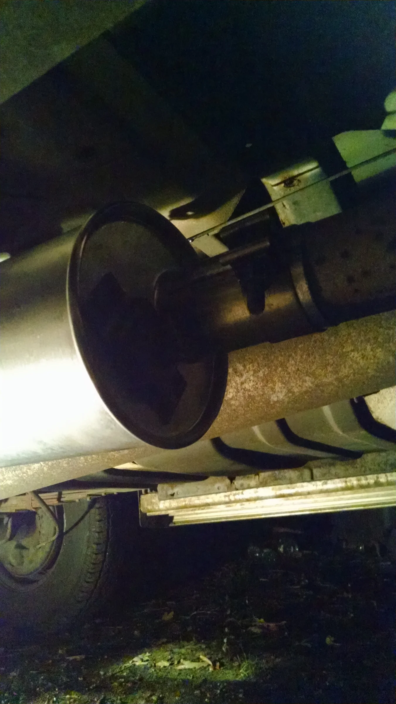

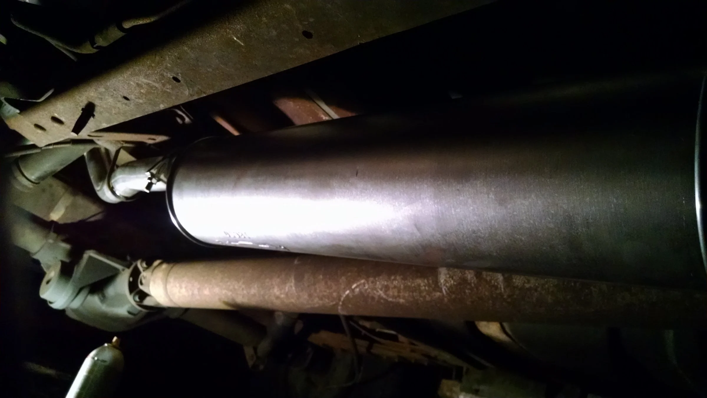

I really like this van. The muffler is in with the new tail pipe.
