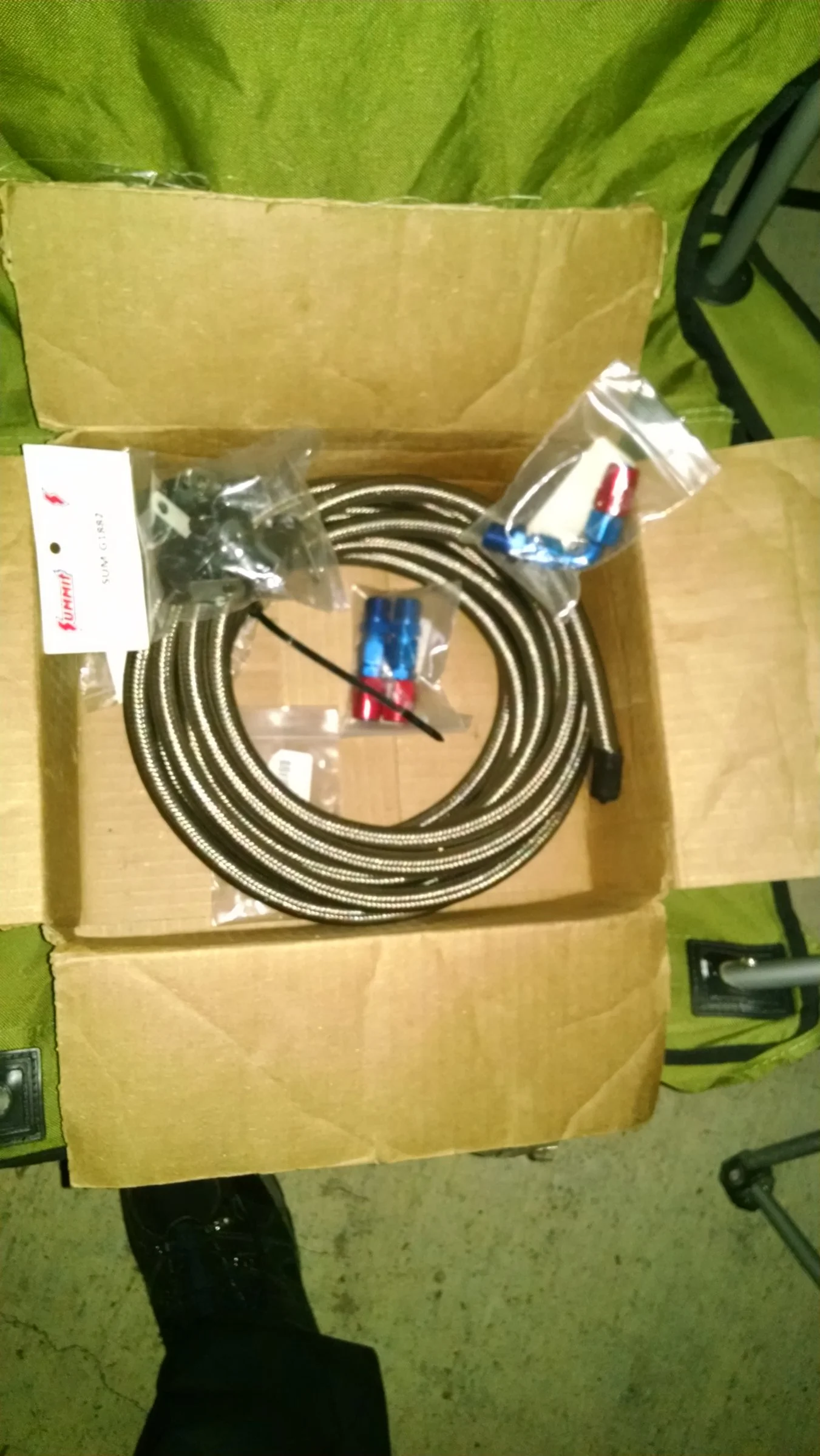

Craigslist win today. Bought these brand new line and fittings for 40 bucks....
Maybe I'll be able to upgrade the fuel lines from the tank after all.

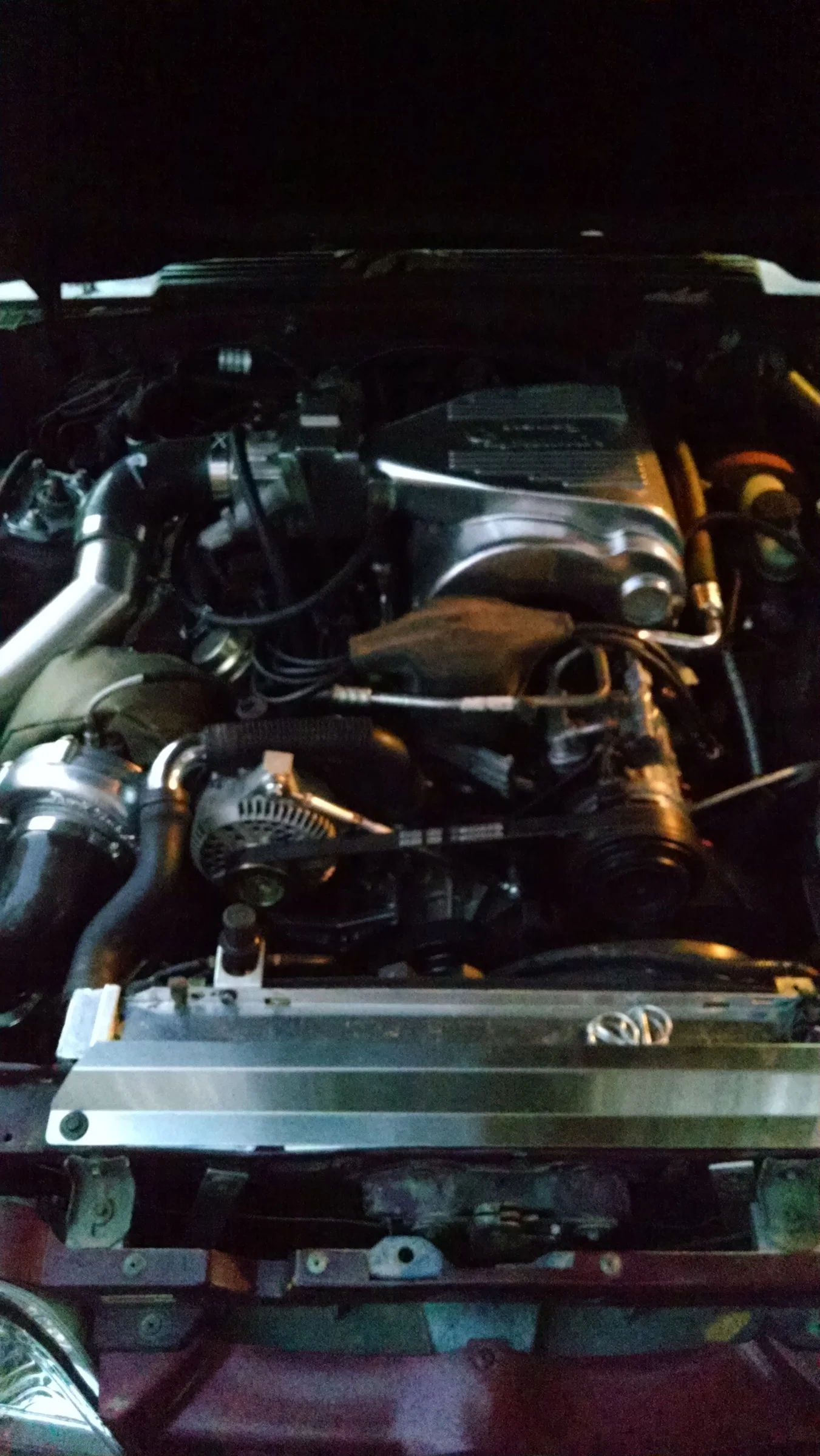

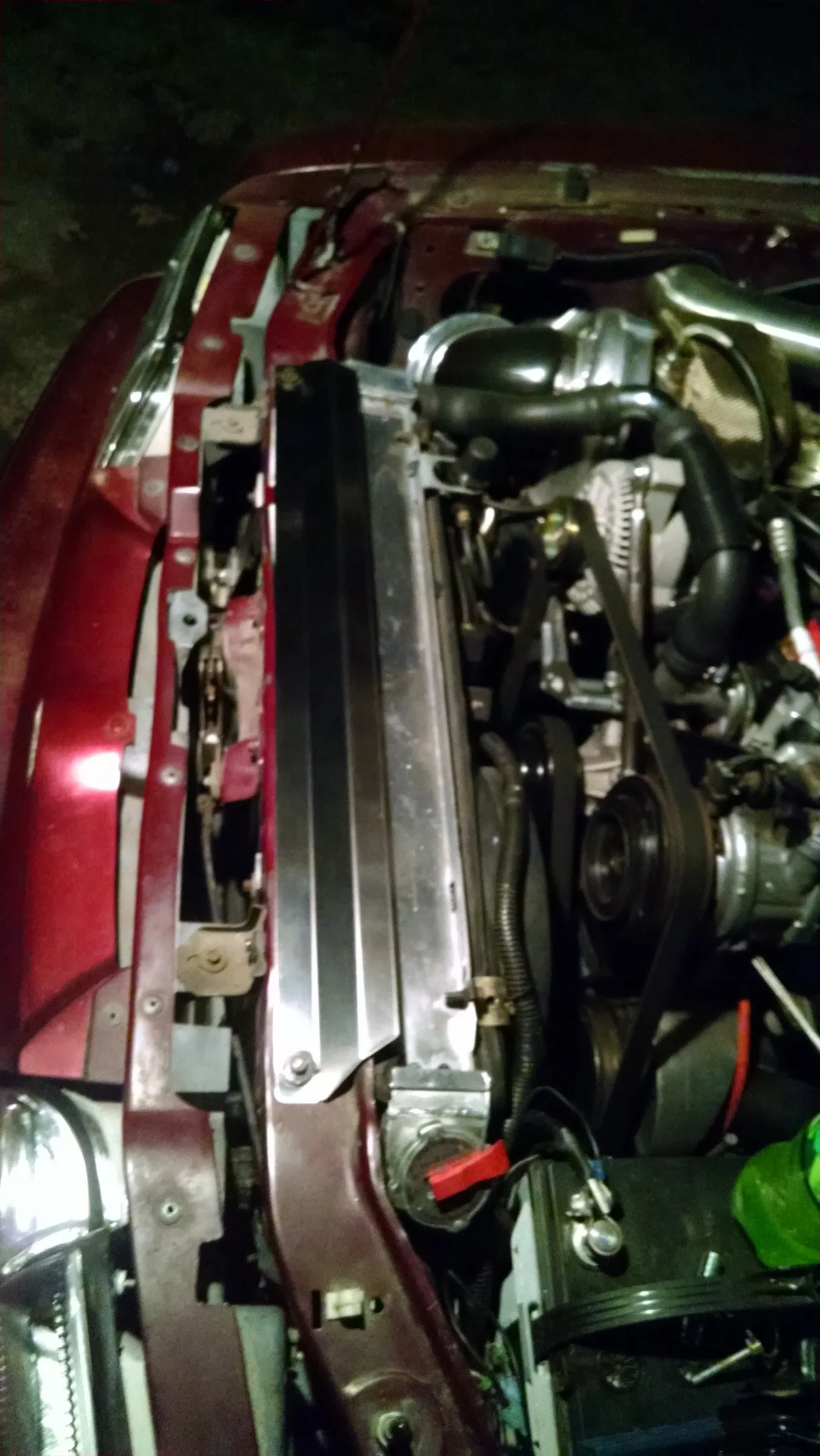

Stopped by the UPR booth and grabbed an adjustable billet shifter arm and a stainless radiator hold down. Finally, I'll be able to get the stock hold downs off Dusty for good.
Oh...and I got to see a woman going in labor with the father running around frantic trying to find a ride for her out of there. They'll never forget where she went in labor. Lol. That kid is destined for the race track and the smell of race fuel.
Lol I just painted my stock hold downs for my car. I need to get the rubber for them lmr wants your first born for those things.
My radiator is so wide I had to flatten out the metal closest yo the core support and modify the rubber inserts. I think it'll look a lot nicer now.

UPR officially sucks. They had one job...just ....one ....freakin'....job. The stainless radiator hold down had the holes drilled too wide. The bolts wouldn't go through the pre drilled holes because they were too far apart by about 1/16th of an inch. Just enough to piss me off. Luckily, I had a bit that could widen the holes up so I could get it bolted down.
Here are my old hold downs....
Here's the new shiny....

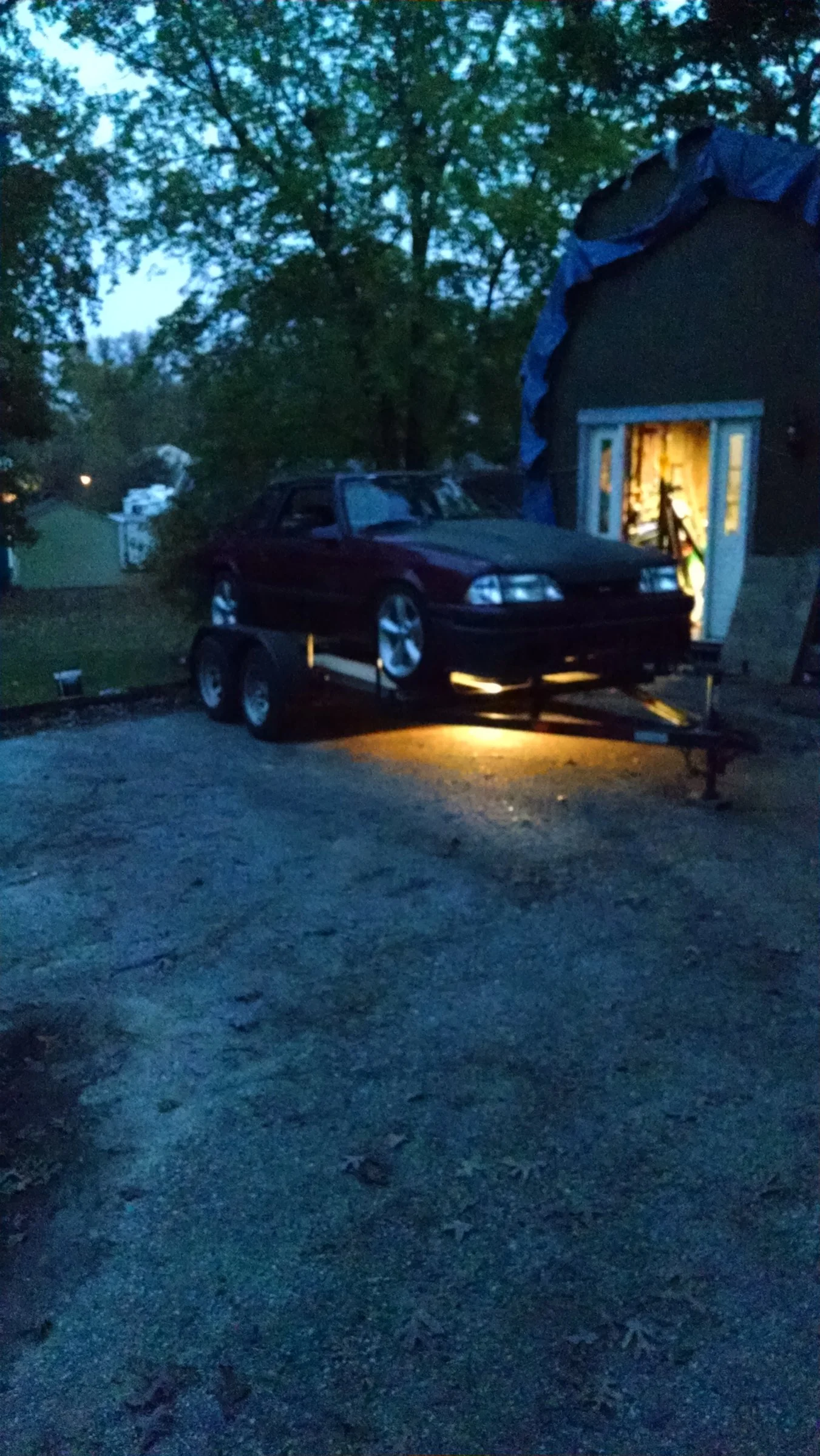

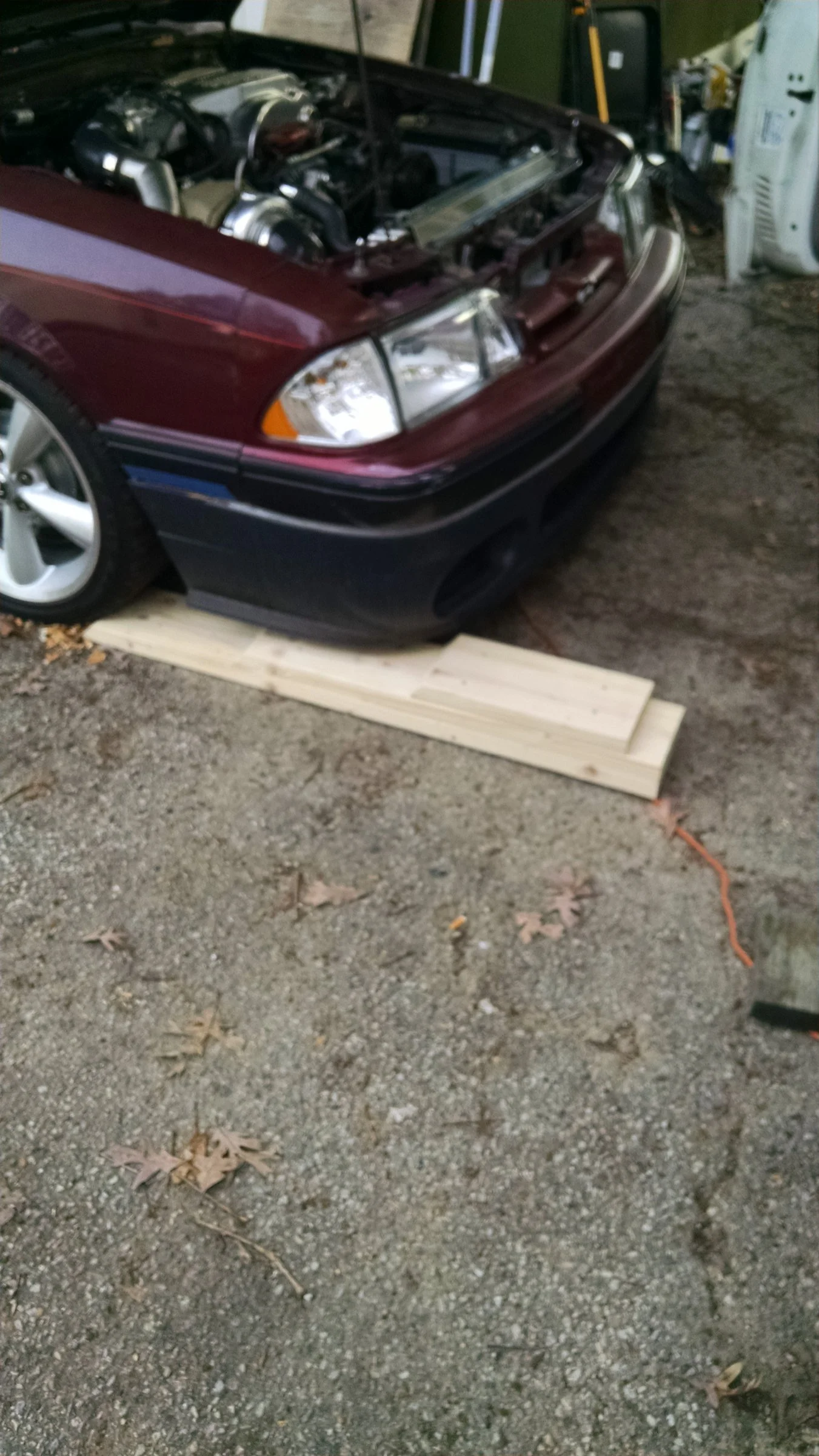

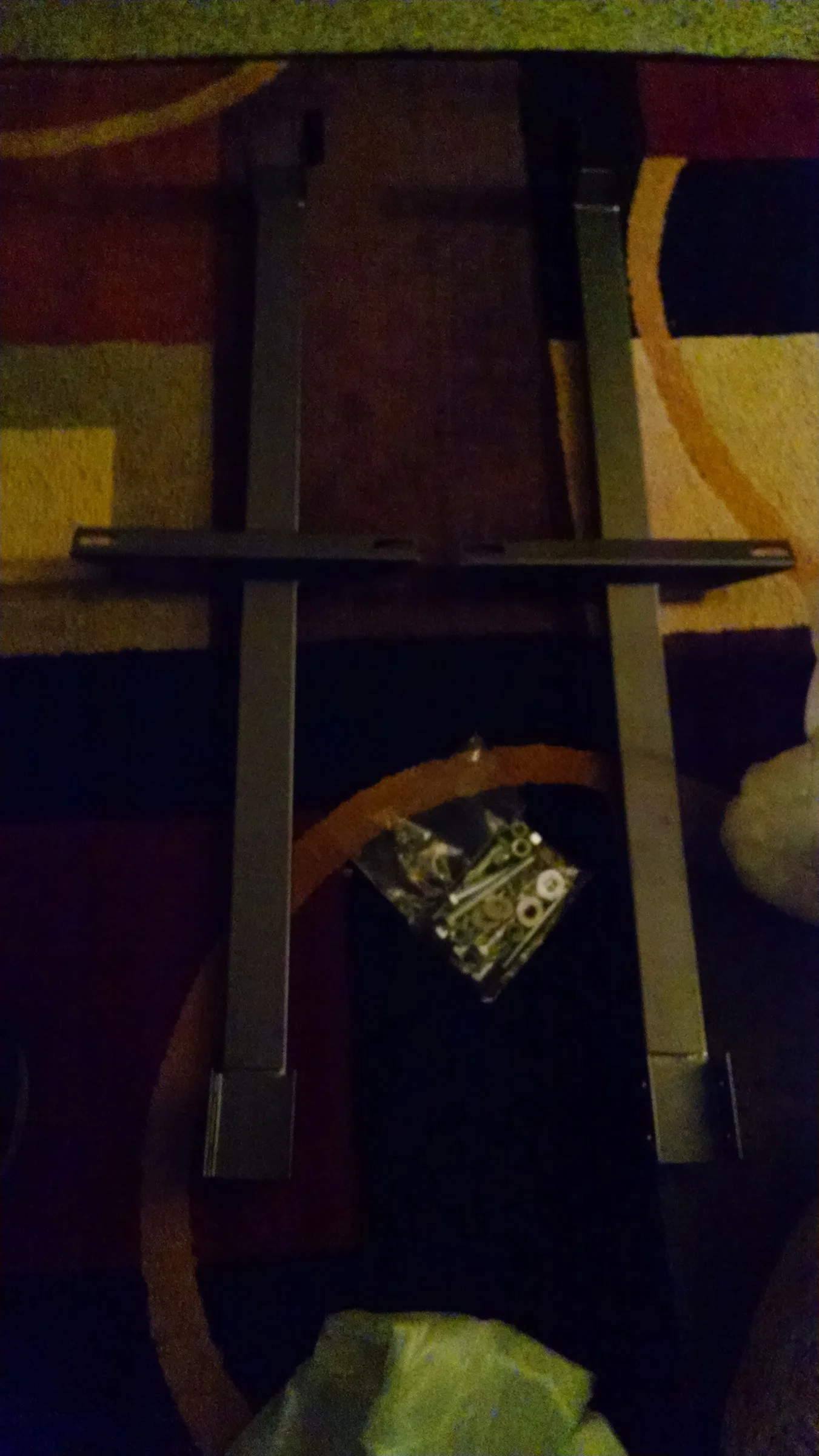

Tackled ramp extensions for my car trailer. That went OK...but I could use one more board on the bottom. The bottom lip just scrapes the trailer going on now.
That'll get done at some point tomorrow.

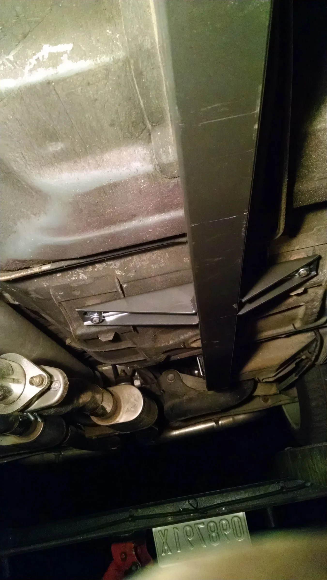

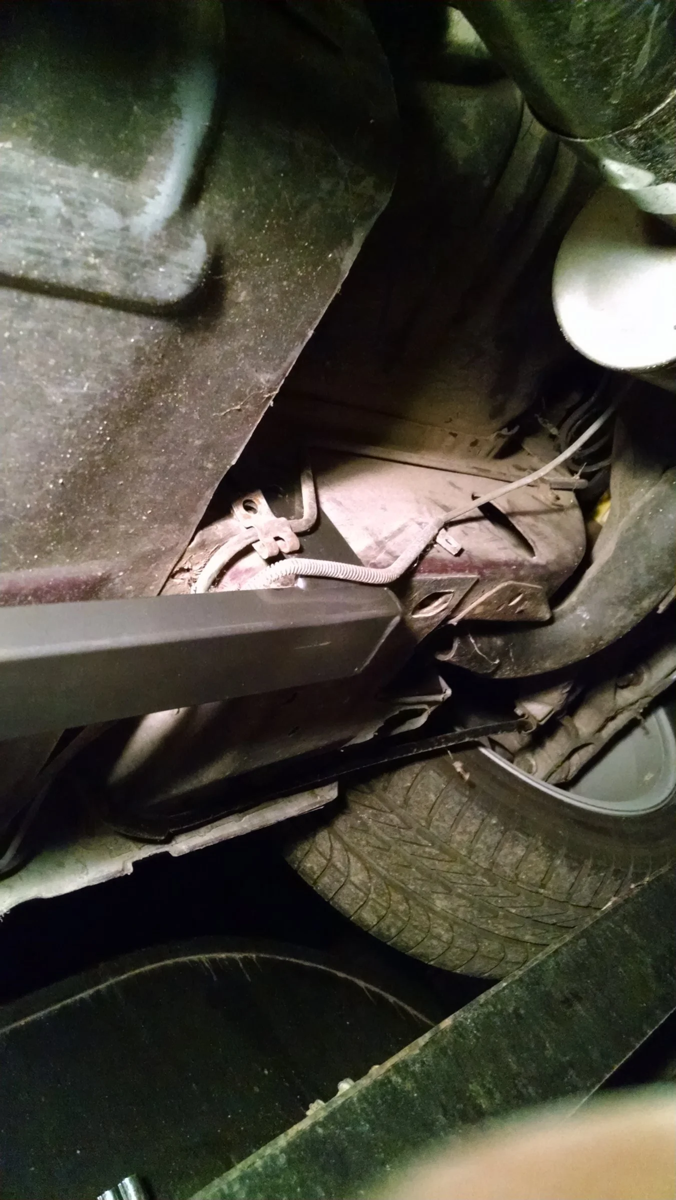

The car looked good getting ready to get the sub frames put in.
The drivers side slid right on. No issues at all.
The passenger side turned out to be a PITA. Seemed like the seat bracket was welded at a slight angle. After moving the brake line bracket and a BFH it went on and lined up...
That's it for tonite....I'm freakin' freezing...
Got the sub frames bolted up.
Just FYI there's a dang piece of metal inside the passenger front frame rail. That thing ended up being right in one of the bolt holes. I had to shove a screw driver in there and bend it out of the way. Its all bolted in, now. :banana::banana::banana:
It'll be welded in at a later date...I'm just glad its done.

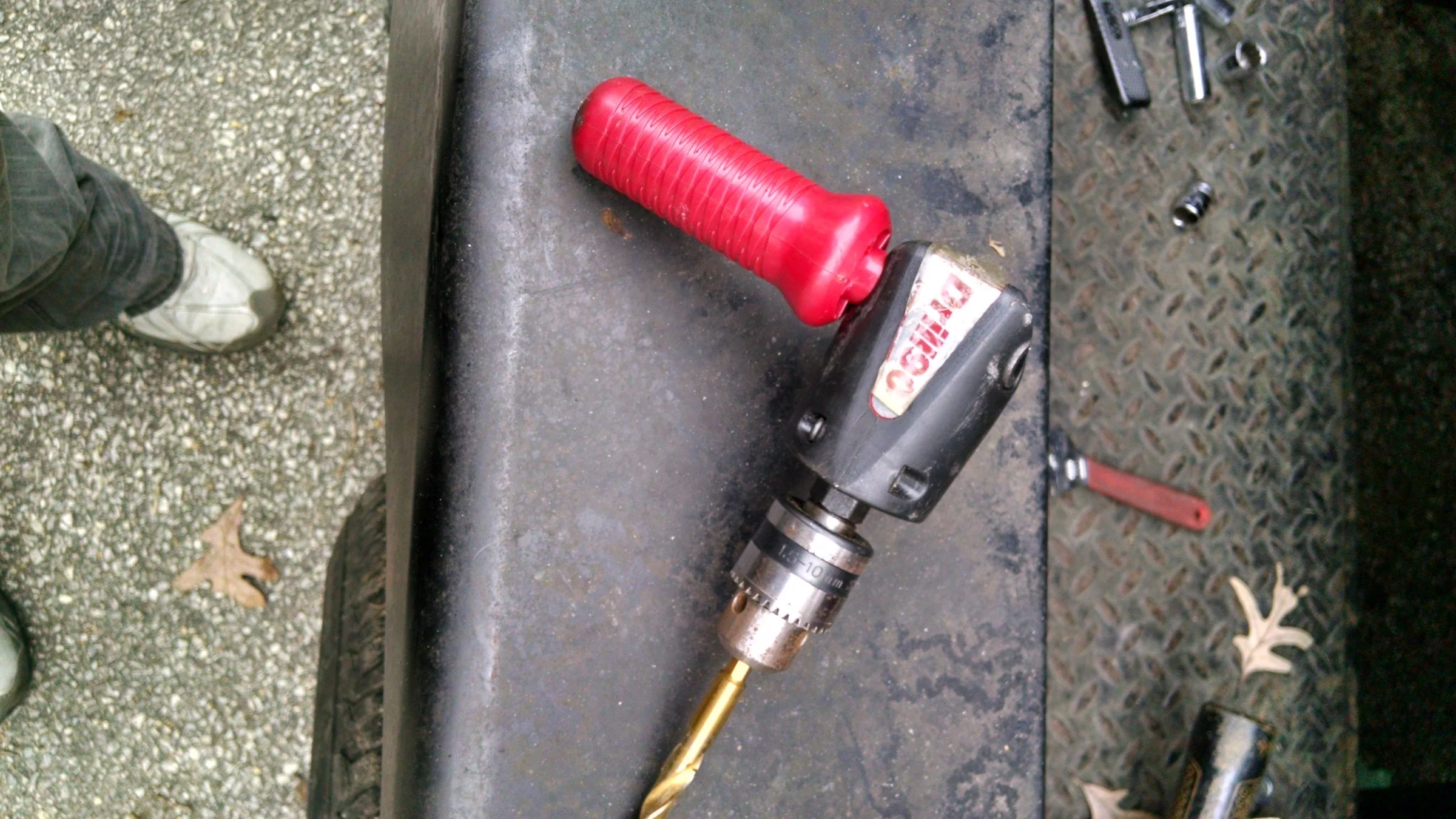

This 90° drill adapter was a life saver. I couldn't have done it without it....

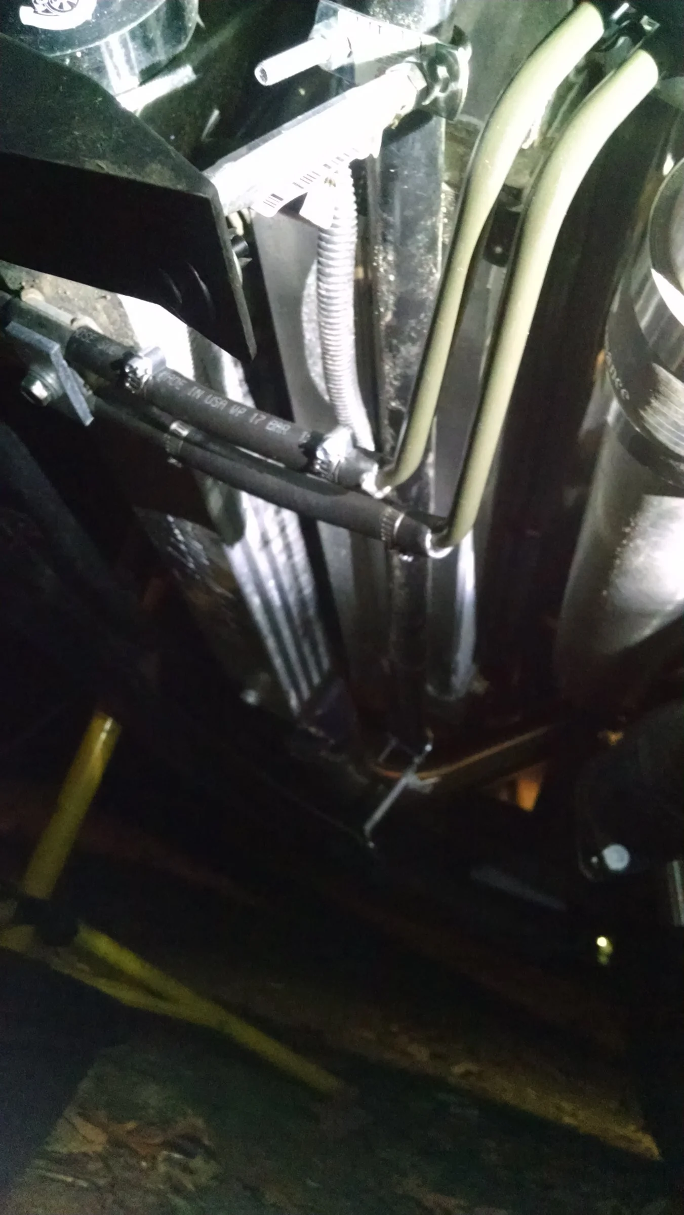

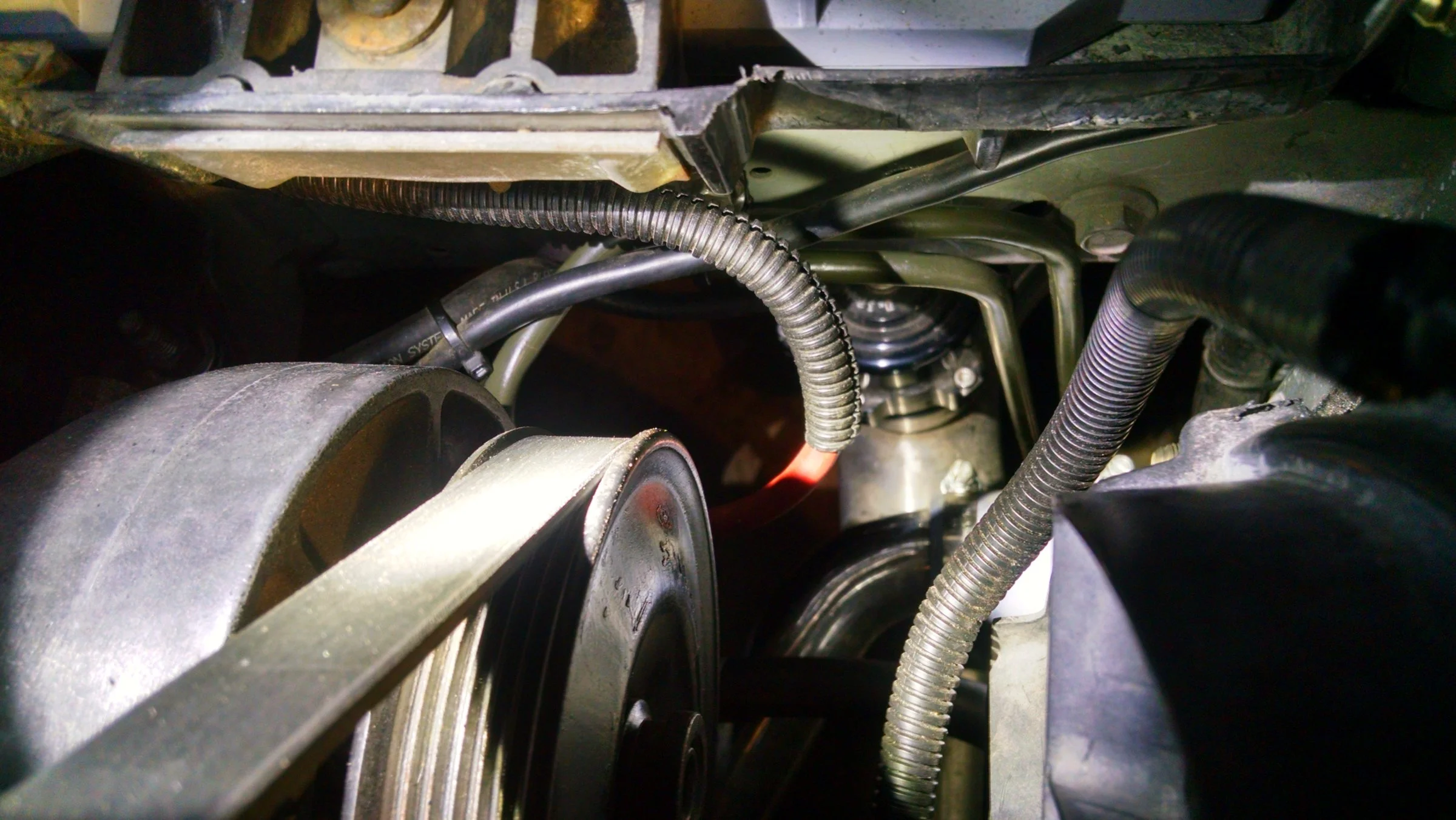

The hard power steering return lines went in tonight. Everything went well...no hiccups yet.
I did notice a little bowling ball affect going on with the fluid I drained out. Ford calls for dexron III....but that's been replaced with dexron VI. In over 15 years I've never had a problem out of this pump. Its always been super quiet and always changed the fluid regularly. This new fluid seems thinner than dexron III. The parts stores here no longer carry it at all.
I'm going to try a touch of Lucas transmission treatment in it to thicken it up a tad. I don't want to have to buy a chinee junk pump. :nono:

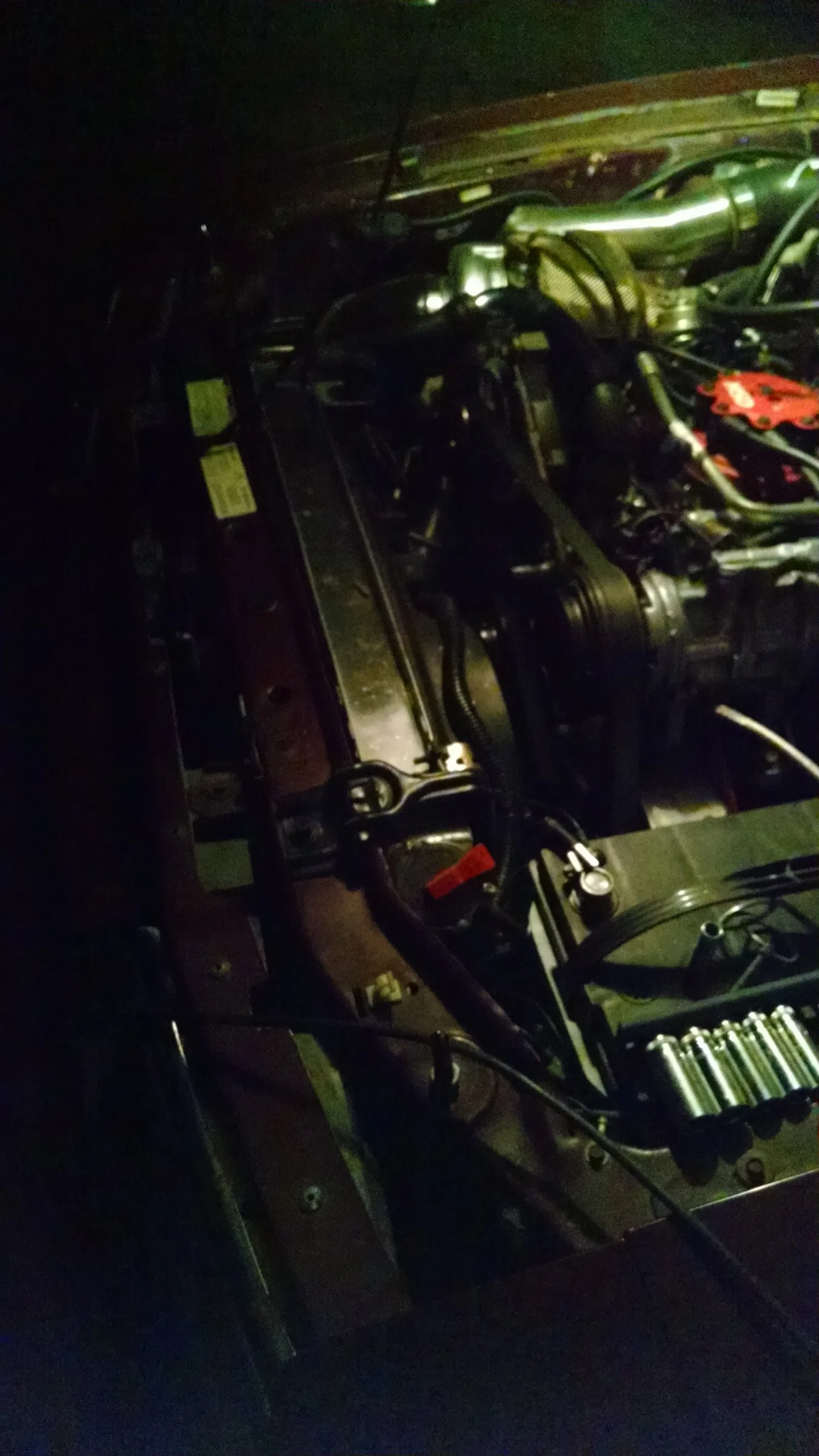

These are the best pics I could get.... My pager camera kinda sucks...
I've really got to tidy up some stuff below that battery tray.:thinking:
