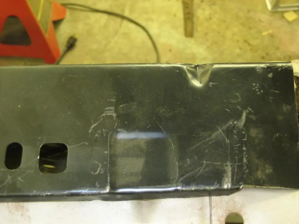

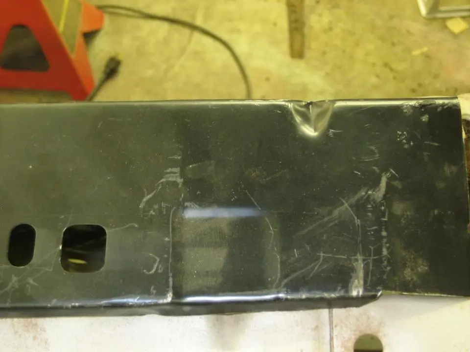

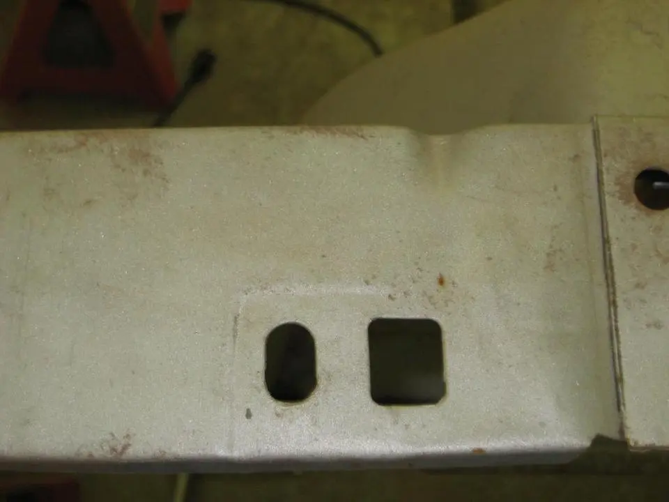

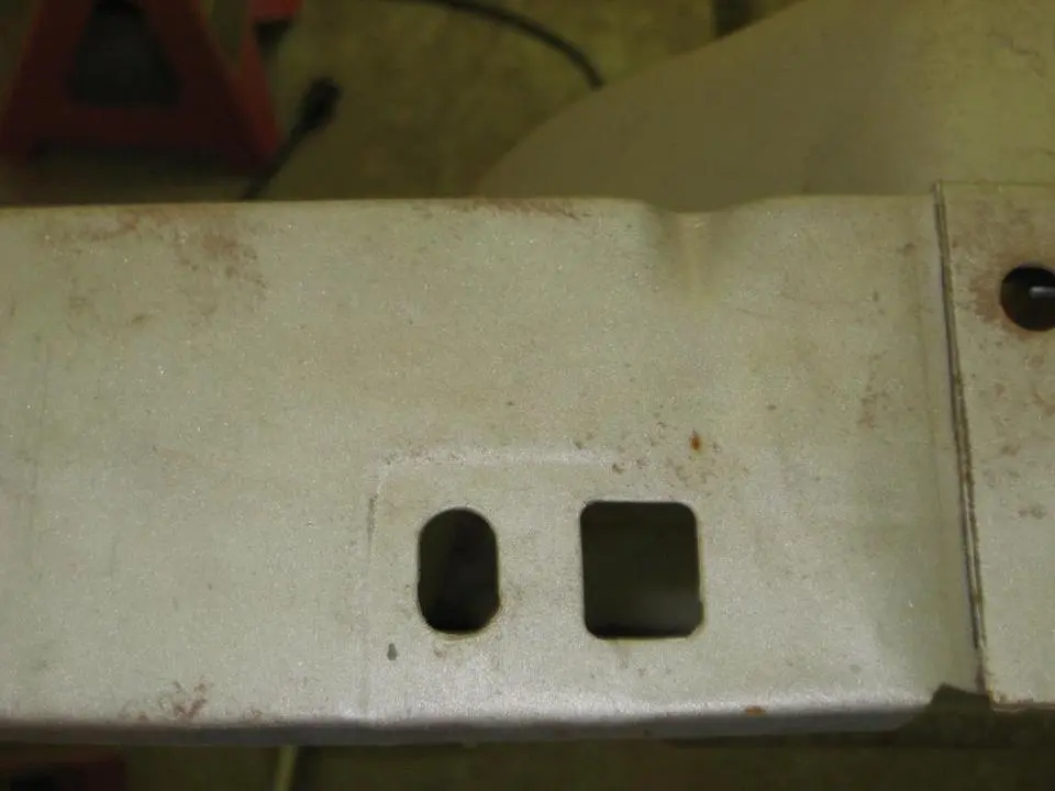

well i went over there and took some pictures.
It looks like the stamping is correct, but the holes are just in the wrong spots. the tag on the new piece says it's for 64-66. I think I just got a bad one.

I was told that it was when I bought it, but after looking at the part number and searching around the net, I think it's someone else's. The part number on it is M116L. I bought it from a local place a few months ago. It doesn't appear that dynacorn sells the individual fender aprons for the '64-'66 cars, they only seem to have the front and rears welded together. I may go that route, but I hate to spend money on the rears if I don't really need them since mine are fine.
i wish dynacorn had the front and rear panels seperate the quality is a lot better.
it will probably be worth the extra cost of the dynacorn panel anyway.the cheap aftermarket panels just are not worth it .some dont even have the holes at all. the dynacorn panels are a much beter fit and stamping,and even a heavier guage.
